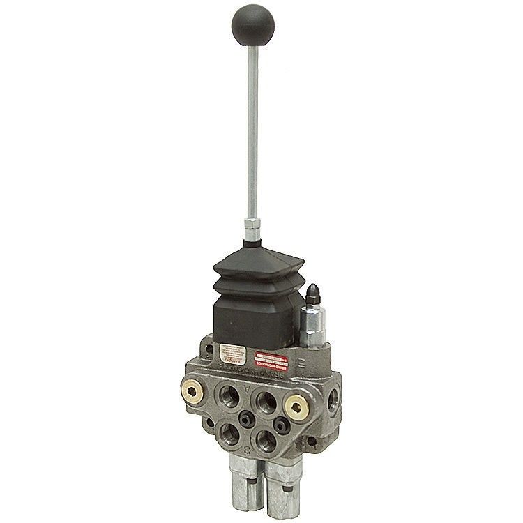

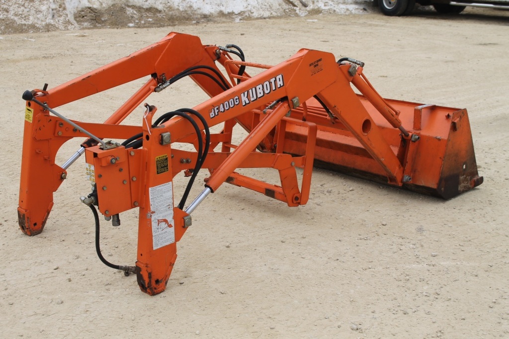

I'm new to loaders, so bear with me on the terminology. What I would call, and please let me know the correct name, the FEL control valve/handle is bolted to the FEL framework. When I dismount the FEL, this will stay on the loader. There are 2 quick connects at the pump, press and return I assume and a smaller quick connect up near the valve/handle. To leave the valve/handle on the tractor, I'd need quick connects on the 4 hoses feeding the FEL cylinders instead. Then I could use them to feed my plow cylinders.

Is this what you have?
Picture from Google Image Search
   / Adapting truck snow plow to L2250
#13
exactly

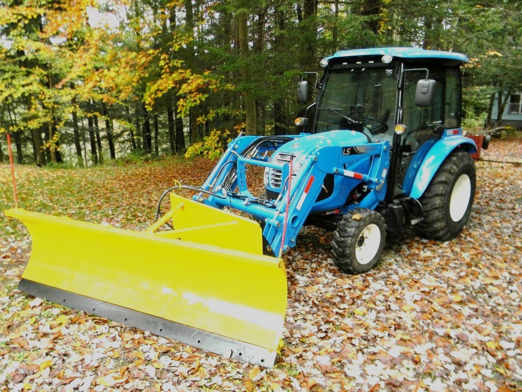

Good point, it used to stress the charging system on my truck. I plan to put ssqa on my loader. Would it pay to put a ssqa on my plow? I was figuring on putting the plow bracket on the tractor and removing the loader when using the plow. Is pushing snow too much stress on the loader arms? I see a lot of guys on here doing it, does it work as well as a frame mounted plow bracket? If I did the ssqa on the plow, I could just put quick connects on the dump cylinders of the loader and use those hoses for my plow turn cylinders. Thoughts?
   / Adapting truck snow plow to L2250 #18
I have a truck plow I adapted to SSQA. I lift with the loader arms and angle with rear remotes. With a light tractor and the blade angled the tractor will get pushed around by heavy snow. There are a lot of posts on here with many plow to tractor conversions including mine. Do a google search at the top of the page or check similar posts at the bottom of the page. Yes, you can use the dump / curl ports to angle the plow.

I've been reading quite a few... there are some great designs. Thanks for your input.
