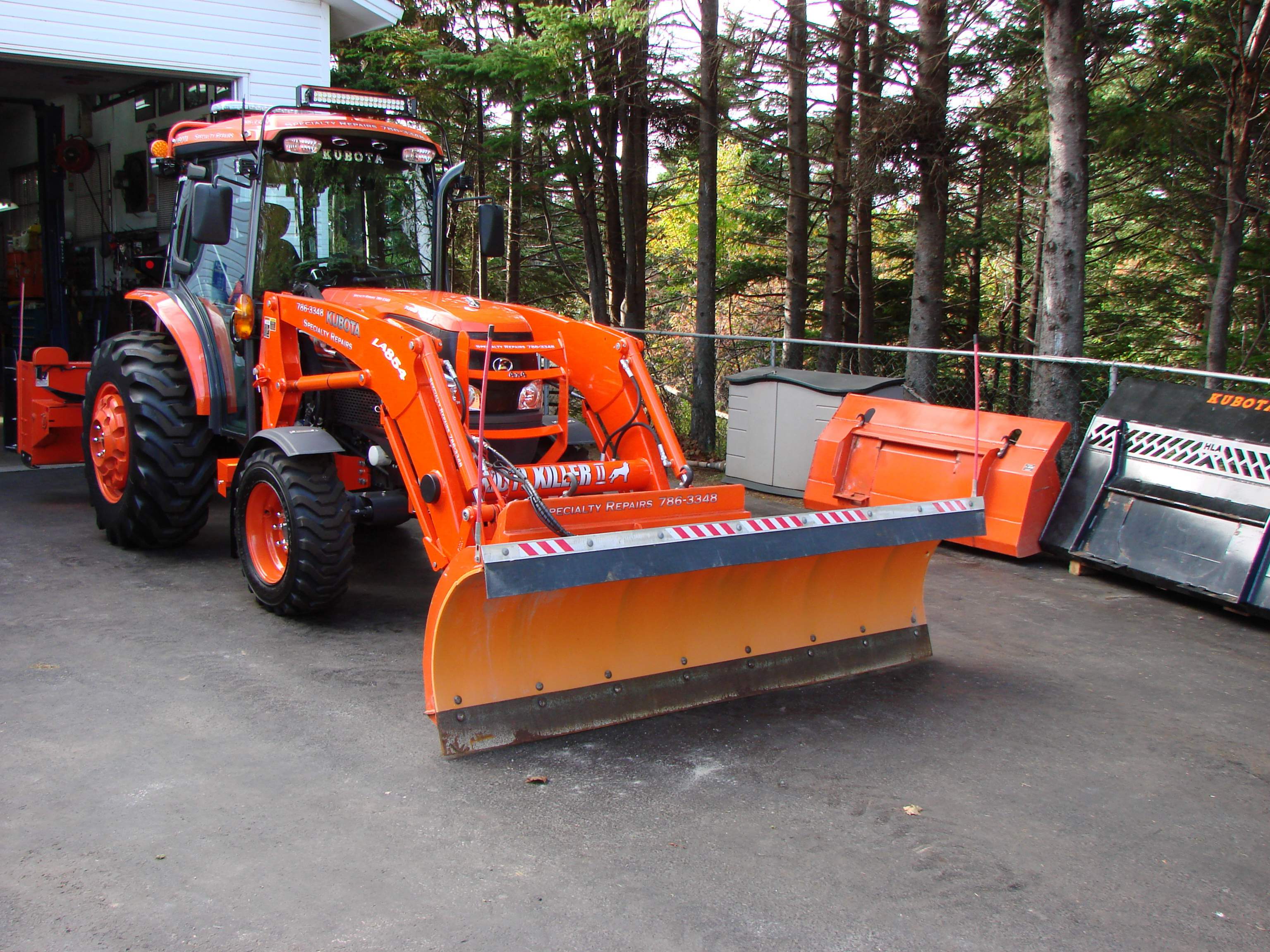

I know this has been done before. I've found a lot of inspiration from others, especially 4shorts thread.
I really like how he's moved the A-frame back to bring the plow closer to the tractor. That would keep the weight from hanging out so far and make the thing more maneuverable when turning the beast. The thing that I don't like is the fact that the A-frame is welded directly to the QA plate preventing the plow from truly floating. I know you can put the FEL in float but that still puts a fair amount of down pressure on the loader frame which would likely bury the plow in a soft dirt driveway.
So I think I've come up with a solution that might just be the best of both worlds. Fab a QA mount that accepts the pivoting A-frame 16" to 18" back behind the plate.
-It would move the plow back to realize the benefits stated above
-It would allow the plow to float just as it would on a pickup
-If you wanted some down pressure you could just curl the QA plate down to bottom out the A-frame on the mount then put the FEL in float
Something like this:
The orange cross tube represents where the torque tube is located on the loader frame. It is really the only thing that I need to work around.
The pins are dropped down 2" from the mount and this allows the plow to swing 5 degrees upward, or 3-1/2"
It would certainly be able to swing down a lot more with the slack in the lift chain.

I have full float, it's part of the tractors FEL,s system. I guess I'm used to operating heavy equipment that operates this same way. Ive been using my design since 2008 and it's worked flawlessly. I'm not a fan of hanging plows from chains. I like to take advantage of the down pressure even on gravel. It lets me control what I need to do. I did make two small changes to mine over the years. One was a rebound shock for the blade when it trips. Before if the blade tripped it would recoil very fast flicking snow on the hood. Now with the shock it comes back nice and slow. I also added rear skid shoes on the back portion control of the A frame so I never had any worries about the FEL arms digging into the ground. I'm 100% happy with the design. When I did this back in 2008 no one was moving the blade close to their FEL's. I'm glad I did and I'd do it the exact same way if I had to do it again.

I have had a plow in the past that floated by hanging from a chain and have one now that just uses float in the valve. I like the float in the valve, It is just easier to do things with. My question is, You are moving the blade back so it will not put to much weight out in front of your loader, but by the time you add all of that steel are you going to come out ahead? Your question is 2" enough float I would say no. I would go much more, more like 8" . Even if your place is very flat the neighbor you try to help might have a dip or two and you would be surprised how much it will move up and down. Two inches only gives you one inch up and one inch down. 8 in is not as much as you might need. Ed

I tried making the exact mounting system that you drew up and I did not have enough float with 4" of drop in the mount and the almost 2" of drop from the plow "ears" being bent upwards.
I think I am in the minority but I'm not a fan of the plows mounted on the loader. If its not a pusher or a sub-frame attached plow I'd rather go without. I used a sub-frame mounted plow on two different kubota tractors that worked flawlessly. I figured why not try and throw a plow on the much bigger JD (that also has a heated cab!) and I was frustrated from the beginning.

Remember to build in some forward tilt of your q/a plate. I prefer to (in most situations) only use the bucket curl to pick up the blade. Your particular tractor might be fine with the plate vertical as you have shown, but all SS's will need this to get enough curl back.
