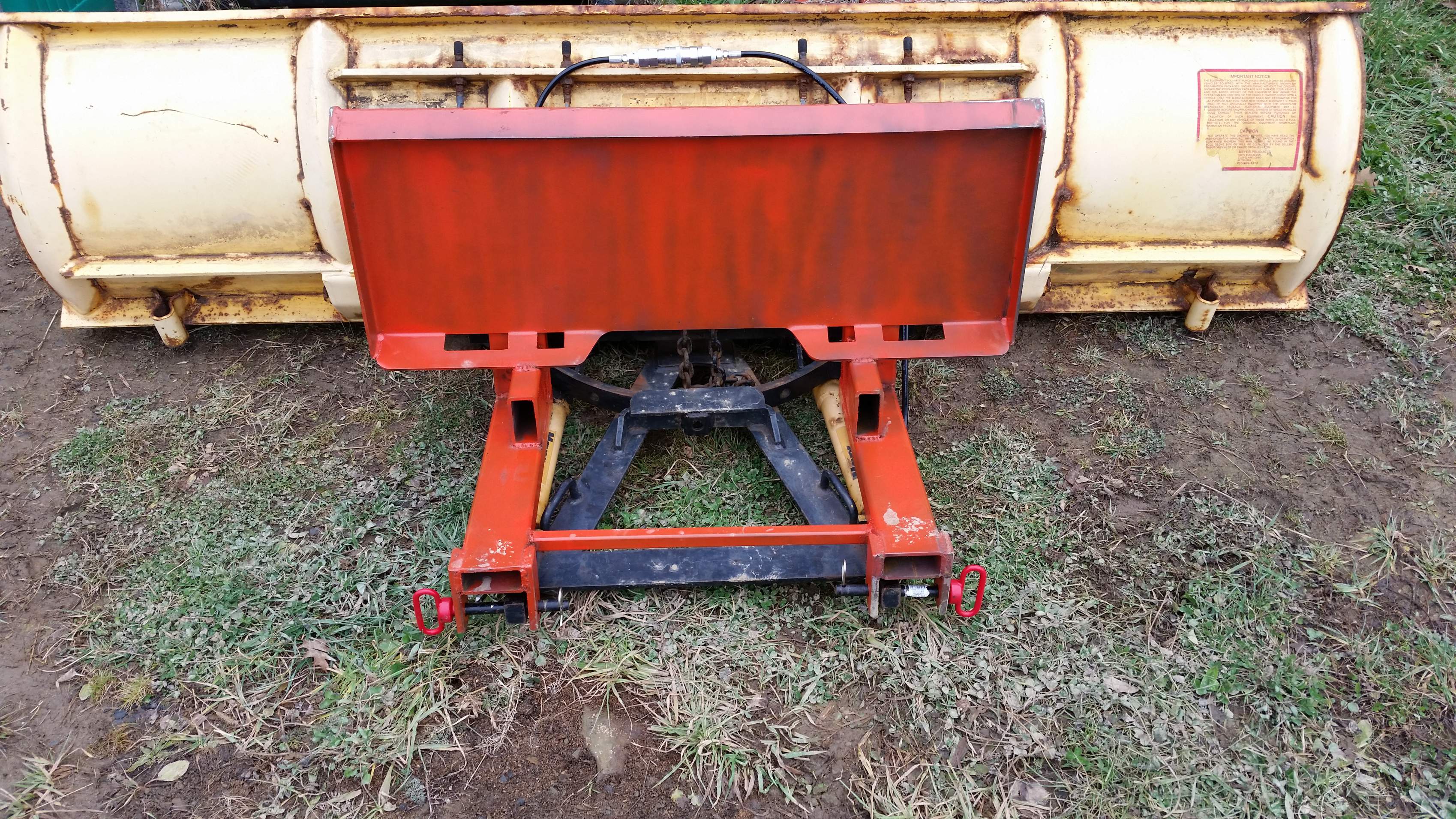

I just got a chance to go through these. The first one is exactly what I was looking to do and the second is pretty much like 4shorts design.
Although I had to do some digging to get the correct link on that first one. Apparently the forum does some funny business when a user links to the competition. I hate it when forums do stuff like that! For anyone else, you need to go to Green Tractor Talk .com or Google and look up "Meyer Snow Plow mounted to 300CX"
Found Foggy's post over here on TBN, They probably wont have an issue linking to this :rolleyes:
http://www.tractorbynet.com/forums/...eyer-plow-mating-jd-300cx.html?highlight=plow
I have the plow in the garage and I'm starting to tear it apart for some paint. Not sure if I will wire wheel it or borrow a sand blaster. Right now I'm leaning towards using POR-15 paint. POR-15 Metal Prep, then Rust Preventative Coating in silver to fill all of the pock marks, then a top coat of safety orange.

Found my first attempt at mounting the snow plow on the loader. I hated it and constantly was fighting the set up. We'll see how the snow pusher works this year.
