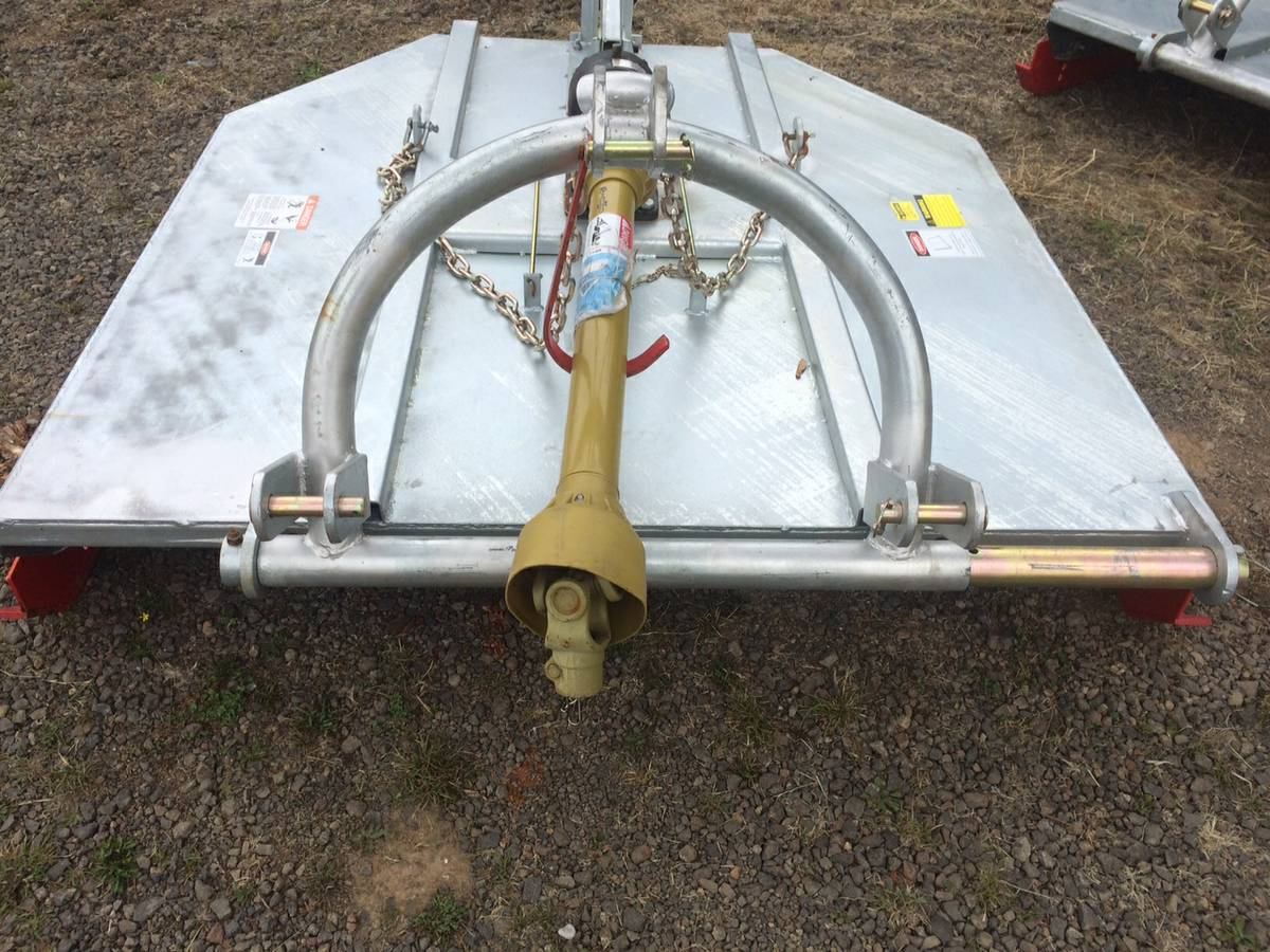

This is what I have done to my mower... I'm not sure if it will work for you... Maybe it will give you some ideas as to what could be done.. The reason for my offset was to have the mower cut outside the right rear tire to get closer to sprinklers and fences etc... Keep in mind the PTO shaft when doing the modification.... Notice the original pins are still useable... something you might consider, if possible..
Dave
I'm curious. What is the angle iron is that is bolted to the side of your mower?

Sorry for the late reply... I have a few rocks that come up with the freeze / thaw cycle... they were beating the krap out of the mower housing... Sooooo, I cut out the side of the mower and bolted a chunk of 1/2" thick belting to cover the cut-out... Also, once the rocks were hit by the blade, they would bang around, under the mower deck and wreak havoc.... The hunk of belting really slows the rocks down a lot... and they can even escape if they are lucky ... LOL...

IF you take Dave's picture and unbolt the gearbox, and turn it just a little bit, say maybe 1/8 of a turn, and re-drill the holes in the deck, that would lessen the strain on at least one of the u-joints.

I wouldn't do that. You want the input and the outputs of the shaft to be parallel, otherwise there will be "accelerations" between the input and output. Think of this: As you pass through a u-joint with an angle in it, the output will not be spinning at an even speed. It will constantly be accelerating and decelerating. If you have two u-joints, they can cancel each other. So, if the gear box and the PTO are parallel, the shaft may have accelerations, but the mower will not.

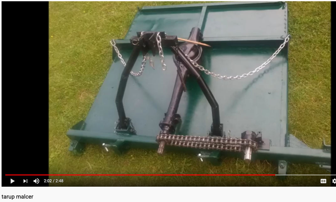

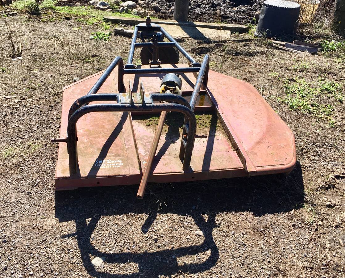

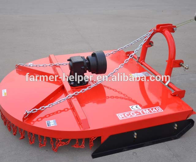

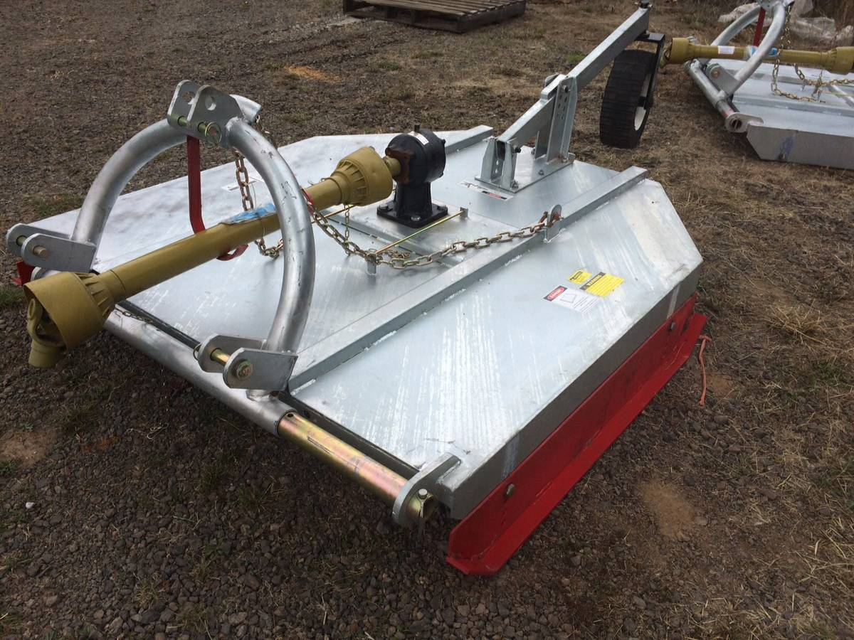

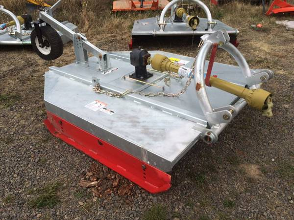

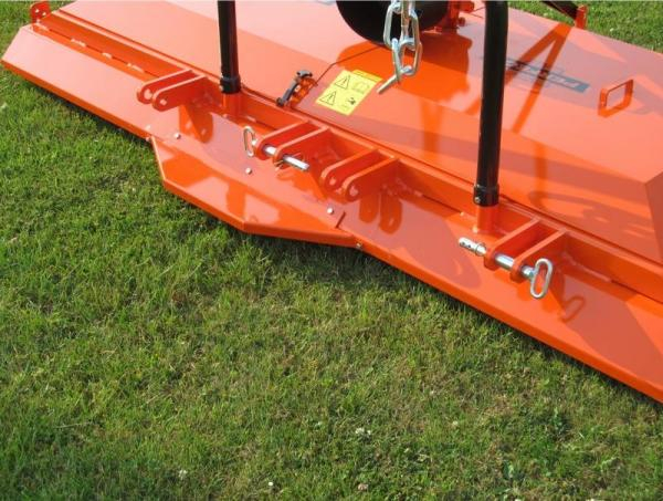

Some photos I collected from the internet when I was thinking about offsets.
Bruce
offsetmowerhitch1.jpgoffsetmowerhitch2.jpgoffsetmowerhitch3.jpgoffset-slider.jpgoffset-racing-mower.jpgDiY-offset-cutter.pngalternate-offset-3pt-mounts.jpg
