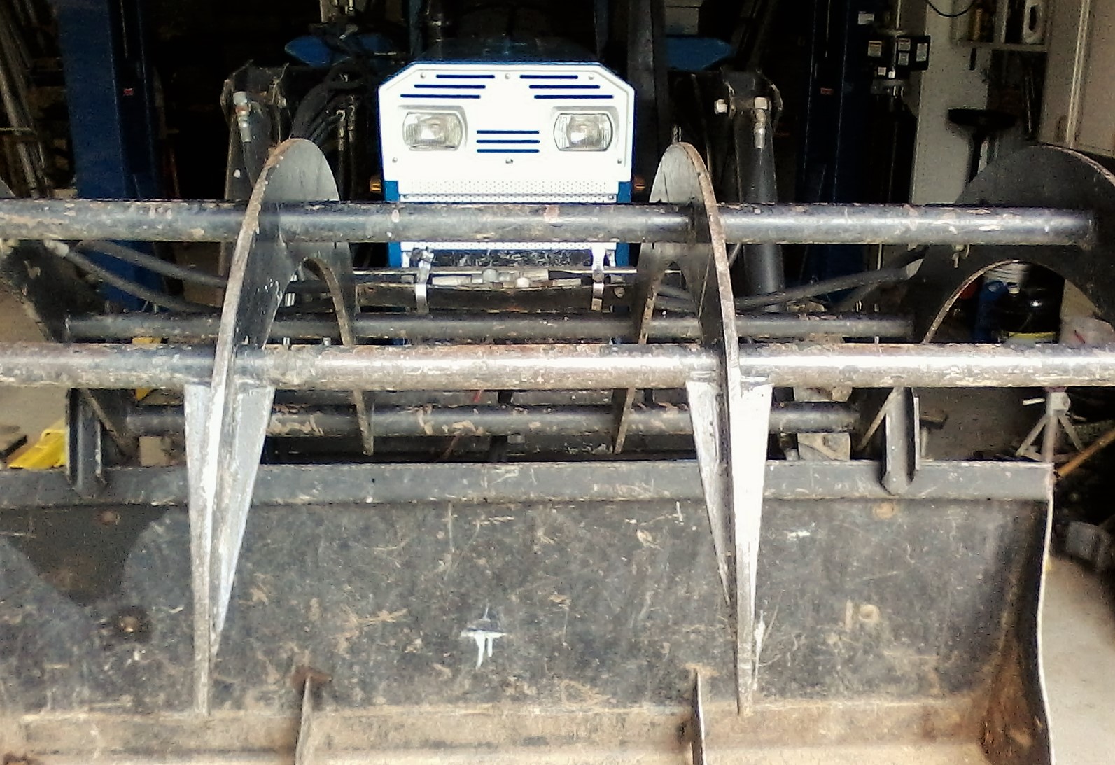

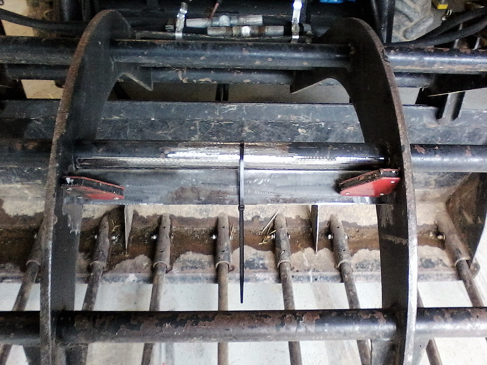

Been wanting to add this for a while, Probably would not do it to a new grapple with a warranty...
But this is an old well used grapple and have many times needed a hook in the middle for small lifting jobs, especially since the open tines make it easy for a chain to slip around or completely off.
I probably should have mig welded this but wanted to try some more practice at stick welding with my inverter welder and just went ahead with stick except for the small tacks.
So here goes

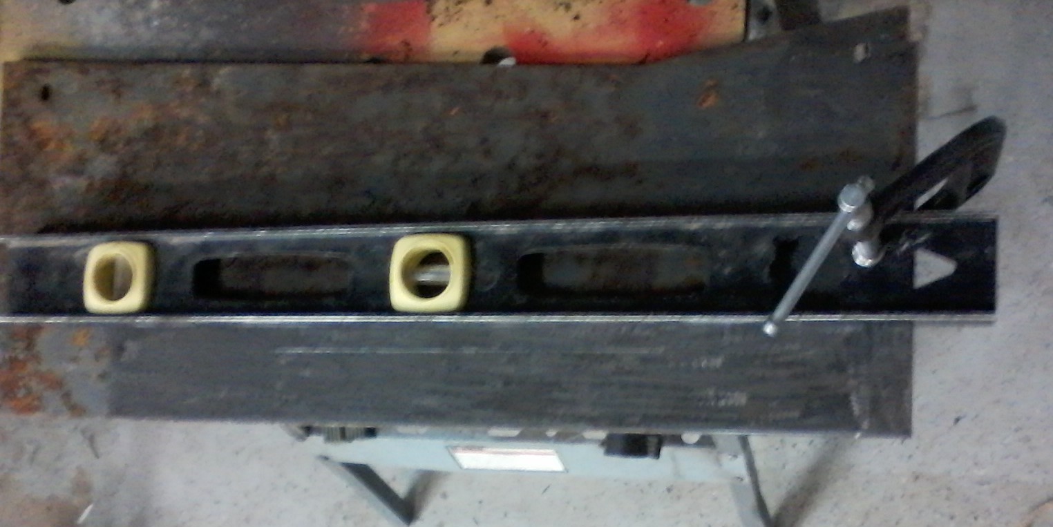

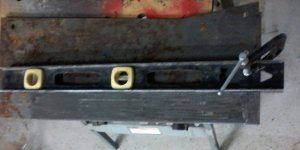

rhino grapple mod.jpg next cutting a support out of some old plate:Rhino grapple mod 2.jpg

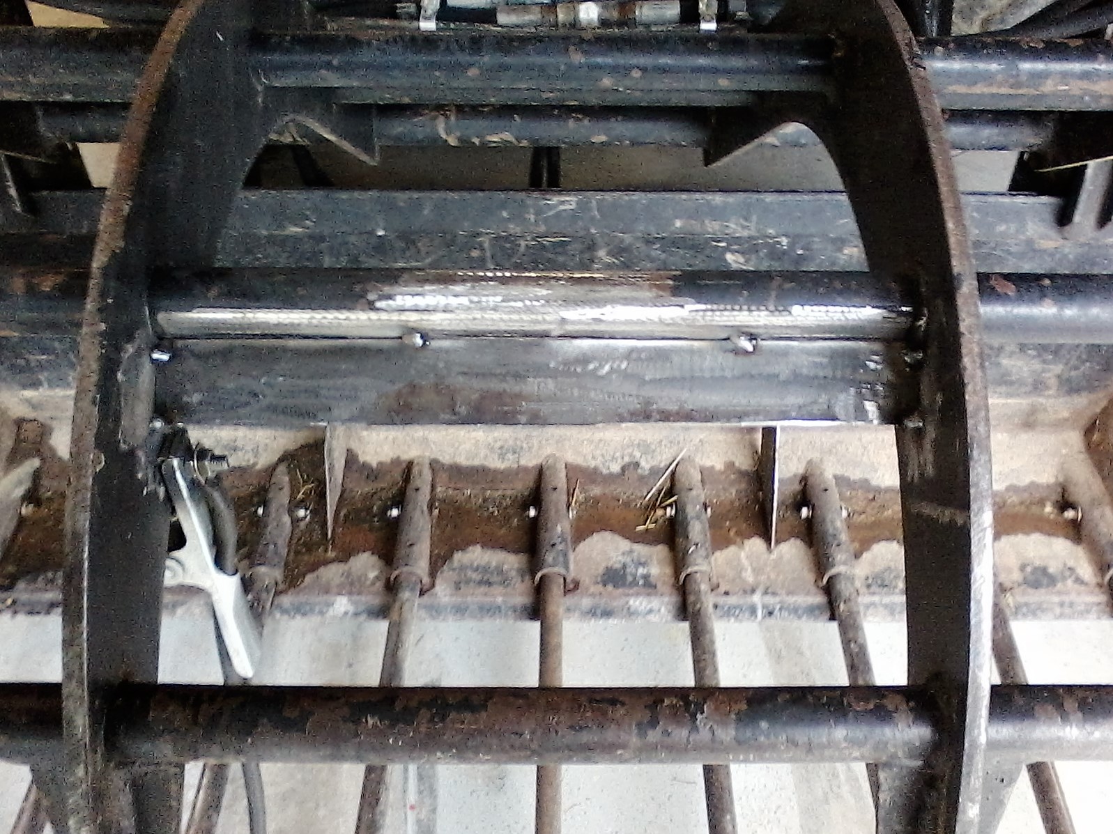

Then fitting the new support:Rhino grapple mod  fitting plate.jpg and tacking:rhino grapple mod tack.jpg

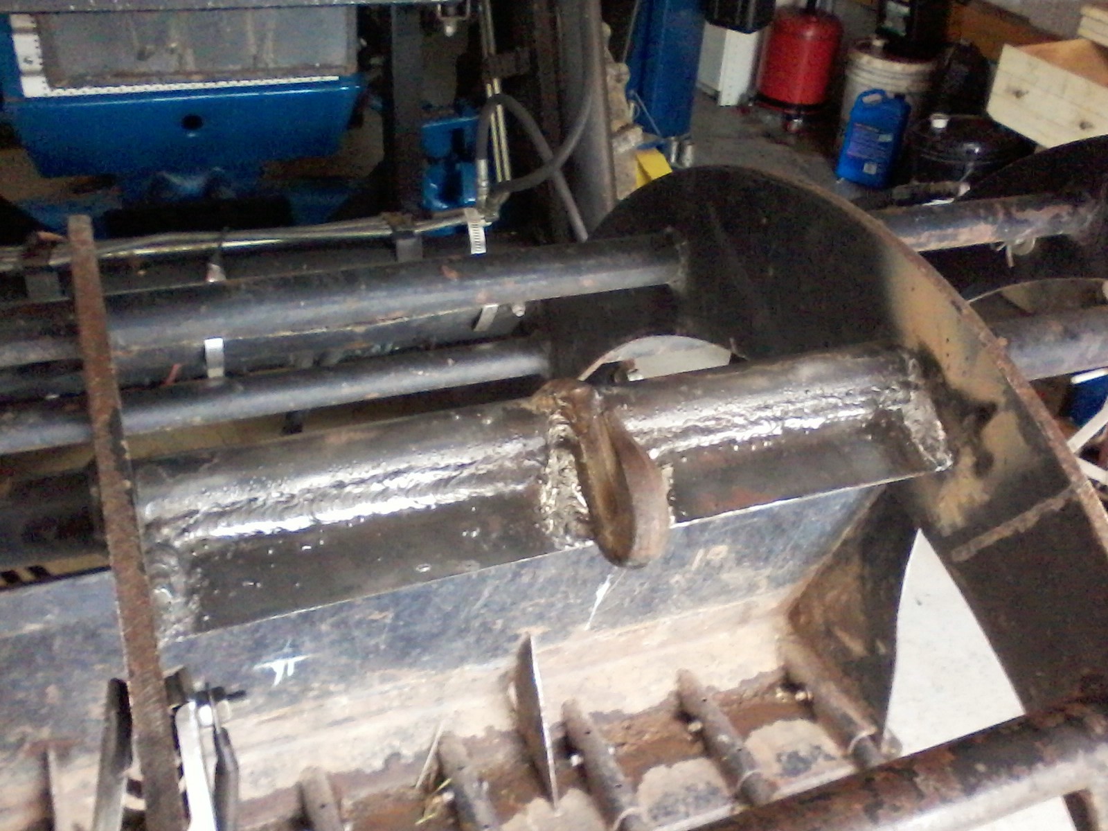

Here's were things went a little wrong, probably should have used a smaller rod like 3/32 instead of 1/8 7018 or just migged it and done a better job of metal prep. Would have helped to just open the grapple all the way prior to the main horizontal weld to keep it in the flat position:duh:
i do need more practice with stick, Rhino grapple mod 8.jpg there was some under cutting on the round bar and lots of splatter.
Will do some clean up grinding and add some black paint to keep rust to a minimum, but the grapple lid does have a chain hook

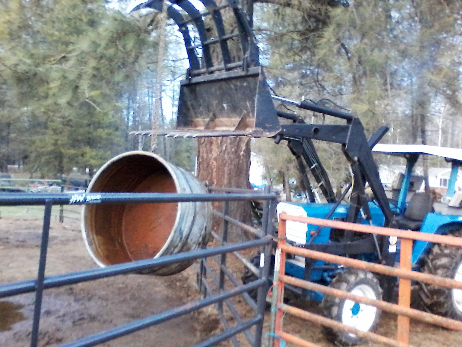

Well i did some fence clearing today- where a tree had taken out a fence and the new hook was basically USELESS...
Broke the chainsaw -:ashamed: special aluminum muffler bolt fell out for the second time,- Love paying Husky $ 4.00 for 1 aluminum special thread bolt...
Headed in and the wife pops in after horse feeding saying the larger tank is empty??
I tell her that's impossible- cuss I just filled it day before yesterday. She says needs filled Now.

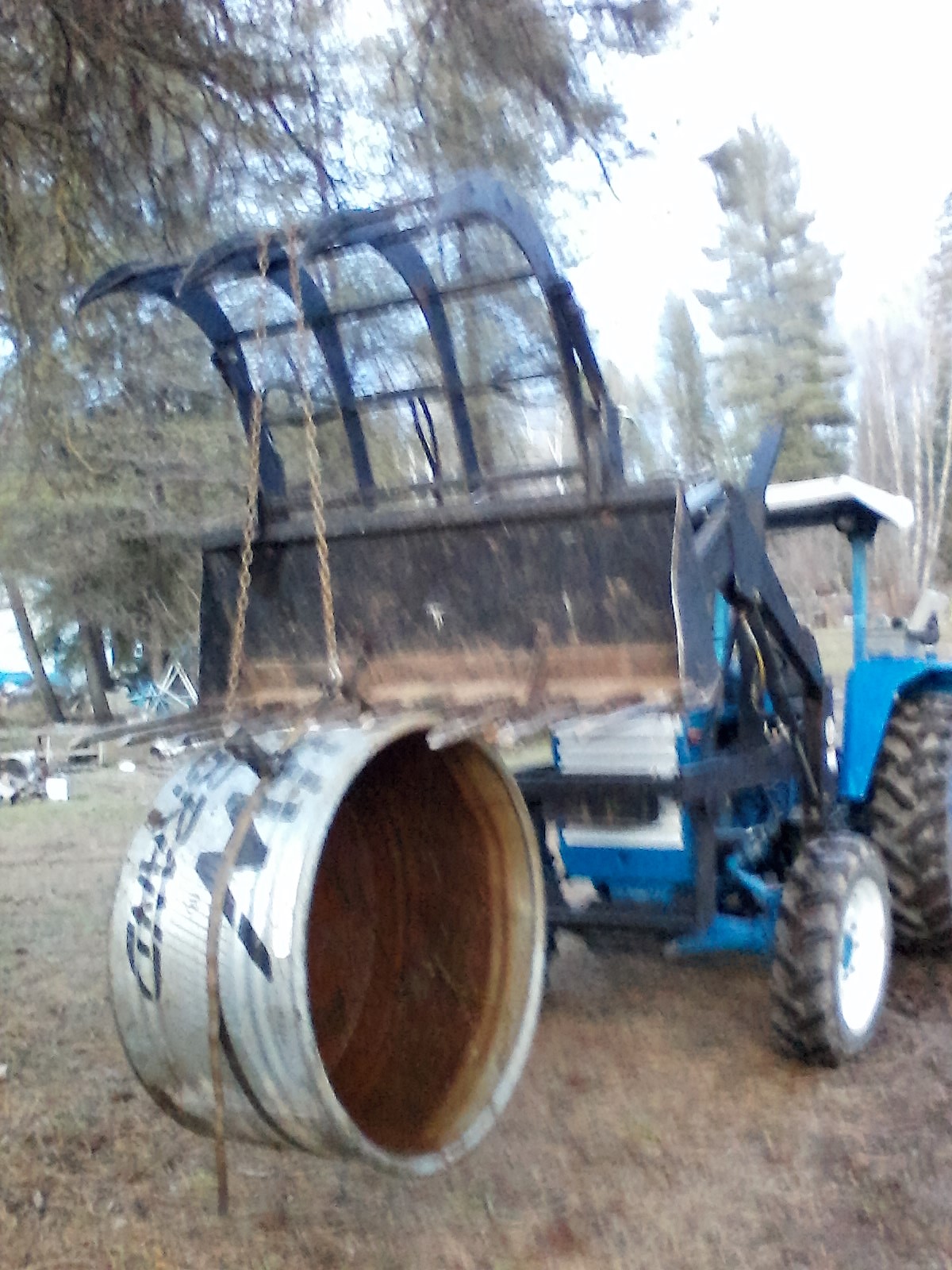

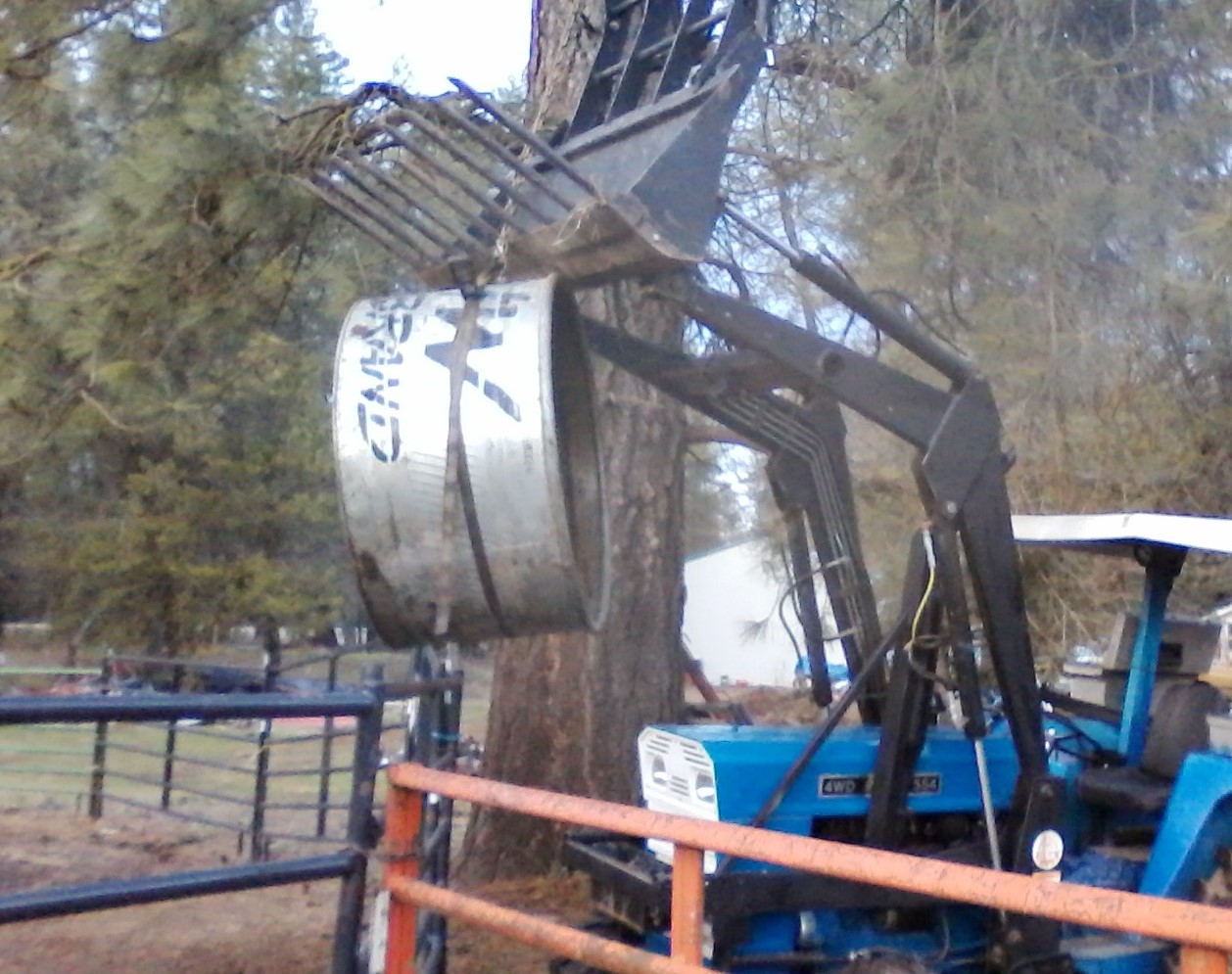

Head over to the barn and sure enough tank is empty, grabbed a smaller spare and put the new hook to use since horses are still in the run outs. Set small non leaker tank down leaky tank ready for lift (2).jpg

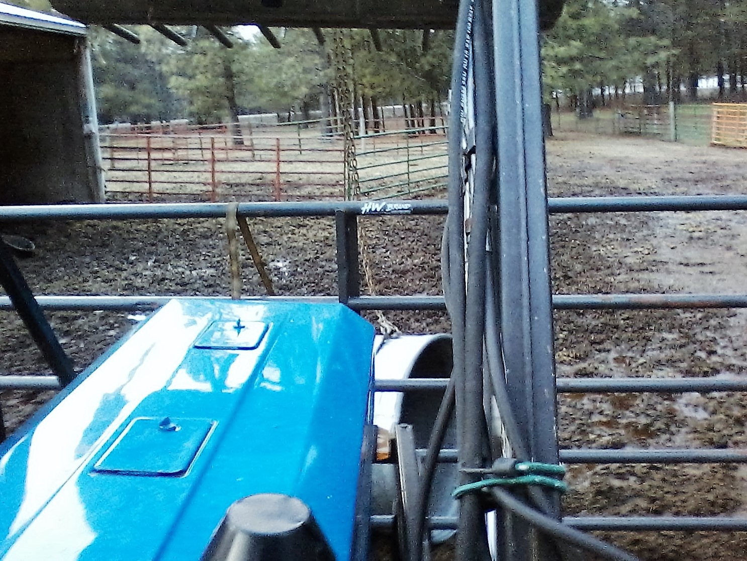

Hook up chain and open grapple lifting leaky tank almost to bottom of tines leaky tank.jpg

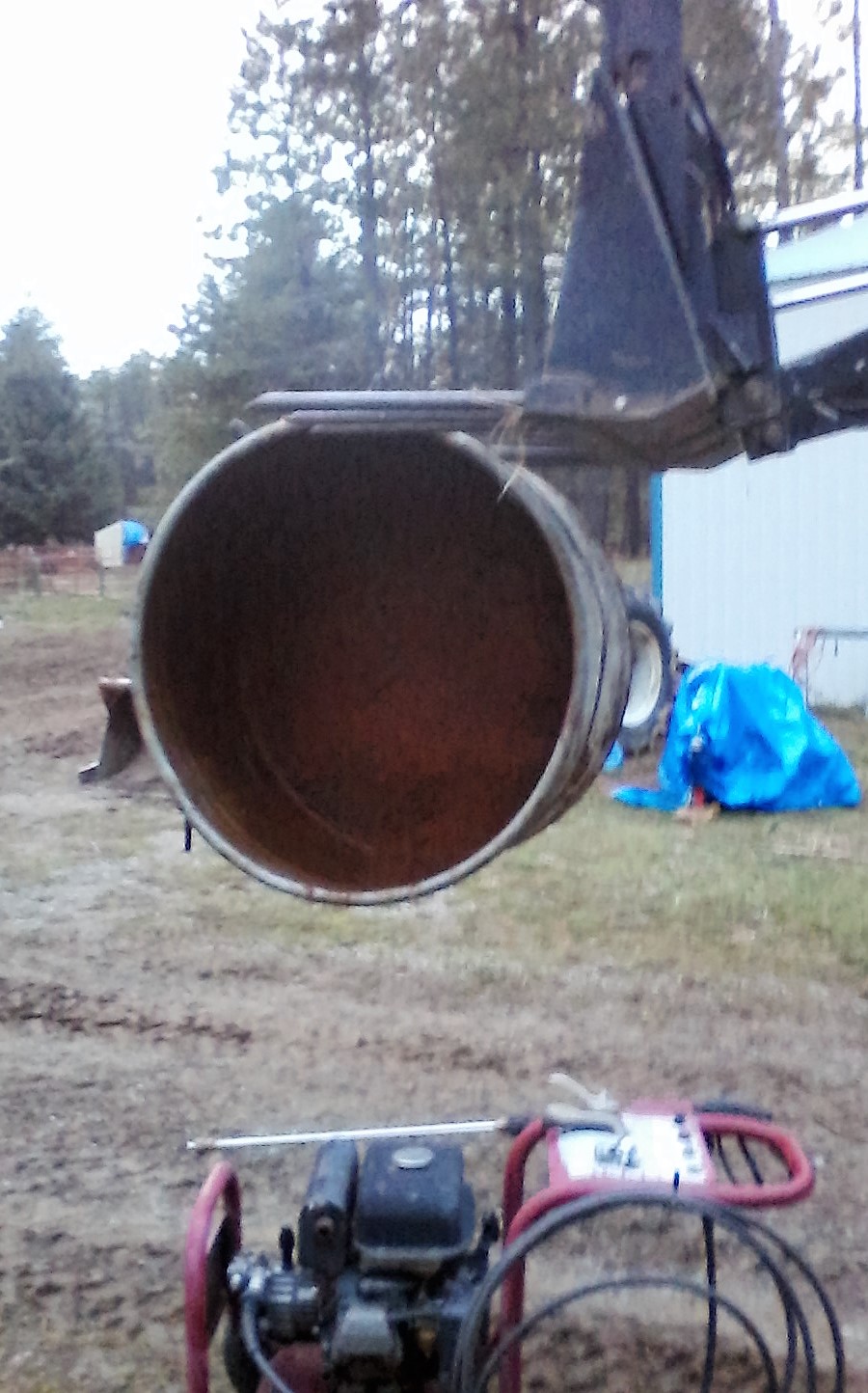

Lower the boom and then reset chain and open the grapple up to where it holds the tank stationary against the tines.
Over to the pressure washer to blast the tank- and find the leak.
Didn't have to move the horses, and other than filling my shoes with horse s--- the new chain hook came in handy for a leaky tank
