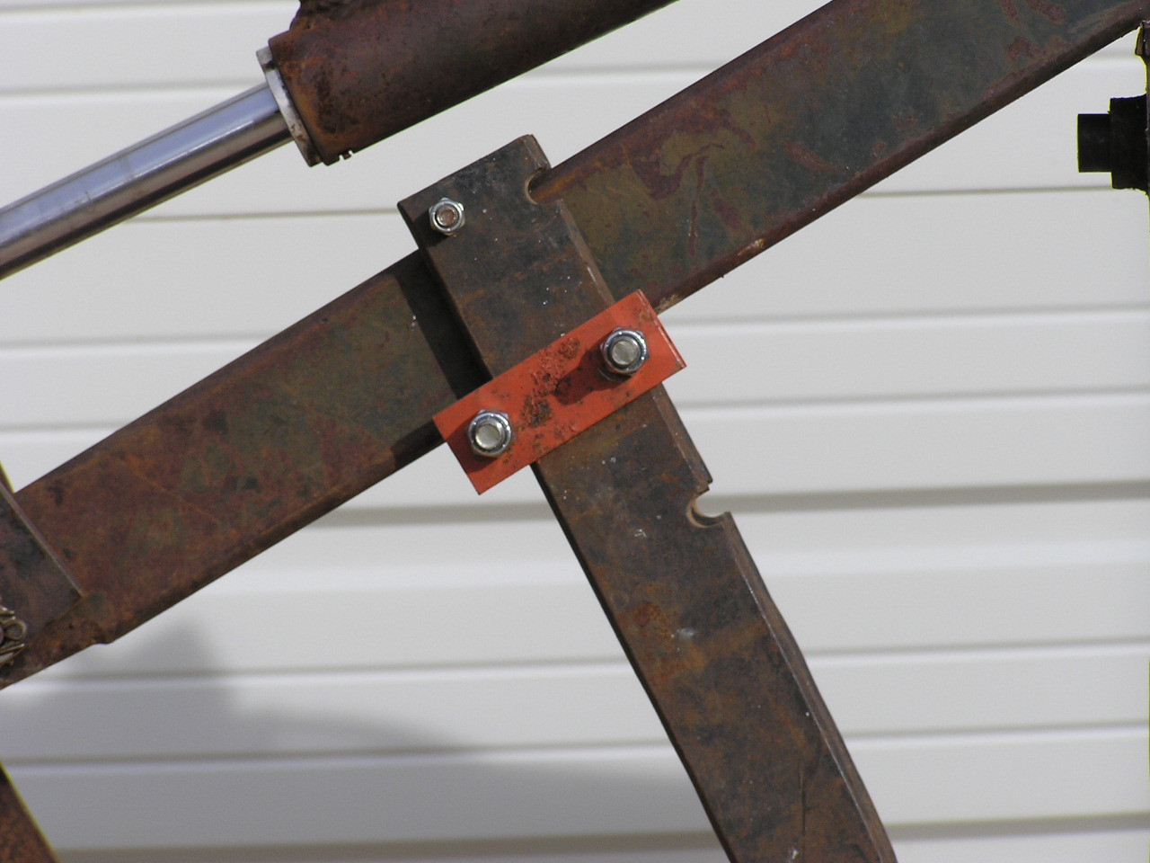

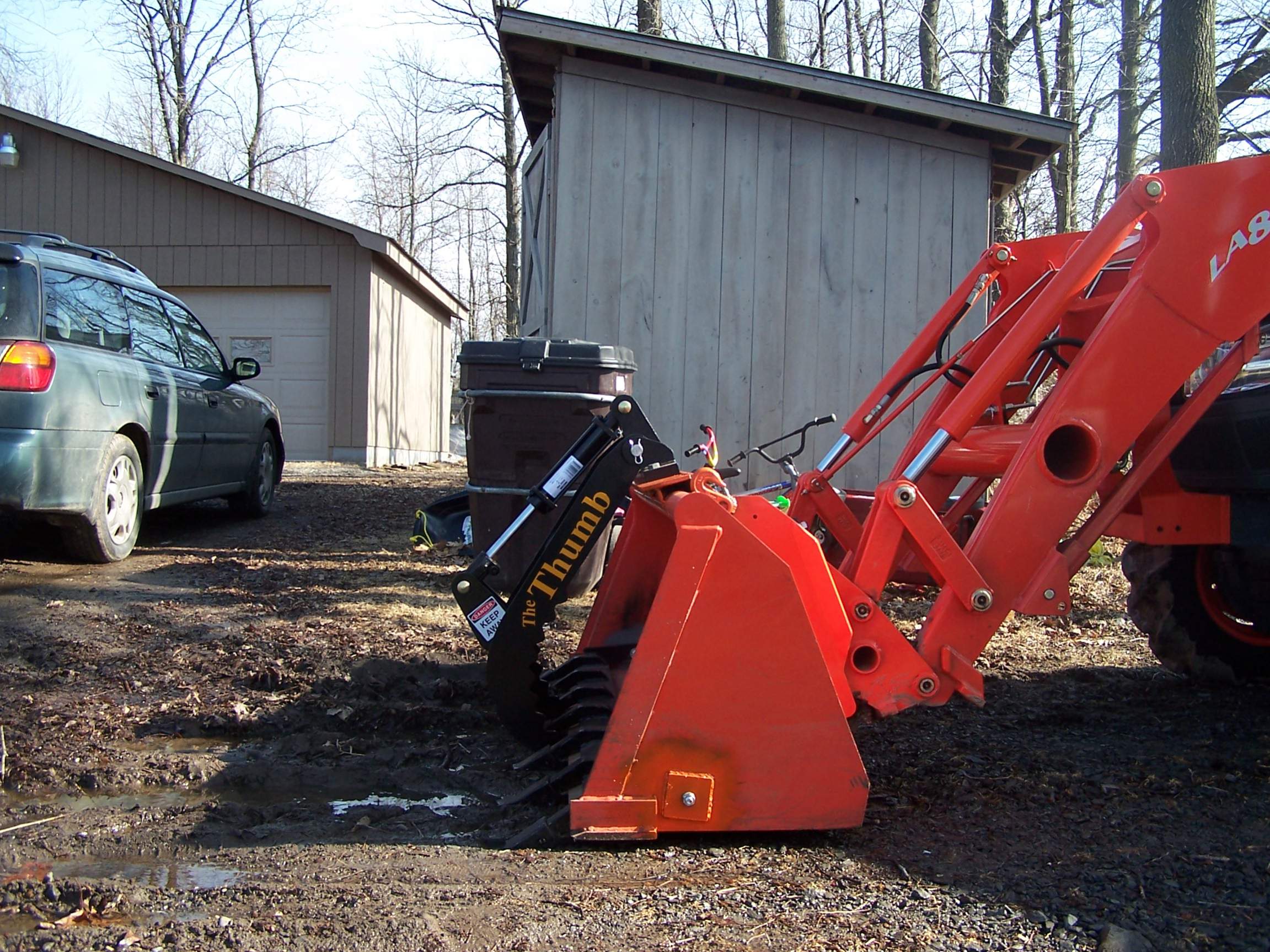

I added a Green's Machine Thumb and tooth-bar;works well for me.Doesn't open as much as a full grapple but very useful and less expensive.The Thumb is easily removed by four bolts.Most expensive part was the third function.
Adding a grill guard is also advised.

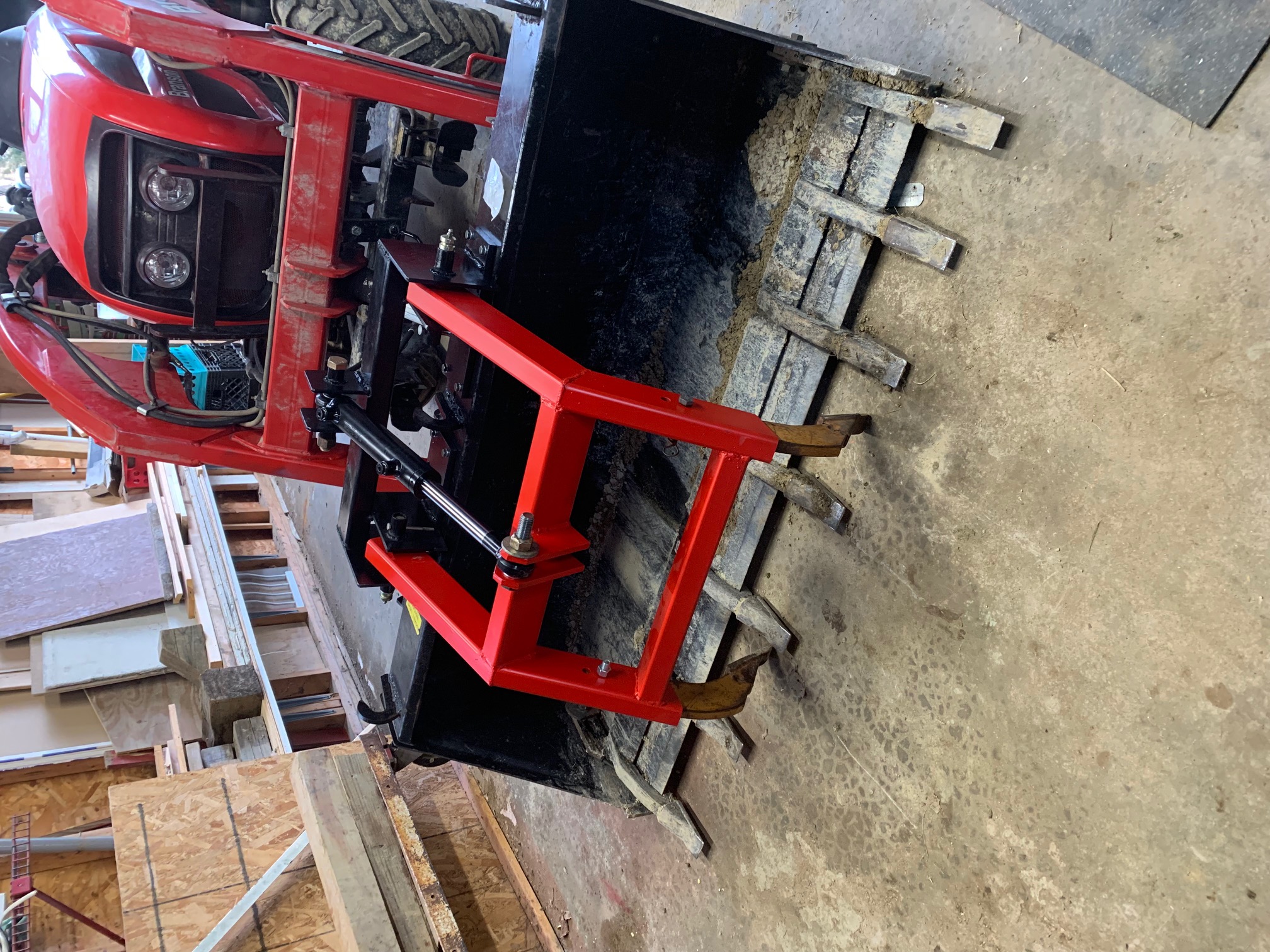

on my 2400H I built my own thumb style grapple for approx $350 in parts. Tines are ripper teeth from by box blade. Cylinder is 1 1/2 bore by 6 inch stroke I had the diverter (not shown)so this is not included in that price.
