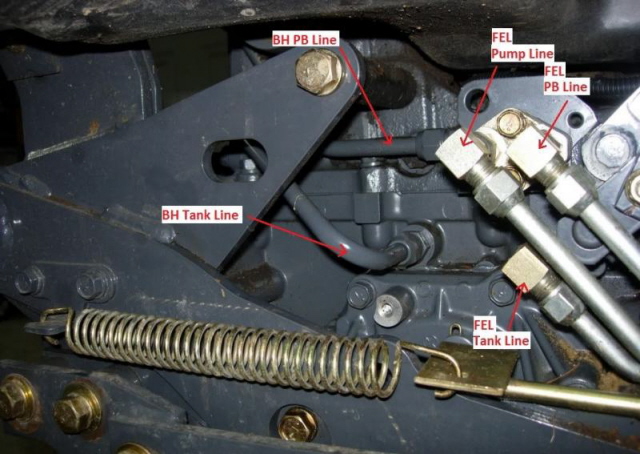

372055d1398312338-add-hydraulic-top-link-ds_zps856daed2a-jpg.jpg This is exactly what I have. Without the lines Thanks for the pic. Leejohn.

How about T off the back hoe lines like Leejohn suggested and use a closed center valve? I just don't want to starve something for fluid or blow my tractor in half.
   / Add A hydraulic top link. #13
Why would you use a closed center valve on an open center hyd system?
Just get an open center valve with as many spools as you need and connect it as shown.
If you connect things right, relief valve will protect your hyd.
You also don't tee off line in an open center hyd system.
   / Add A hydraulic top link. #14
The valve you get well have to have the PB fitting, if not you well not have any 3pt. and just maybe the trans. I'm not sure if the pump is the charge psi for the trans. And yes sir no CC valve like JJ said.
Just go by the picture you have and the one I sent and it well work fine.
   / Add A hydraulic top link. #15
Hi Leejohn
I have got the part number for the block but it has 3 ports on the tractor a power , power beyond and return but I only need the power and return I don't know what to do with the pb port.
After you put the PB fitting that line goes to block and the valve well have another out port plug, remove it and that now well be the return.
   / Add A hydraulic top link. #16
Most valves in an open center hyd circuit should have PB, which is power beyond or high pressure carry over.
The hyd blk PB port is used to take the PB flow from the FEL valve and pass the flow downstream.
It must be used as it is the high pressure circuit .
All tank ports should go to tank.

I have found a open center valve with a pb port. So now just hook it up like power to power /pb to pb and tank to tank is this correct
   / Add A hydraulic top link. #19
No,not exactly.
When connecting valves, the pump flow goes into the IN port of the first valve, and then that valve PB will feed the IN port of the next valve and so on.
Each valve should have the PB adapter installed.
