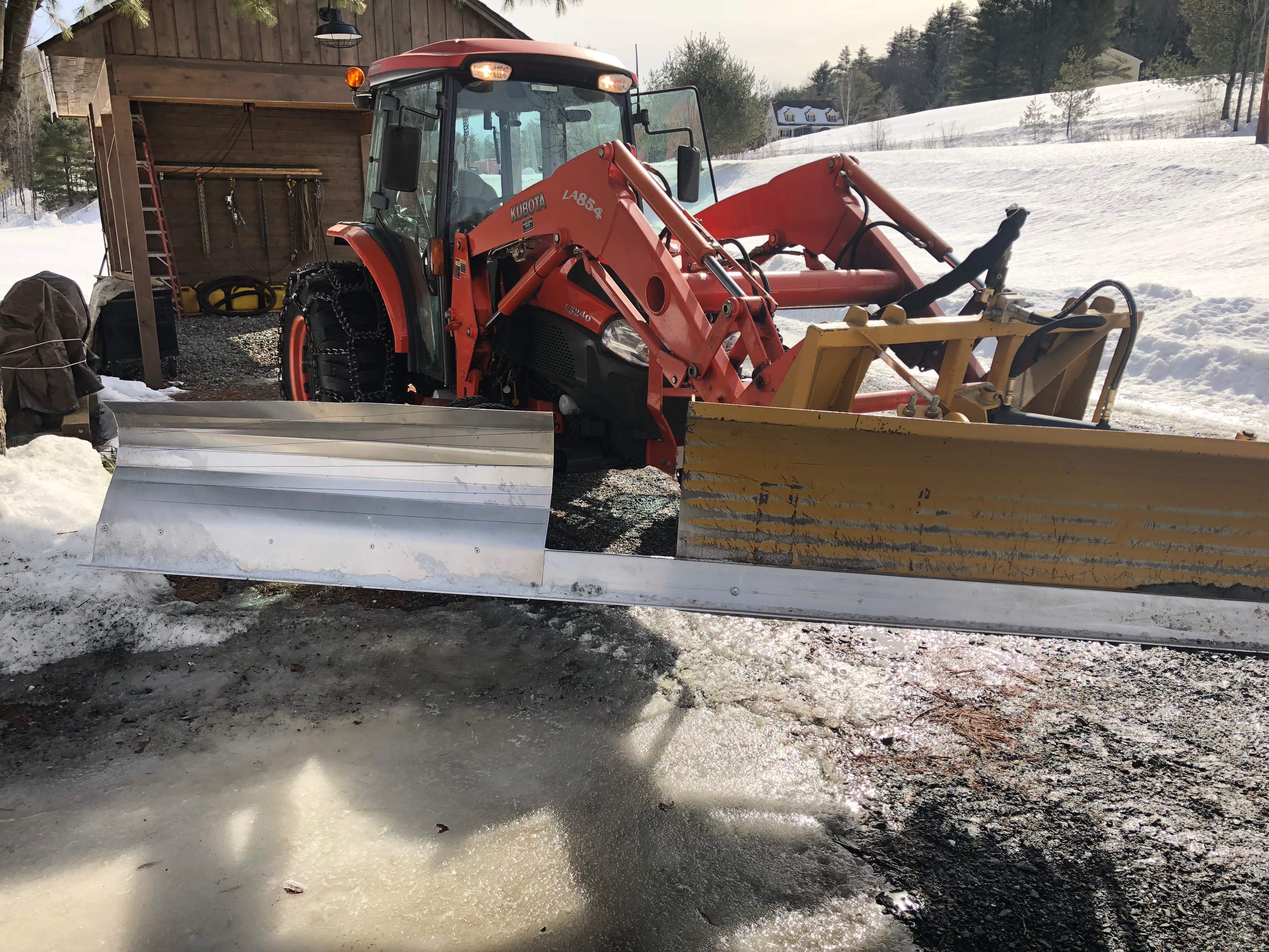

Thanks for the ideas. I'll search "Beenthere". I brought long piece of 5x3x3/8" aluminum angle home from work; will try bolting it on to the lower edge of the plow (using a couple of the plow blade bolt holes. Might end up being a bust, but it's cheap try. Stay tuned.

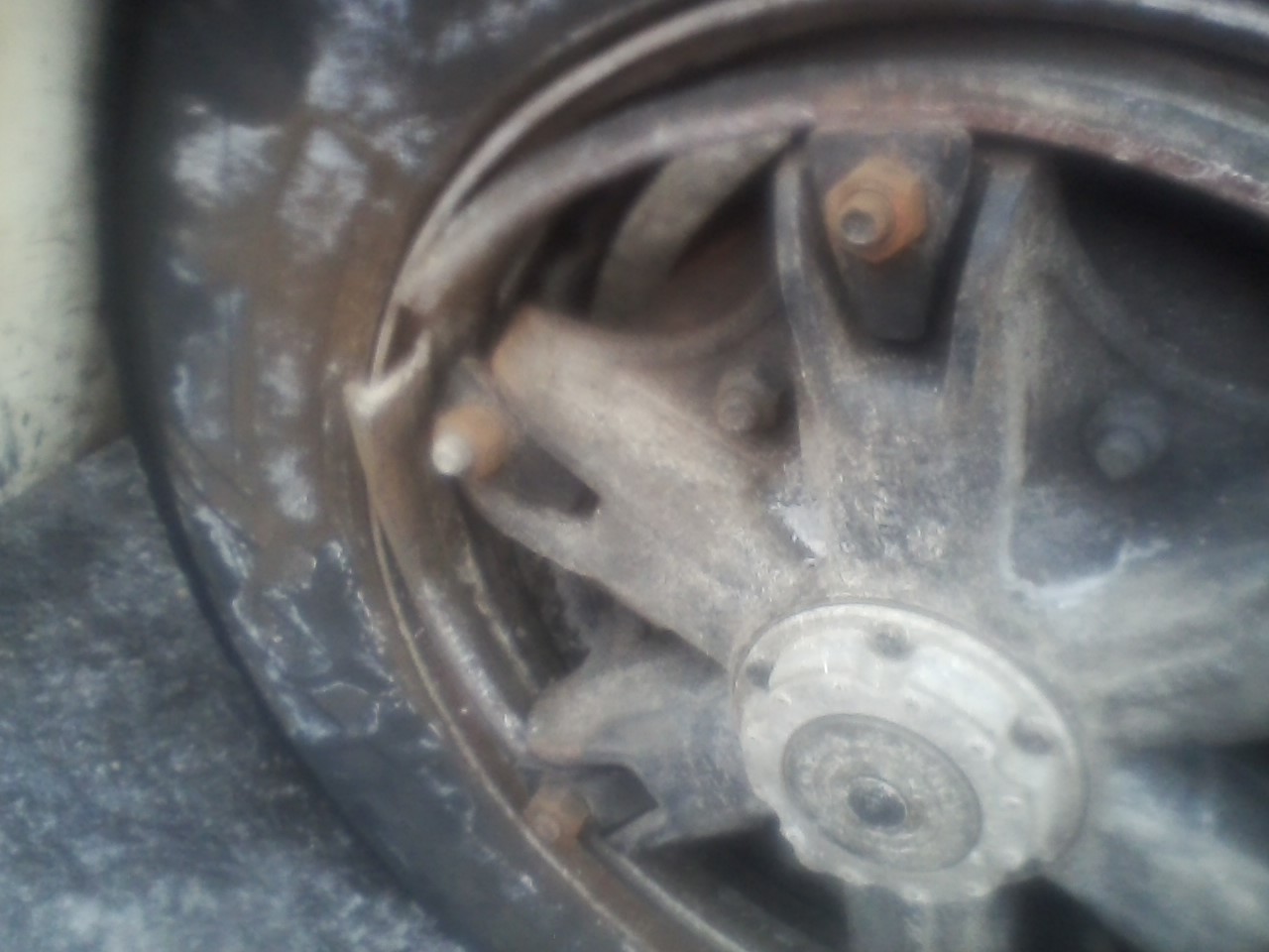

Wing plows put a lot of weight on the front end and after time stuff breaks 0209181611-00.jpg

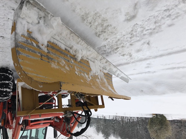

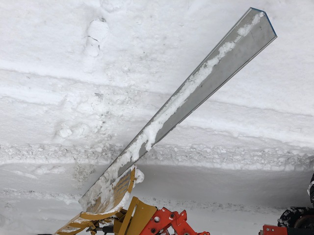

Well, I'm learning a lot. First the good:
It definitely can dig down and break up the banks, making it easier to push them back some with the plow. Typically, after a few storms, with the plow angled, it tends to "trowel" the banks smooth. Then they freeze, so that trying to plow subsequently they just keep you inside like a luge. With my "angle iron wing plow", I can break up the big chunks, loosening the banks.
Now the problems:
My "blade" is not high enough; the snow scootches over the top. My first idea of a half pipe would probably have worked better. But I have a foundation to work with now. I can add a curved blade to the end of the angle, capturing the snow long enough to funnel it away from the road.
Second, My plow pivots at the center (so that it follows the camber in the road. This is a disadvantage when trying to carve the banks, because the end can lift up and the left corner of the plow dips down into the drive. Gotta work on something to keep it from pivoting.
Work in progress.

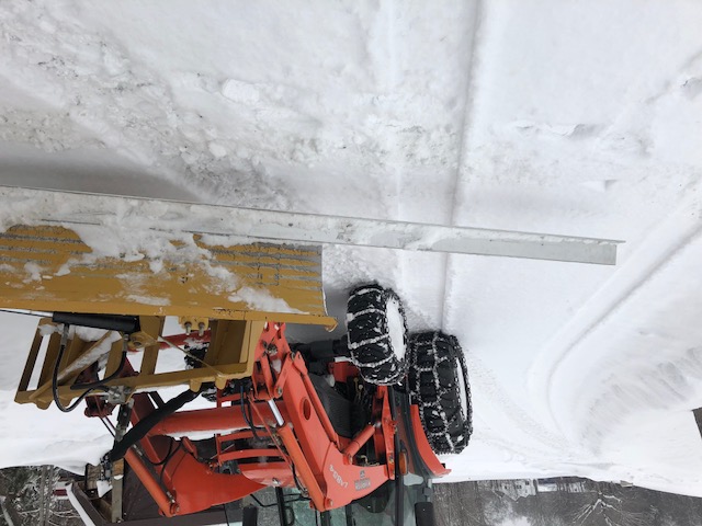

Wing Plow; Rev 2.0:
It works OK, but the tilt on the plow is really screwing it up. I tried putting a piece of steel in the notch that allows the plow to tilt back and forth, so that the starboard side of the plow was tilted downward (enabling me to carve the banks sloping away from the road), but I couldn't keep anything firmly in the notch. I'm giving this version a C+ and will keep thinking about it.
