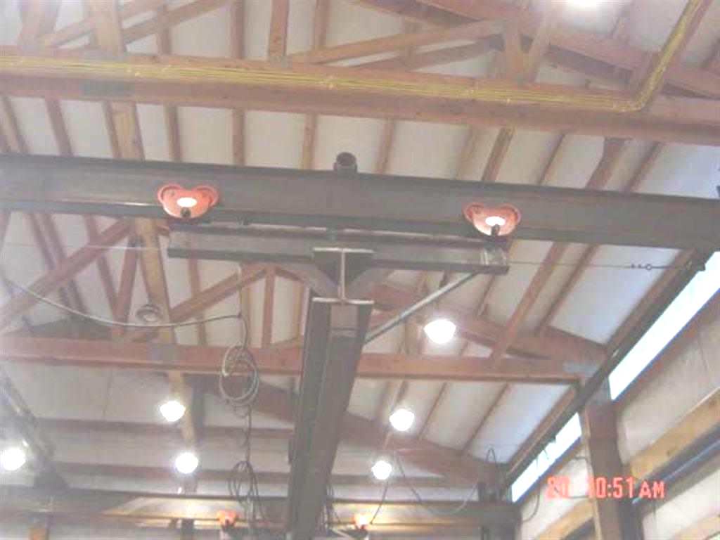

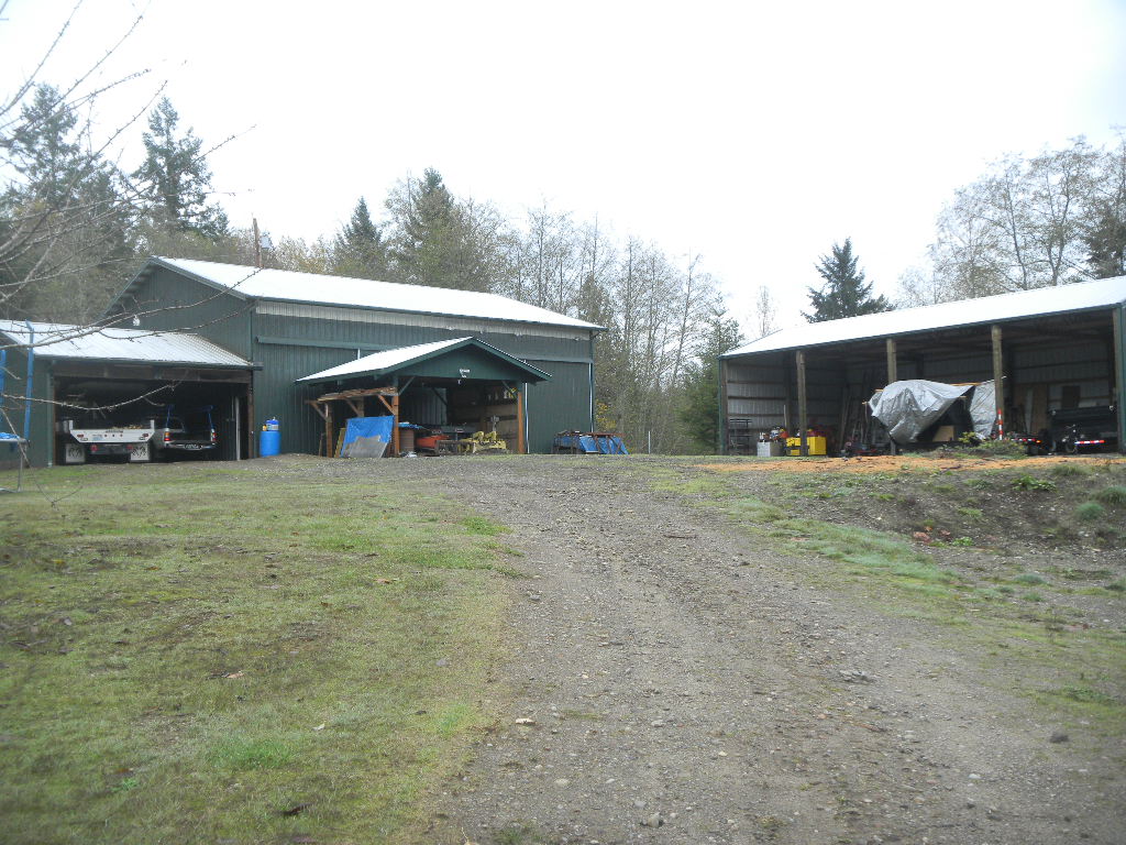

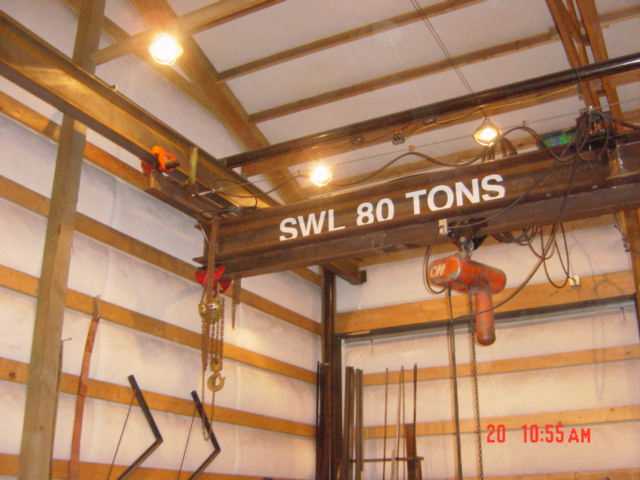

   / Add on bucket hooks #25
Mike it is 40' X 48', w/ 16' to the eaves. With a 20' x 24' garage on the side for the pickup, and flatbed. I had to go with 16' eaves because of the bridge crane. If I had it to do over again I would put the span beam on top of the rails. But I was too cheap to rent a forklift to build the crane. My 8-year old (then) granddaughter and I built the crane, and installed it with the tractor, and the wife's Durango. She did all the layout, welding, and rigging! I just drove the tractor, and followed her hand signals.;)
   / Add on bucket hooks #26
