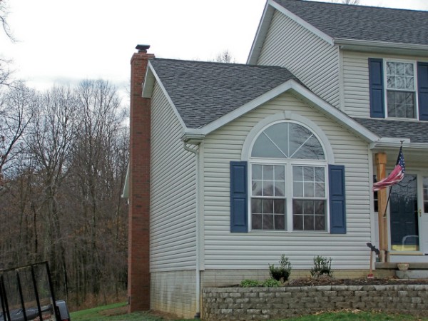

This was taken this morning. They finished last night at dark.

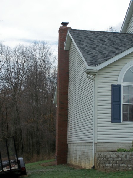

I just need to backfill the hole and get the trailer out of the way....but more rain today.
As far as the furnace itself, the wiring and duct work should be completed on Friday just in time for the cold weather according the news.
It drafts good, see the flame!

   / Add-On Wood Burning Furnace Install - *UPDATE* #13
Its a nice looking chimmey but is there some reason that you preferred mansory over the stainless steel multi fuel vent pipe?
#14
Deerlope,
The chimney only cost $300-400 more than the total cost of the stainless pipe. This did not include the cost of building a chase around the pipe and covering it with siding (which I hate sided chimneys) or a brick or stone veneer. I figure that the masonry chimney would add more value to the home?

   / Add-On Wood Burning Furnace Install - *UPDATE* #15
Now for some good dry wood to burn. That height of chimney and it being 'cold' on the outside, the creosote will condense and run back pretty easily. I remember how easily my first chimney plugged up, although it wasn't near as good a chimney as yours is to begin with.

   / Add-On Wood Burning Furnace Install - *UPDATE* #16
True stainless would not have looked good if it was not encased. Do you know if the mason's sealed the joints in the flues? You get as much cold and bad weather as we do in NY. But it looks good and will last a long time.
