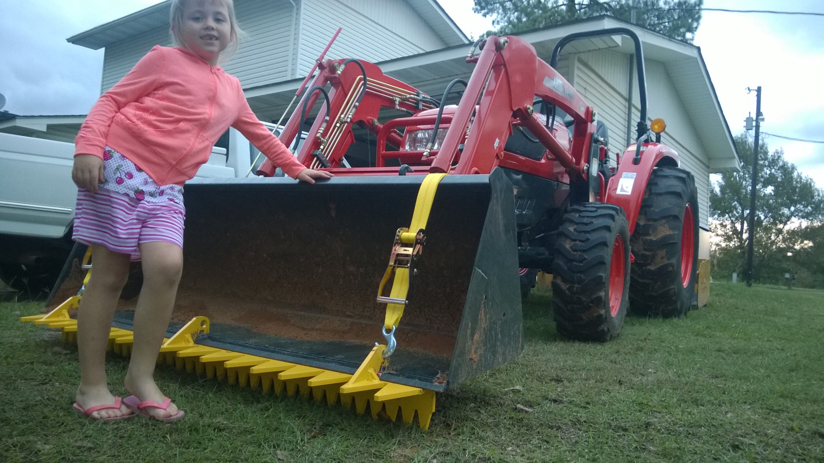

Here is my new Ratchet Rake. My lil helper had to show it off. Cant wait to give it a try but itll be a few days because of the rain.
