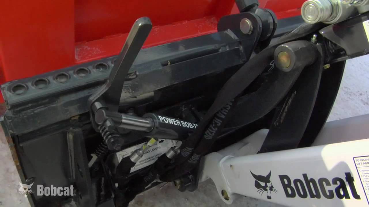

Same idea I had, only thing different is mine uses a single handle release for the latches.

I was refering to the picture of the bobcat. that handle is definitely different than the regular two handled ssqa . I will check out your other thread. Kubota wants a rediculous amount of money for their hydraulic actuation of the ssqa.
   / Added a hydraulic top link today #28
I posted the picture from Bobcat. That picture angle doesn't show the other side.

If the cylinders are not there (it is an option), it operates manually.

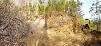

Update after some use this weekend: I'm definitely happy with the hydraulic top link. It has saved me from getting on a d off for adjustments on my latest project....but more importantly it has given me just the clearance I need when in tight spots that would usually cause my box blade to catch. 20190323_184620.jpeg
