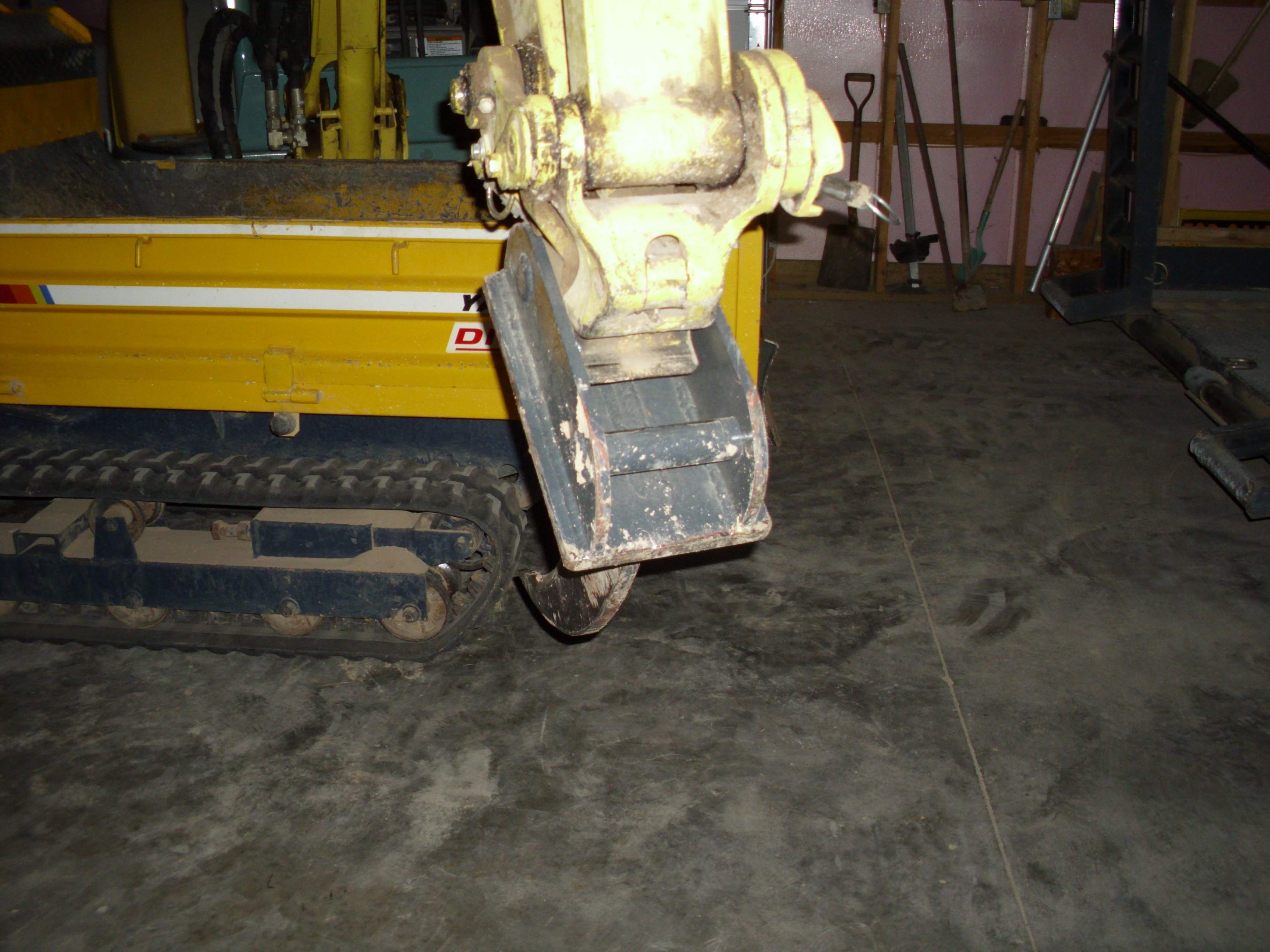

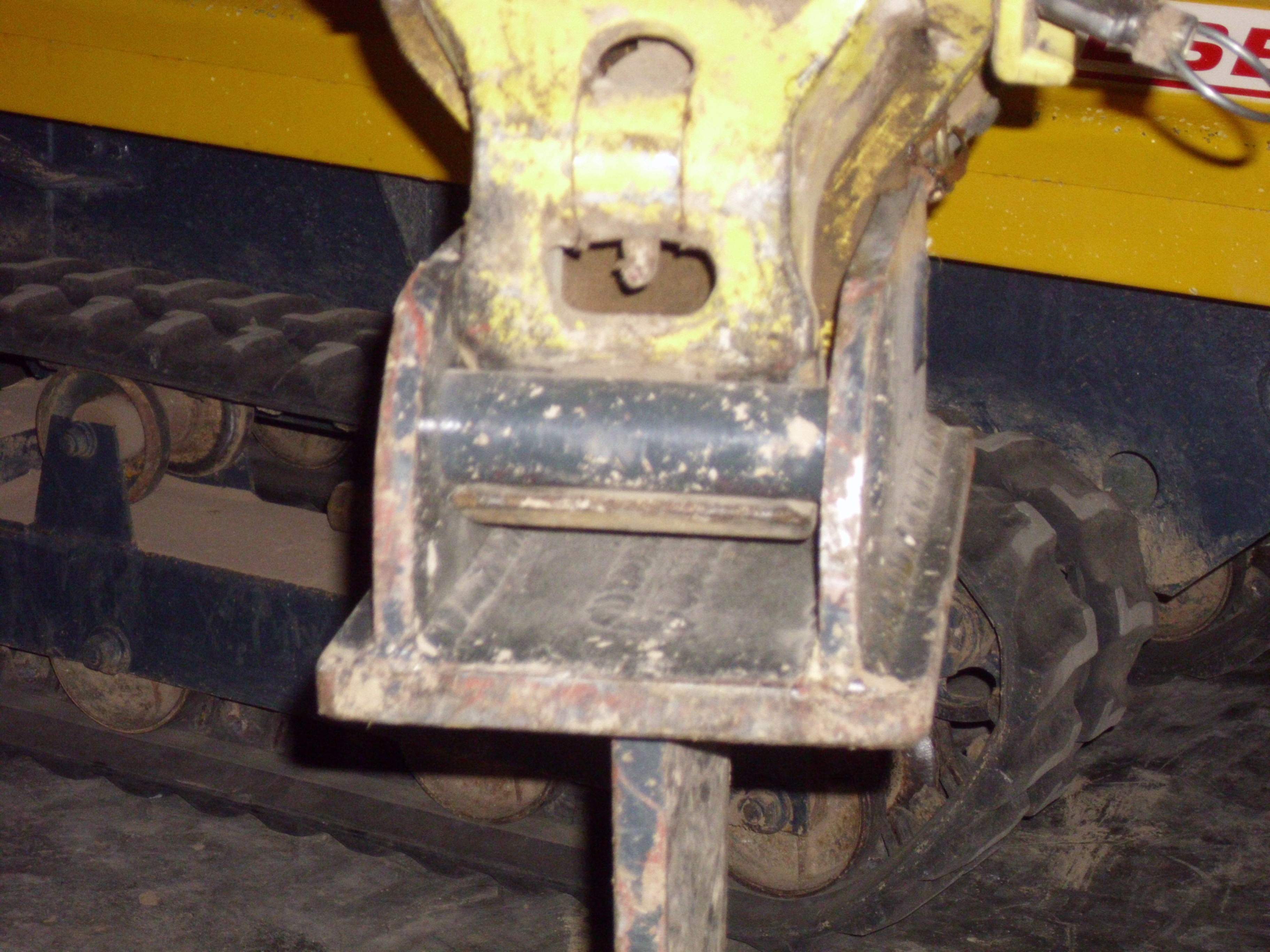

The MIE ripper tooth for my Woods BH90-X BH arrived yesterday. I made one modification to not include the two cutouts in the tooth itself. It weighs in at just around 85 lbs. (on a bathroom scale:rolleyes:).
Thanks IslandTractor for the design and Bob at MIE for the fabrication.

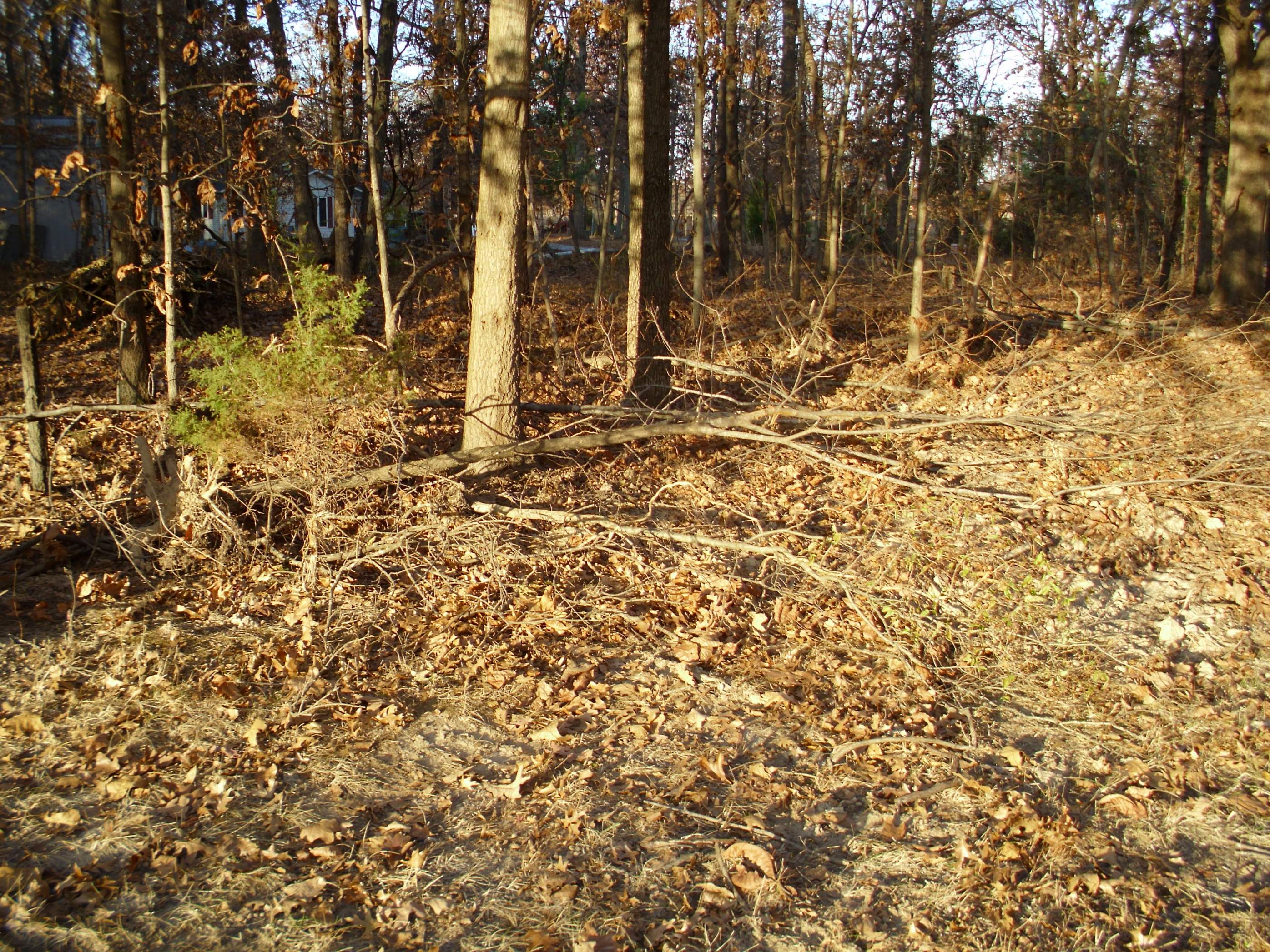

Well I just got through wearing all the new paint off my blade. It worked perfectly. As far as gussetts, I can stall the hydraulics and raise the machine off the ground with it. It doesn't show a sign of any bending or breakage. I pulled up at least two dozen small trees. We haven't had rain here in several months, and I can cut through the clay soil like butter. I have to run all these trees through my chipper so I can get back to pulling up some more. Good luck with your projects.

I was in too big of a hurry to post how well it worked. I'll have to get some pictures to post later.
   / Added a ripper to my Woods BH90x: Trees beware #110
OK, a few pictures for you picture junkies. The hydraulic quick connect is the reason I got this machine.
