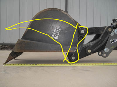

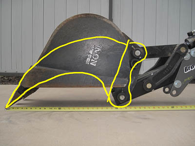

Looking for input. I have good access to equipment to fabricate a ripper for my Woods BH900. In reviewing what has been posted here and the pics that are provided, I have noticed that the relationship of the point to the locator pins seems to be different than that of the actual digging bucket.
See the photos attached to see what I am describing. I have extended my backhoe to it's fullest reach and placed the dipperstick against the ground, also the bucket is in full open position. The front teeth of the bucket do not touch the ground <1/8" above. What are the advantages or disadvantages of maintaining the point location to actual bucket design?
Pic 1 shows duplicating bucket location
Pic 2 shows what MEI style point to locators
