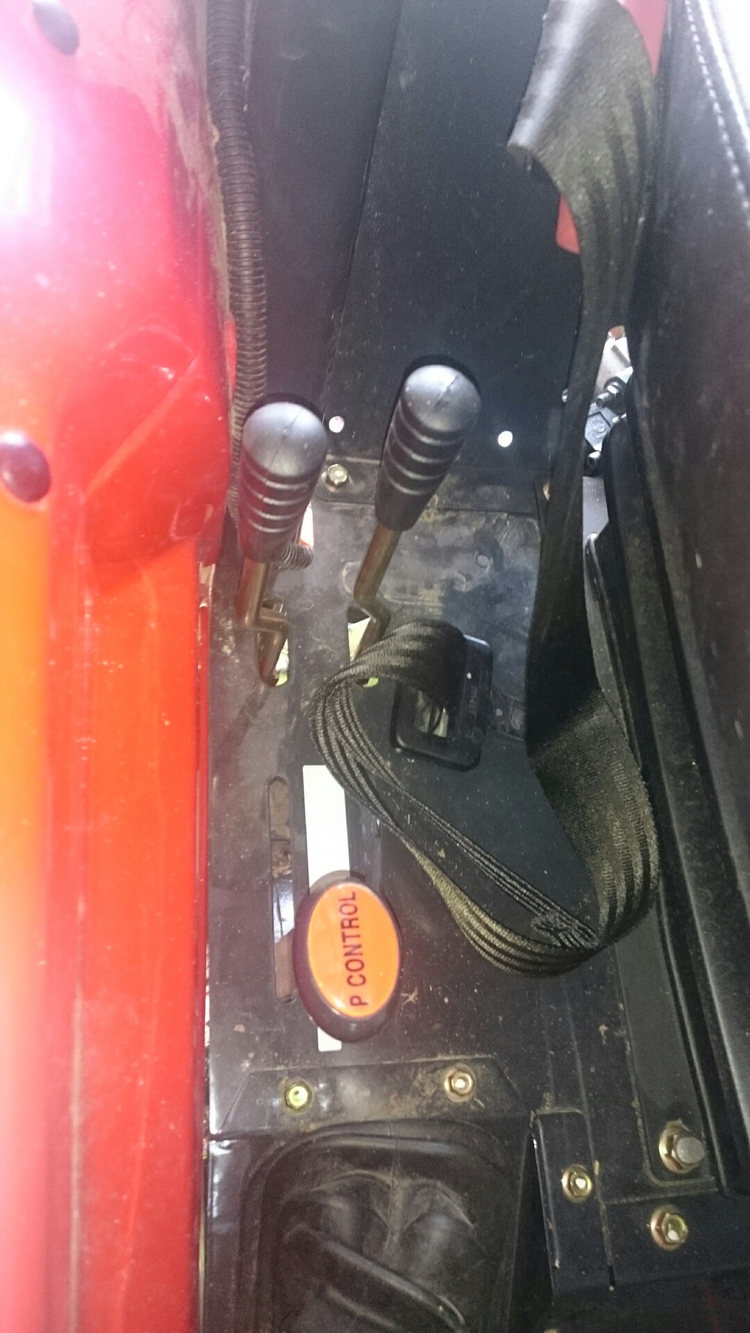

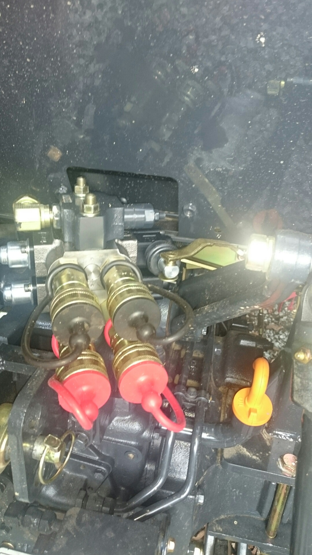

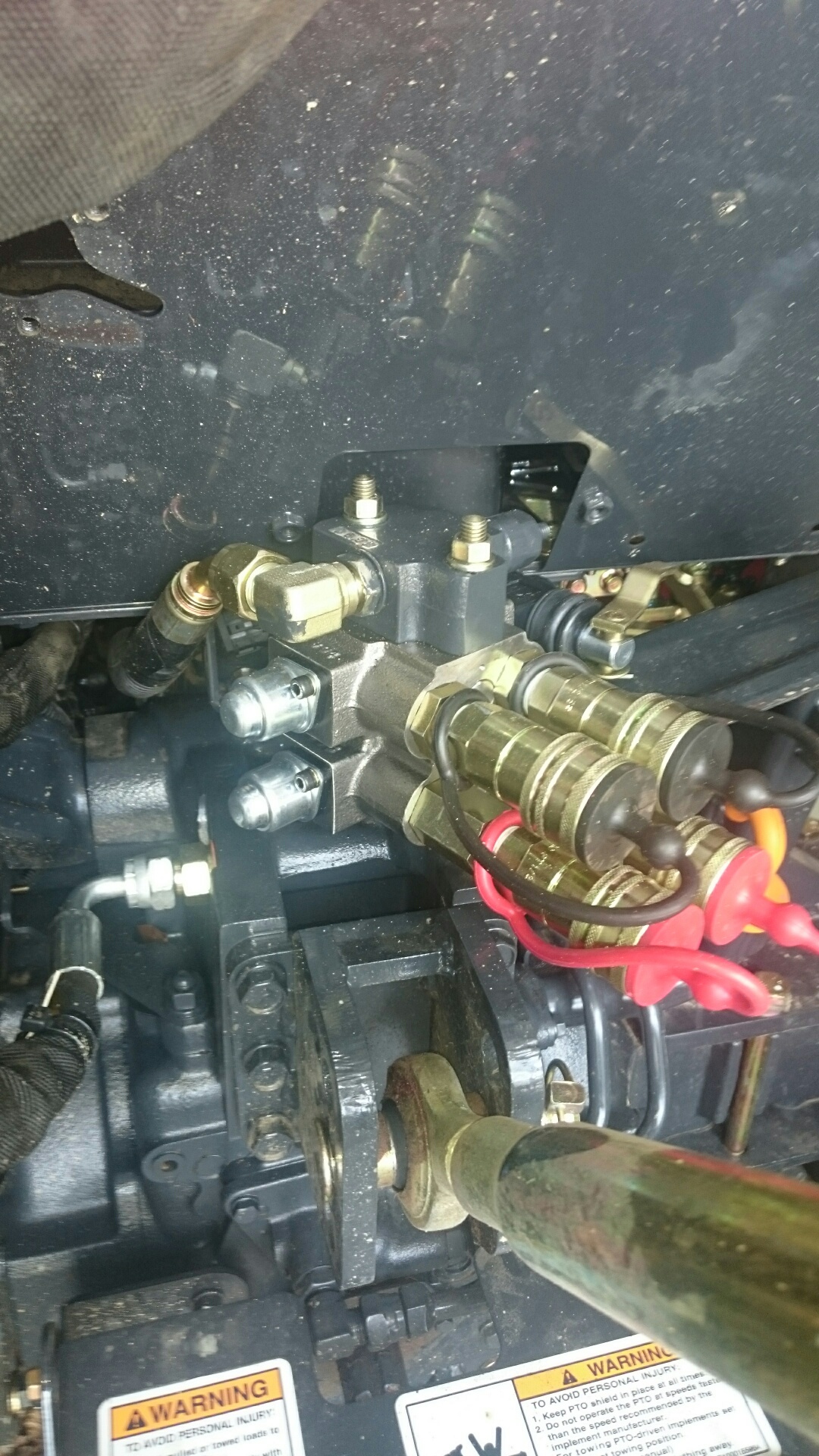

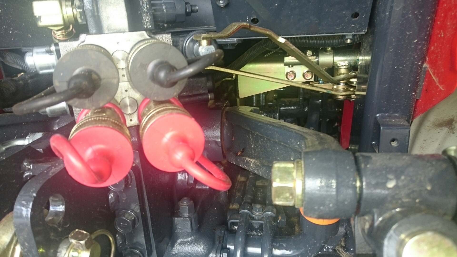

Here are some photos Hopefully they help you...
I have to make a small adjustment to one of the levers to get it centered up but other than that it went together quite easily. One tip... Assemble as much of the lever assembly as possible then get it loosely in place before installing the valves. I did this and it sure saved me some trouble installing the controls as there are some small cotter pins involved and it would have been awkward for sure!

These are very helpful. If a fellow wanted to put on a grapple, could you use one set of these remotes for opening/closing the jaws? I am thinking of getting a grapple but would prefer to have a set of rear remotes and just use one function for the jaws instead of having to run a button on my loader control, I think.
   / Added dual rear remotes to 4520R
#12
Absolutely. I have ordered a grapple and expect it to arrive in 2 weeks or so. As we're so close to each other pm me if you want to find a time when you can come look at it. I installed my 3rd function valve tonight, but want to make some changes to it. Paint the bracket etc.
These remotes will work fine for any cylinder application but they do not have a float position so aren't suitable for a log splitter, etc.

Looks great, what exactly comes with kit, it seems that I don't have the cutouts for the extra sticks on mine?
#14
There are some differences between the 4520R and 4720. The dealer had to make sure I had the correct kit. The one for the earlier models has an extra hose, and I think the valve levers mount different too.
My kit included 2 valve bodies, the lever assembly, linkage bars to connect the levers to the valves, a 2pc bracket to mount the levers, 2 each male and female couplers and hardware.
