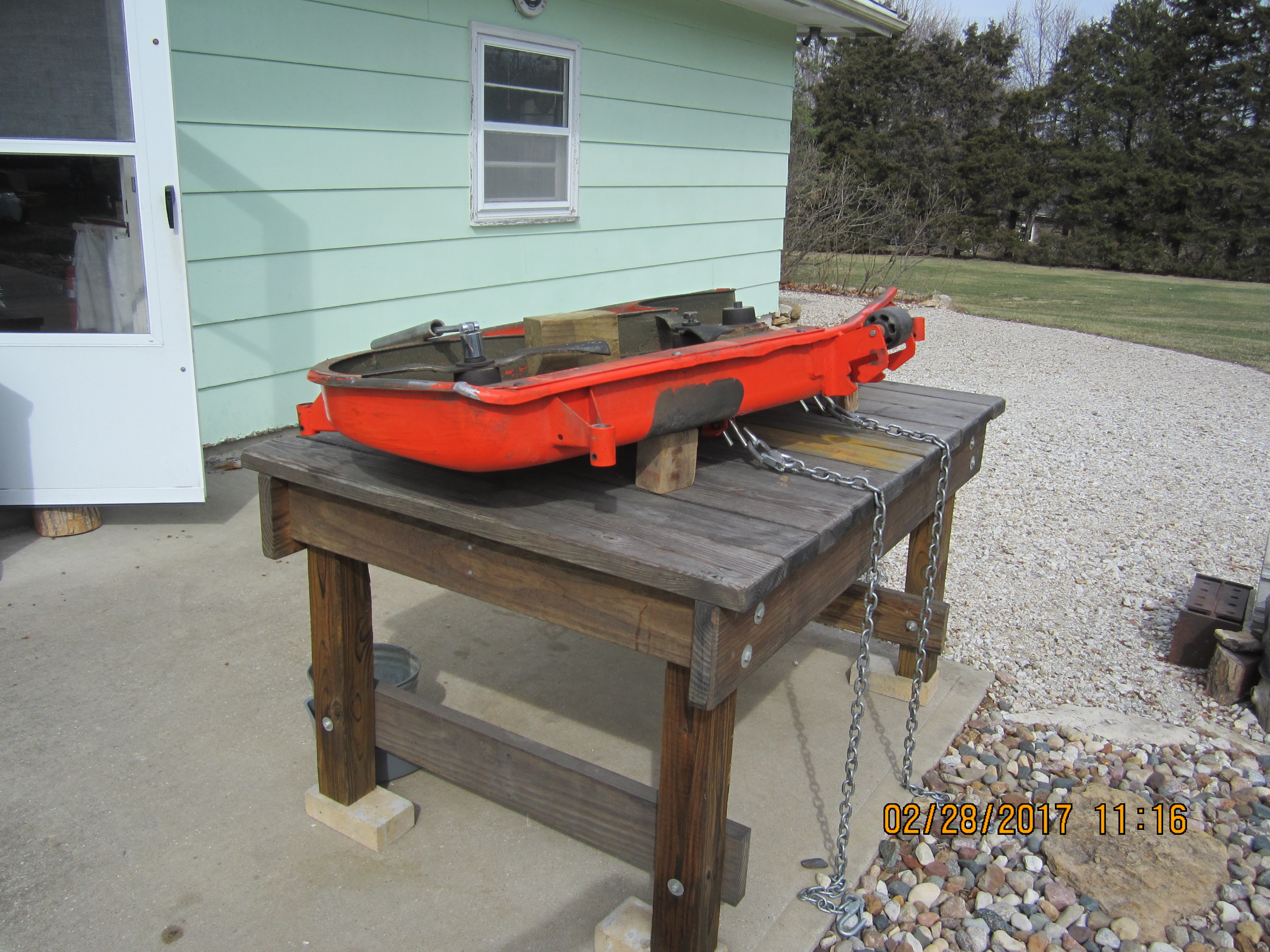

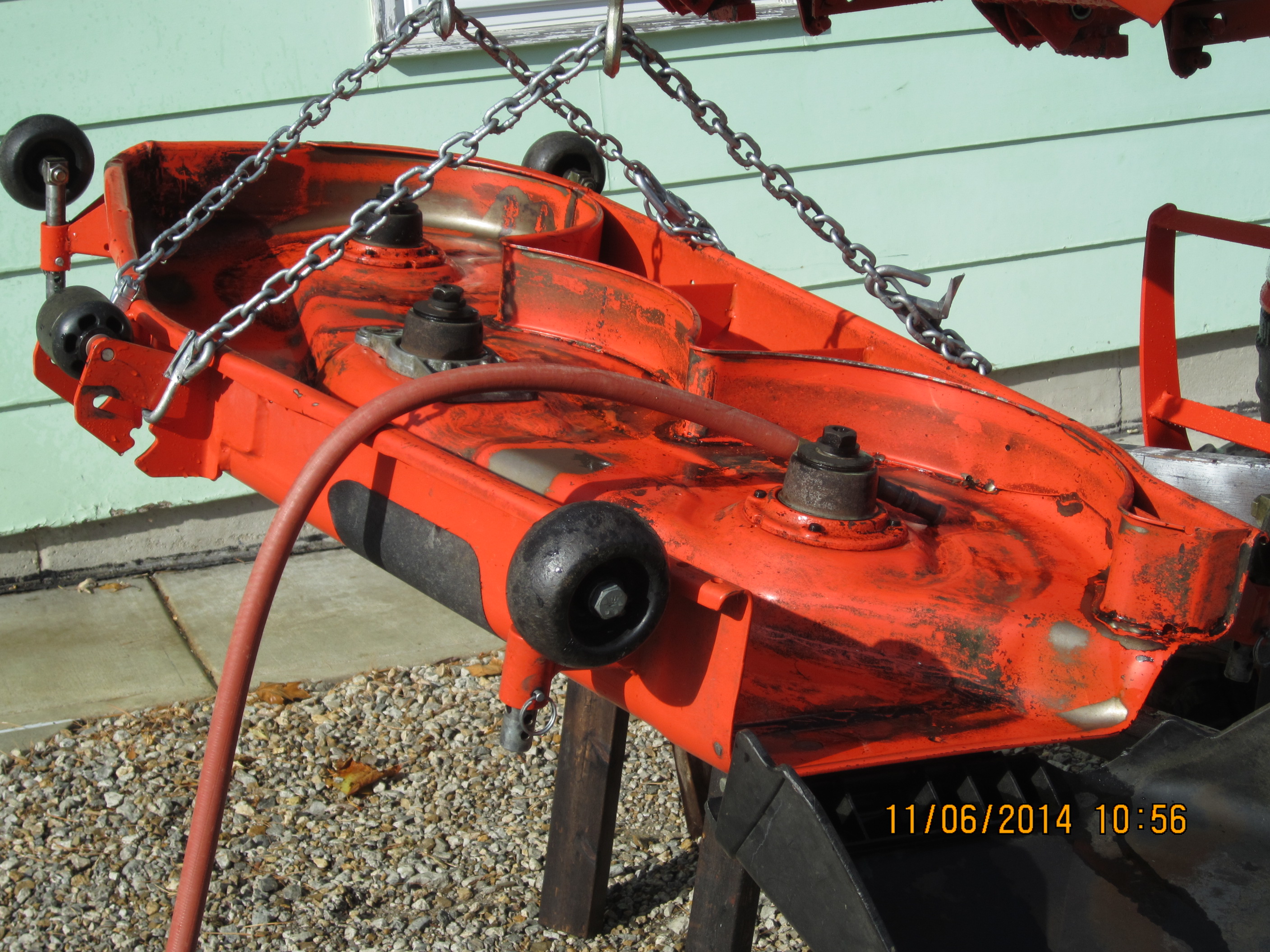

Here's my approach to the lift, using just two bolts. Early on I tried working on the deck as it was suspended......didn't like that.....Then I tried working on it using some old shaky saw horses....did like that either. So as you can see I made a sturdy outdoor bench that is good for a lot of projects. Sparky....just trying to add to your post....not upstage anybody....View attachment 505237View attachment 505238View attachment 505239
Oldballs, No offense taken. I actually considered using bolts the same way you did. Not sure why I changed my mind. I guess I like to make more work for myself. It gives me more garage time!

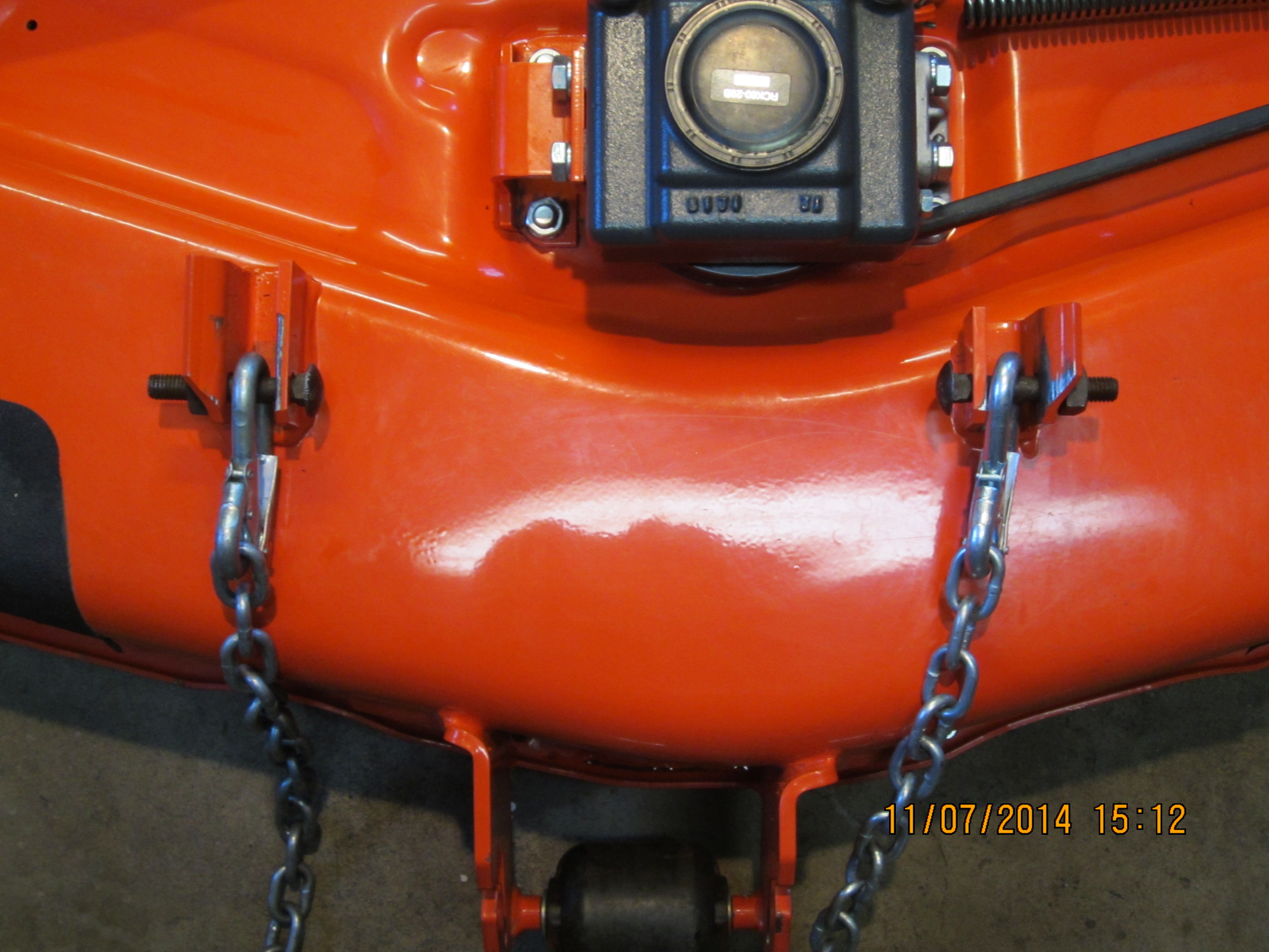

When we service the deck on my fathers BX, I just use the factory brackets between your eye bolts to put a chain through and lift it with the loader.
