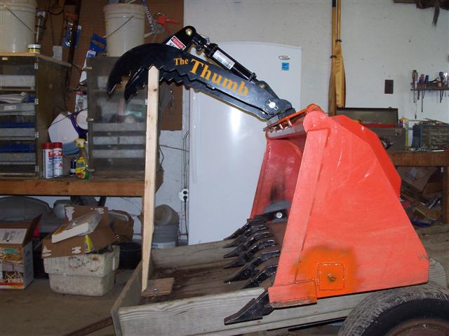

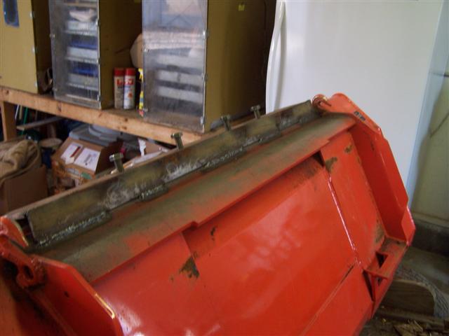

Here is how I did mine.Tacked the nuts to the bottom of the angle for easy
removal.I had to "tilt" the angle a little so the Thumb would close on the bottom
of my bucket.I can pick up a one inch thick rock or a huge pile of brush.
The tooth-bar is a worth while addition also.

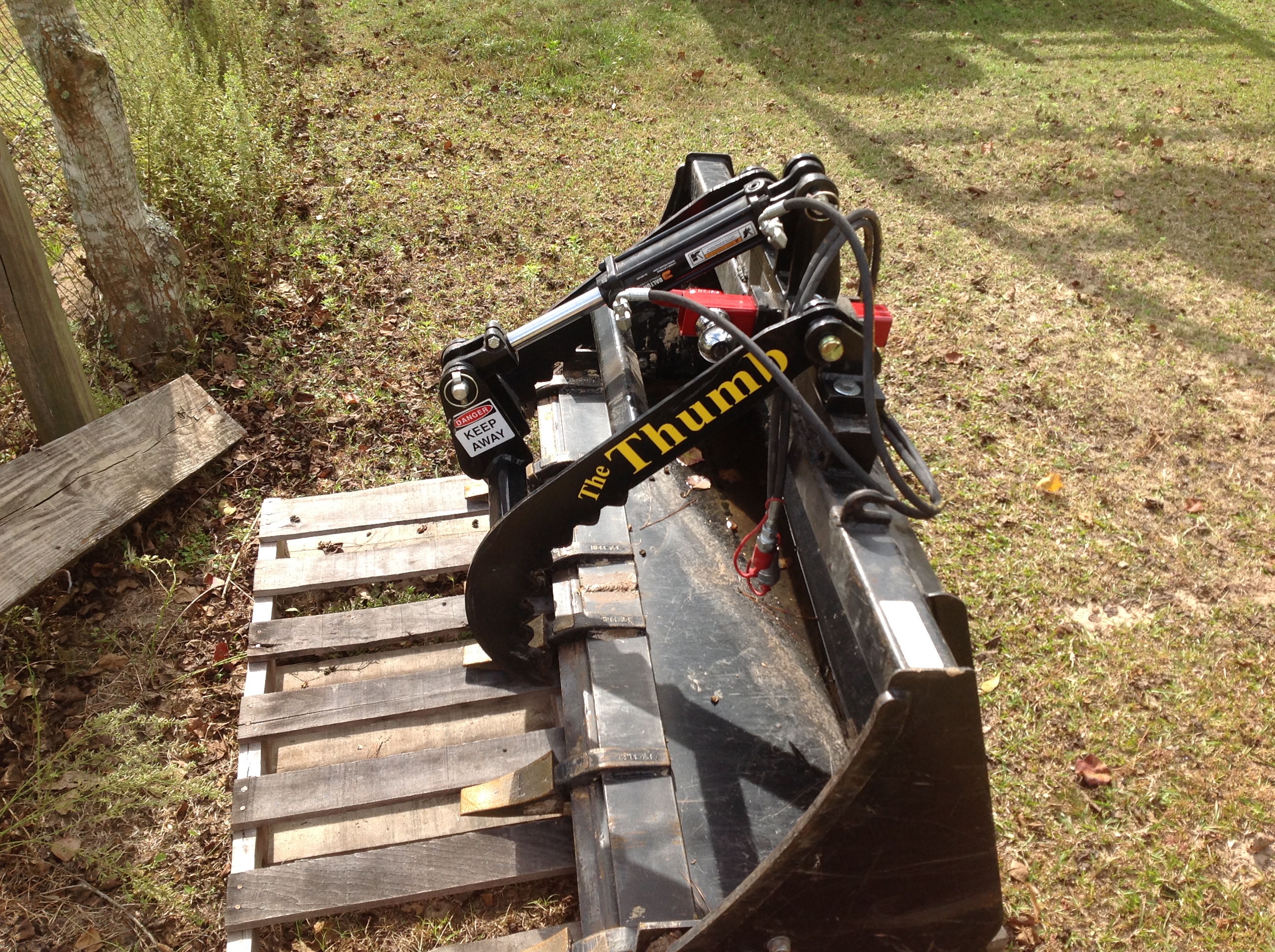

Got a good start on installing the grapple mounts. Below Zero and 20 knots of wind and working in an unheated garage...what fun!
Details and more pix here:Shopbuilt Forum

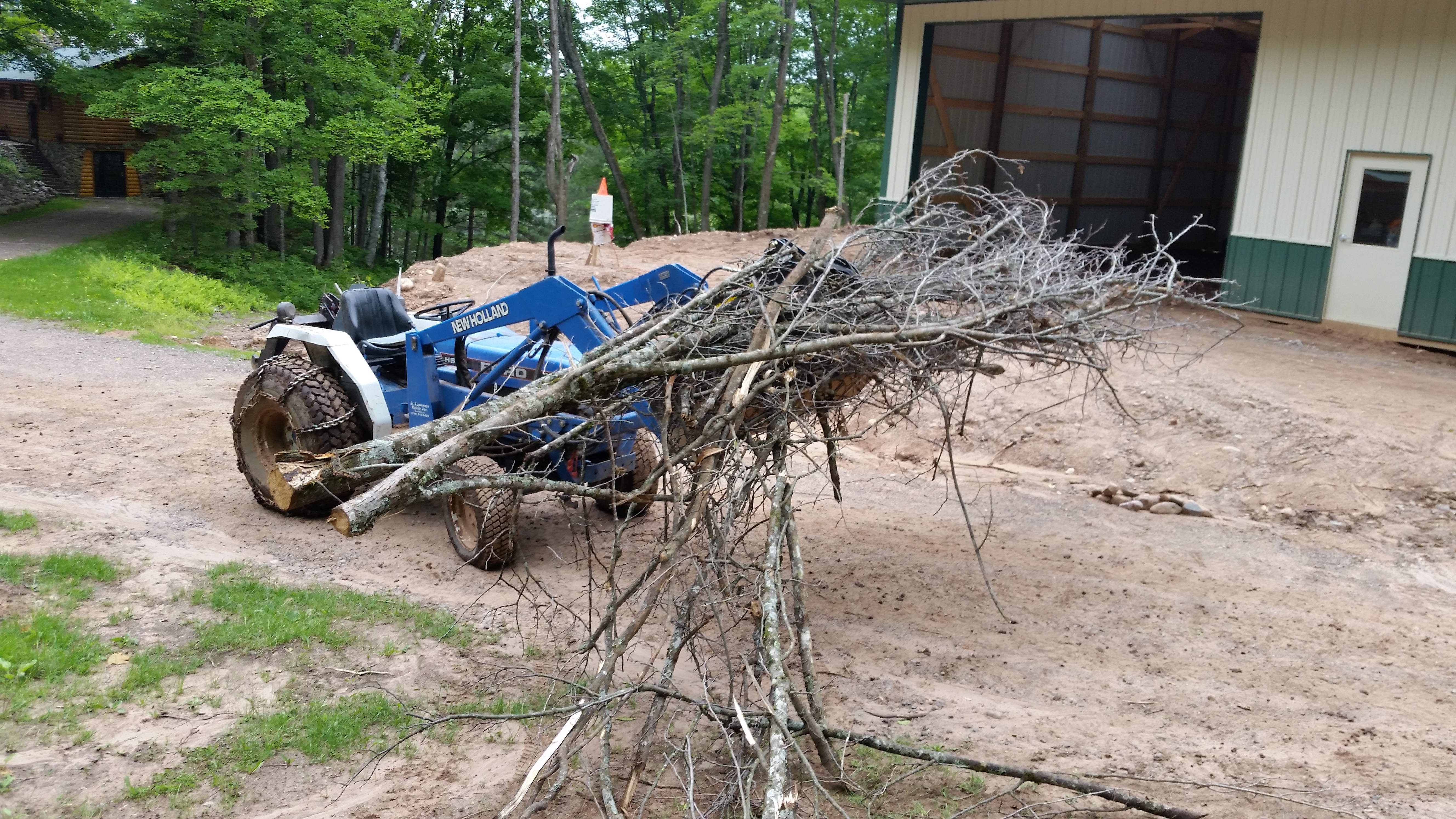

   / Added Grapple to bucket #17
xfaxman you just have decide how the brush is.. if its tree tops and connected just get a bit and the rest comes along for the ride..20150613_101511.jpg
   / Added Grapple to bucket #18
Yep, then I go back and pick up what fell off along the way to the brush pile. :D

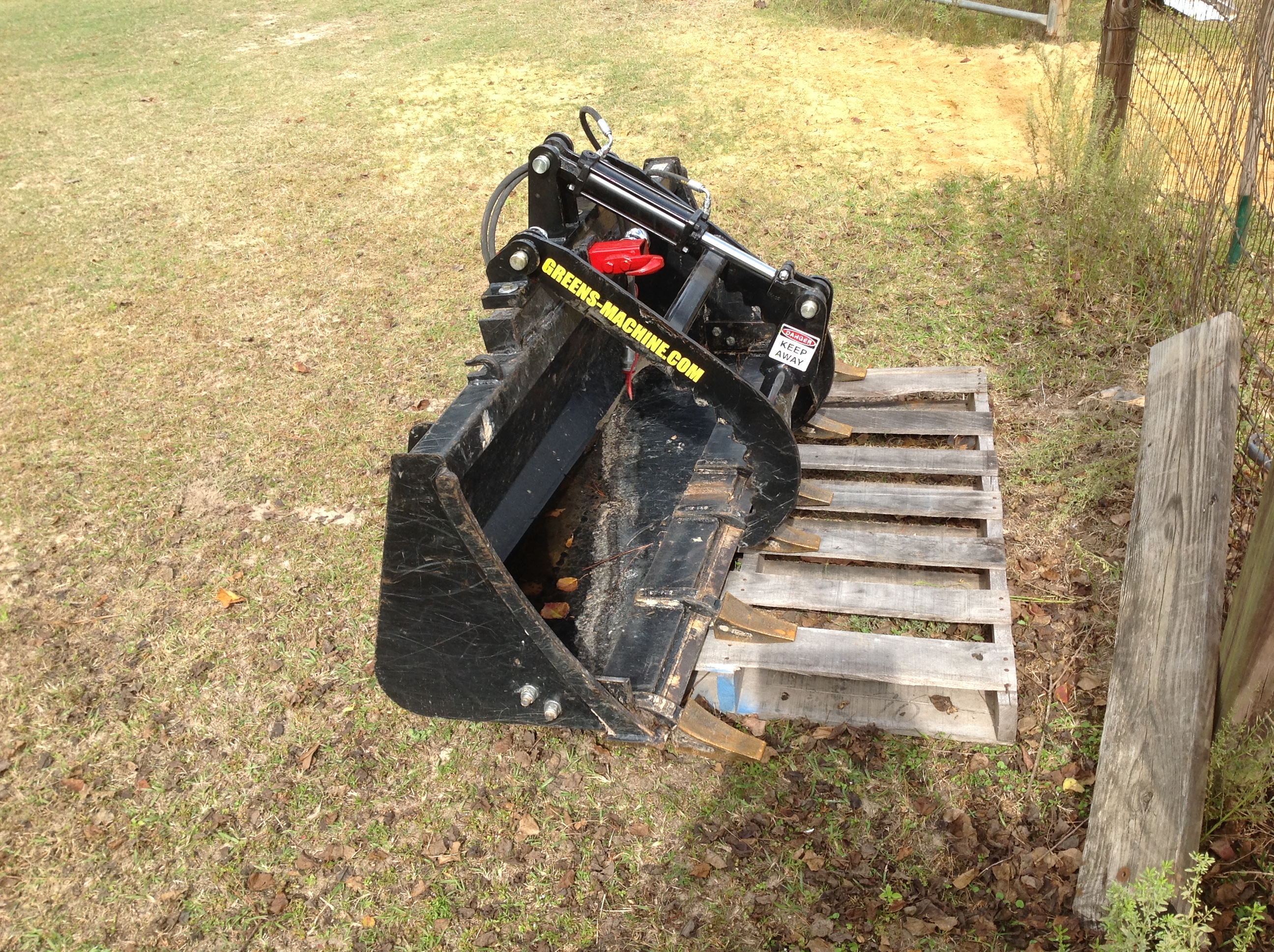

   / Added Grapple to bucket #20
Some details to finish up. I didn't allow for bucket curl when I thought about hoses from the loader to the thumb cylinder so I need to let things flop until I can get longer hoses. Then I'll secure the hoses from the rear remote to the loader cross-member with a bracket and just have the hoses from there to the thumb flexing.
Also should have ordered the 28" instead of the 24" thumb, but I don't think that will be much of a problem, and if it is, I can rig an extension.
Full story here.
