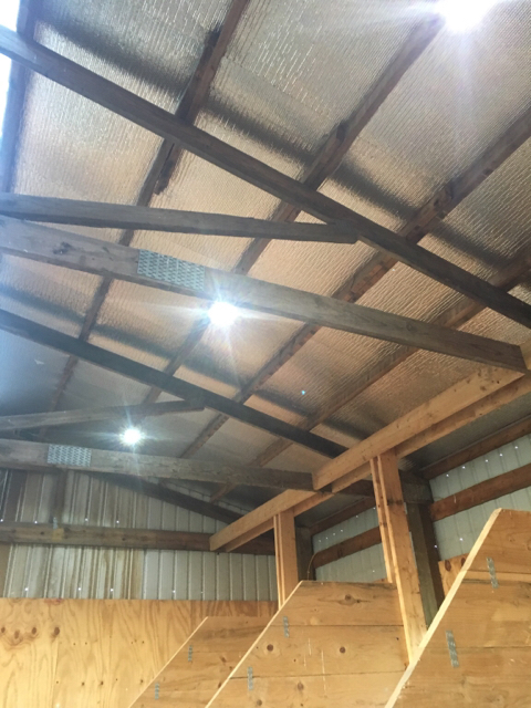

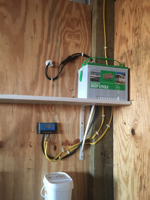

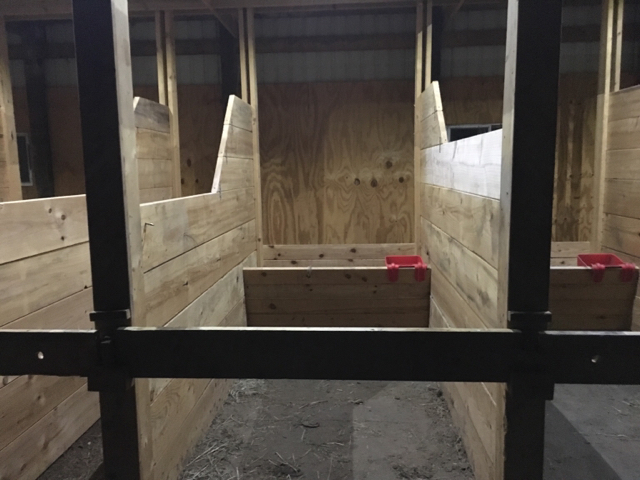

Well my brother in law wired up the lights to the battery this weekend, amazon goofed my order so we are still waiting for parts to connect to the solar panel
Pretty happy with the light over the stalls thought I may add another 6 lights over the other half. The solar panel and Battery can handle it no sweat, next weekend I'll get pictures after we get the solar panel up and hooked up to the battery and charger.

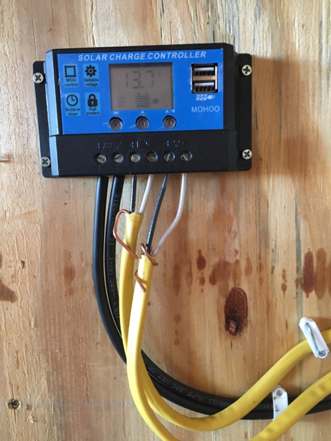

Finally got the connectors so I could hook up the solar panel

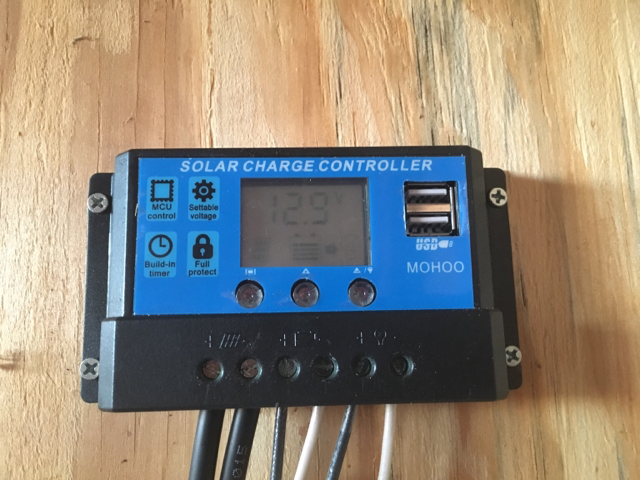

So the 12.9 reading was late afternoon when the sun was almost set.
At 10am getting 13.7-8v. I could probably get better if I angled the panel but it's going to have plenty of juice to keep the battery charged. So far so good with my first venture into solar. thanks for the help and advice! IMG_1479054476.176498.jpg

Nick, are charging results keeping up with all of your load requirements? Now that you have had and used the system for a while. And do you think there is any chance you could go negative in the cold dark cloudy days ahead? Or will you still have enough reserve to get through until the next sunny positive day?
   / Added solar power to our tractor storage building (pic heavy!)
#46
No problems to date. The system has a lot more watt hrs available than I am using or that the battery can absorb. The battery status LED is typically showing the slow flash for float charge before the end of the day. Since the exterior floods are motion sensor controlled, there is virtually no drain unless there is activity in their range and I don't use the interior lights much at all. The battery is a 105 AH deep cycle, so full charge is probably good for close to 20 hrs of interior light use. With current use levels, that is plenty for multiple weeks of my typical use before getting it down to an "undervoltage" state even considering self discharge.
