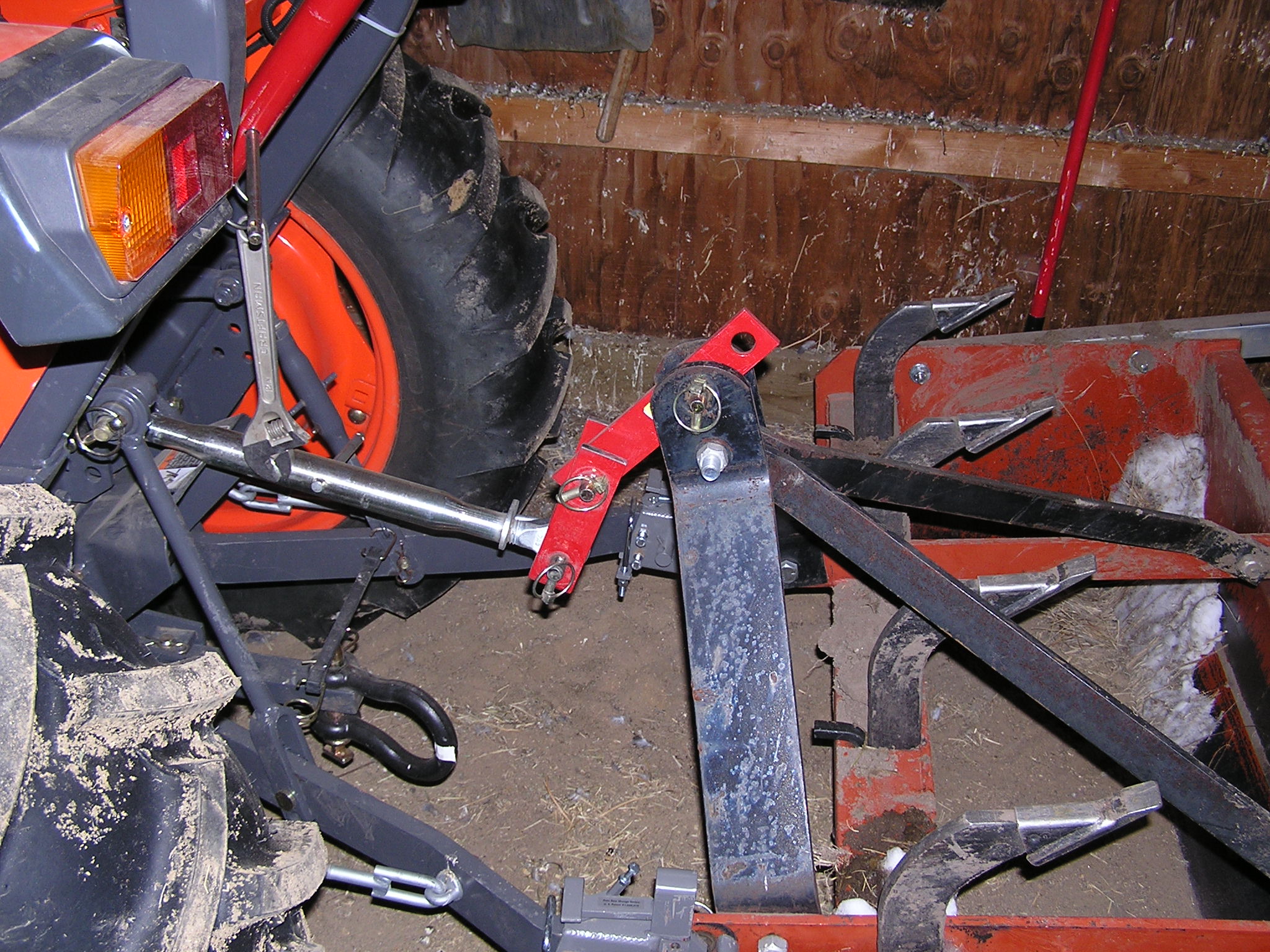

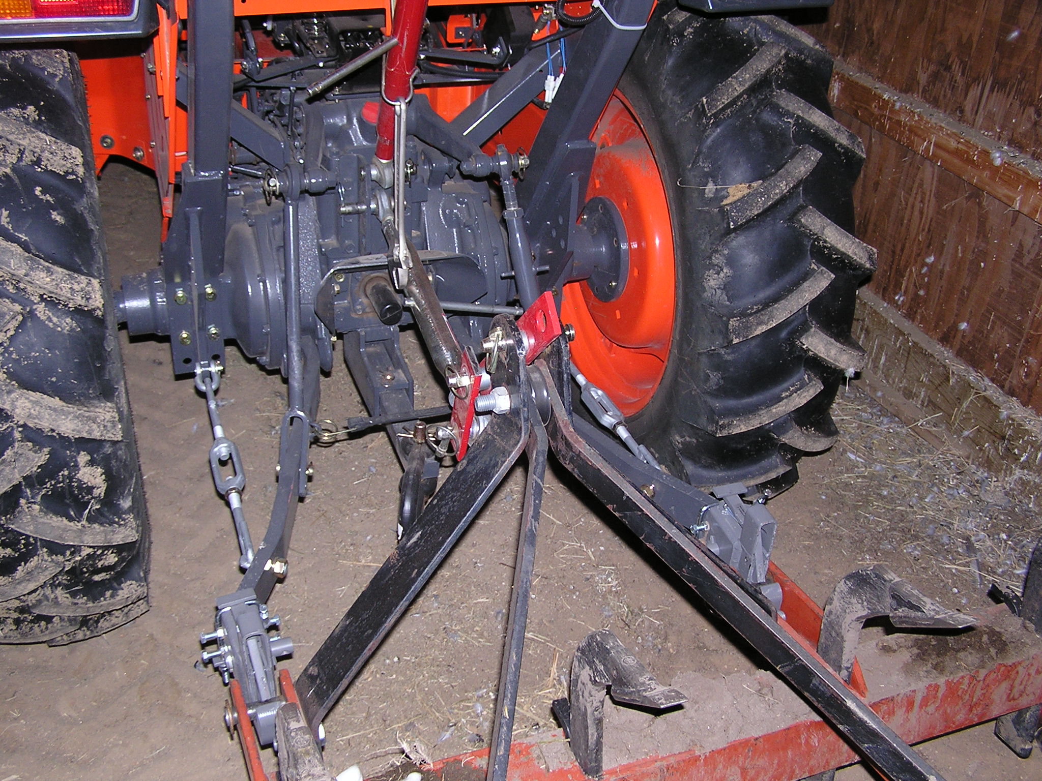

Looks great! But can you explain what the gauge wheels allow you to do that you couldn't without them? I'm new to all this. :)
   / Added training wheels to my box blade Pics
#12
With this setup the blade is equal distance between the front pins on the box blade and the gauge wheels. The box will float with the surface smoothing out the ground. If the box is supported with the 3 point it will tend to raise and fall more.

The top link connector is a steel bar that I drilled holes in for the pins. You can see the movement in the linkage as the box floats.
That link looks like what I've been looking for. Could you post a closeup picture and some more details?
Thanks,

I think every one should member to let it pivot like a mower would yours look great!
Can you post a closer picture of the toggle on the top link?

It is real hard to see. It helped out the top link system.
Thanks,
Ihfram,
Here are the pictures. The problem I had is with the link attached to the box blade. When it went slack the 2nd link would hit the box blade brackets and bind up. I needed a spacer to keep the 1st lifted to some extent.
RobS,
There is your 2nd hint.

Racer71 said:
Ihfram,
RobS,
Got it now, ingenious!

Thanks! Great simple design I plan to copy. I like your spacer too.
