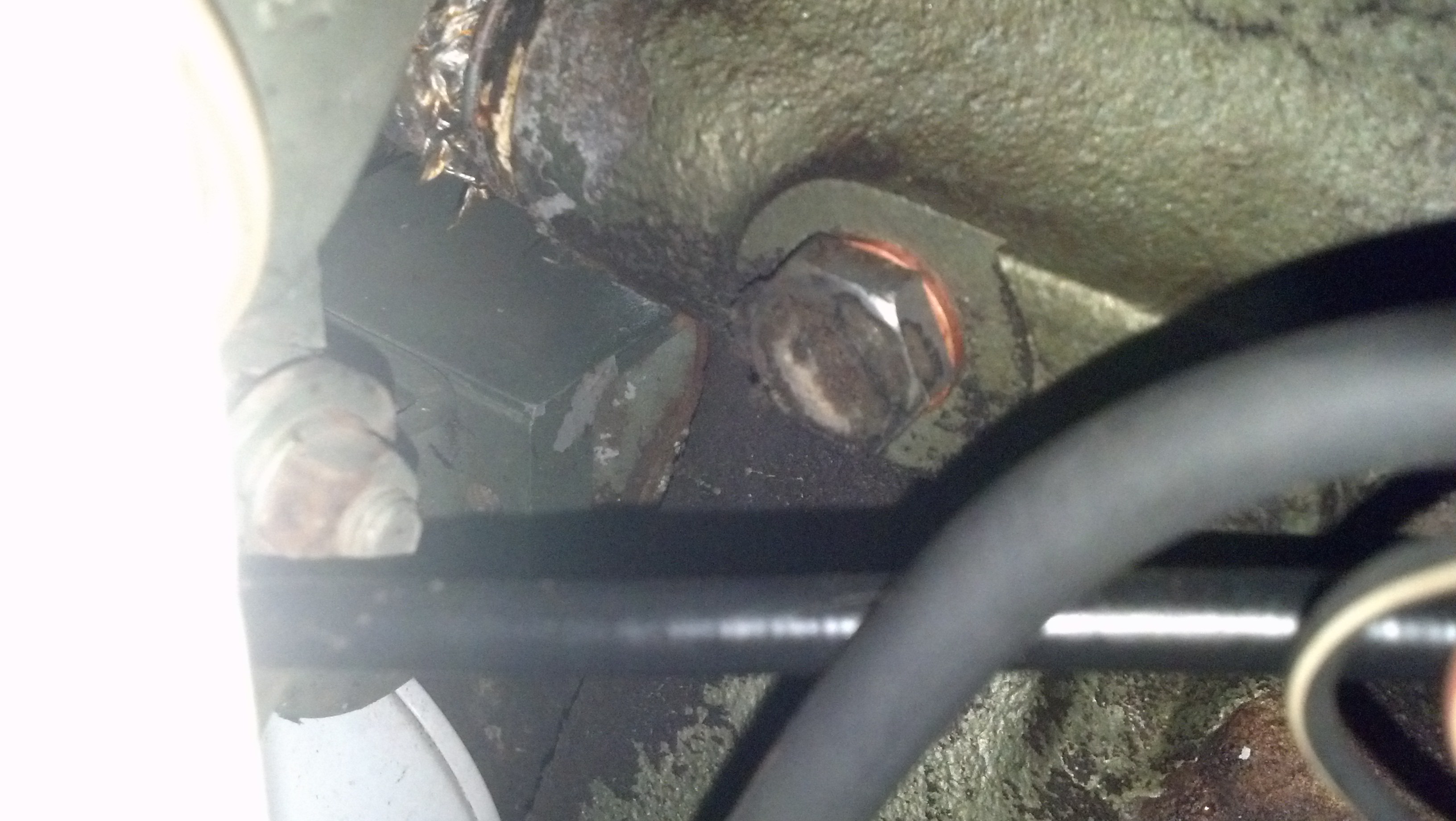

Funny you bring this up..I just got a ym1700 and on the left side of block where lower rad hose connects there is a plug that is exact same size as the plug that the temp sender on the top is screwed in. I assume is an extra location to add a gauge. I have owned many models and this is the first I have seen it..
If you all need a pic let me know.
/ Adding 3 gauge sets #5

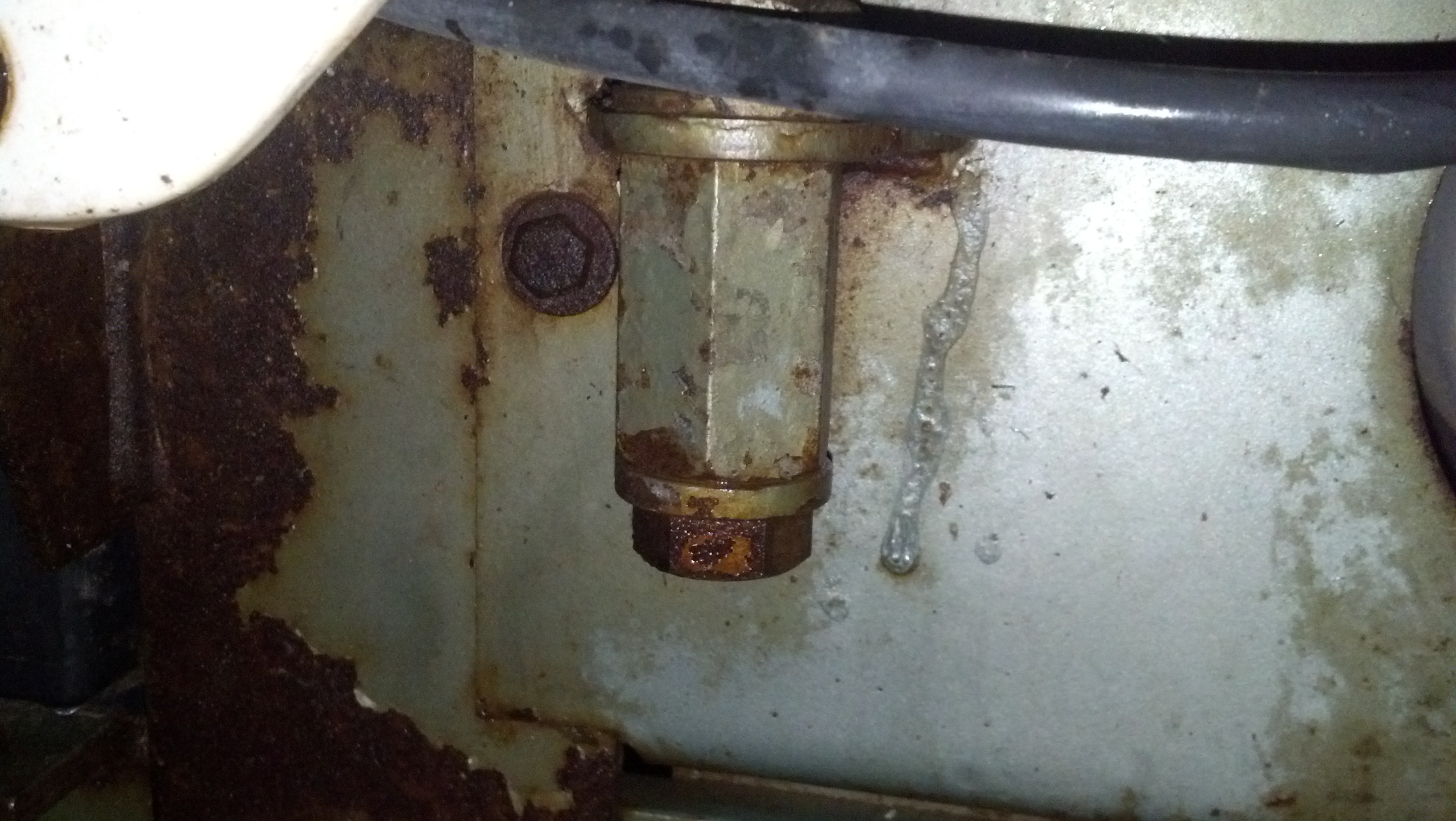

Smoody I think that plug is the coolant block drain. My YM240 (similar) and YM186D have a small hose from a fitting there to the radiator lower tank. The YM186D has a drain at the midpoint of the hose. I think this configuration is common on Yanmars. If you are talking about something different, excuse me.

What I am reffering is on the engine block and has a bolt in it...the coolant drain you refer on some models is bolted to the frame beside oil filter, and yes I have seen the small hose connected to it..I see your point about the reading that low not being accurate... I dunno for sure either and it may be a drain...never seen it on my others..I'll get a pic
/ Adding 3 gauge sets #7
First pic is the coolant drain California mentioned..second is the plug on left side of block. IMG_20130711_204100_715.jpgIMG_20130711_204051_293.jpg
Ok I'm home in town and can't see my gear at the moment. But I thought on mine that drain device in the left picture was midway in a small hose between the block and the lower radiator tank. Maybe I'm imagining things. The copper washer under the plug might suggest an oil passage??? Is it in line with the oil pressure sensor?
No, that plug is directly inline with the lower radiator hose, if you look closely in the pic you can see the rad hose to the left...I plan to change the coolant ratio and change oil this wekeend, ill remove that plug and see what comes out, my thinking it will be coolant.
