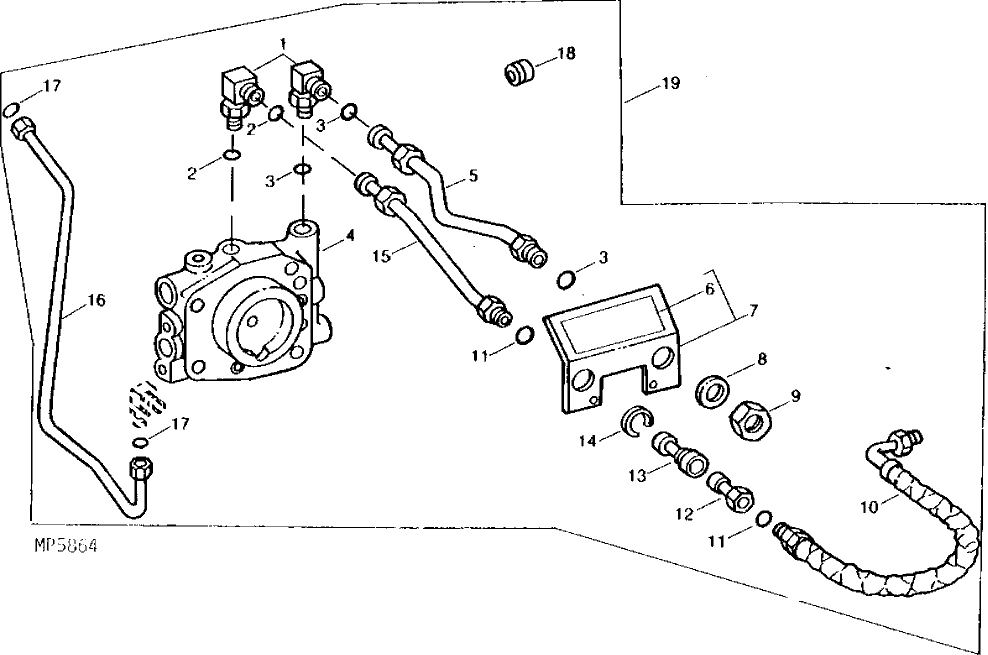

I want to add a valve to raise and lower a cylinder on my custom dump cart, right now im using the loader valve. Thats a pain to plug and unplug lines! My question is can i " Tee" the pressure line coming out of the pump ' run it into the valve then run a return line to the return side of the pump ( making sure theres a relief built into valve of course ) Would this work ?? my dealer acted like i had six heads ? They also told me a power beyond kit was no longer available , but that only constant flow or could i use that if i found one ???? HELP OH GODS OF THE TRACTOR!

You cannot "Tee" any high pressure hydraulic lines-period. The hydraulic fluid, like electricity will "take the path of least resistance" and never get to your new valve.
Since the PB kit is NLA, then you will have to homebrew your setup...are you up to the task? Estimated cost will be about $300-$500 by the time you get all the stuff, and you will have to fabricate a mount for the new valve.
The PB kit is pictured below, you will basically have to build that and use lines to feed the new valve, will need to know the S/N of your machine to help with more detail-JDParts show different setups.
Do you have a shop manual by chance? Are you ready to procede?

Thanks Mitch I have that image of the P/B kit from my Dealer , The piece according to the parts list there calling the hydraulic cylinder cap ,[ valve body] where does that mount too ?? The back of the loader valve ? I'm not near the tractor but owners manual says 100001 - I have this # from the bill of sale LV077D180465 ?? I will post more later!

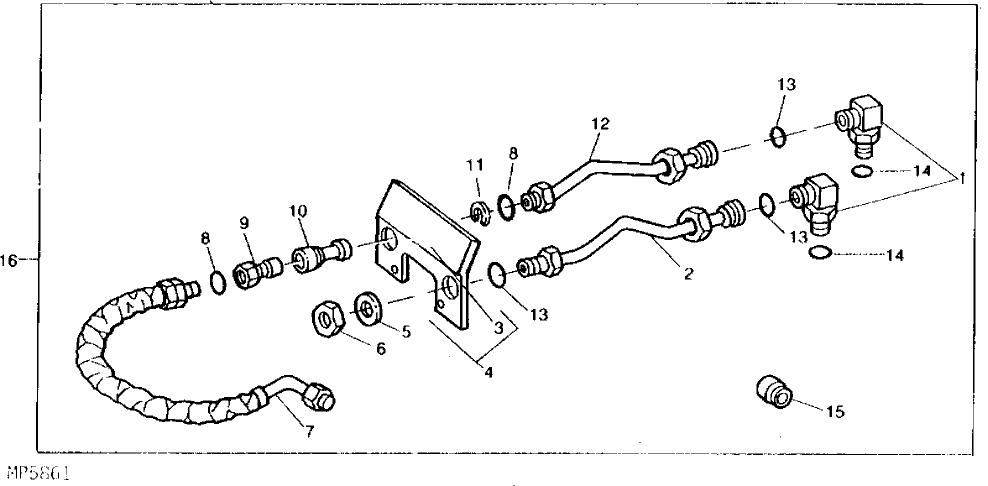

OK, Just did more research in JDParts (you are registered right?) It is not the S/N number I need like I thought-but rather the "transaxle S/N", here is what is says:
TRANSAXLE SERIAL NUMBER IS STAMPED ON TOP OF THE CASE, BELOW LEFT SIDE ROCKSHAFT ARM
It should begin with 82......
The reason is they list two different kits, the older one is the picture I posted above and I think you need that big part #4 and possibly the line #16
The new kit (pictured below) just needs the diverter plug #15 and the fittings and hose that you can source locally from any hydraulic shop or online.

I believe i have a later tractor , unsure of year ? The # i found was between the return to the tank and the rock arm, you ment part of upper 3pth pivot i think THE# ( 843575 ) A couple of numbers on the pump, 160kgf/ cm2 and discharge 7cc/rev ??? I m unsure GPM
I only know what I quoted above from JDparts (you are registered right?)
If you have the later # above 820001-and it looks like you do, then all I would order from JD is the diverter plug P/N PT13744.
You also might want to find a FSM (factory service manual) on eBay also...
Basically, when you install this plug, it diverts the fluid OUT of one of the ports, through the new valve then back IN the other port whenever the tractor is running.
