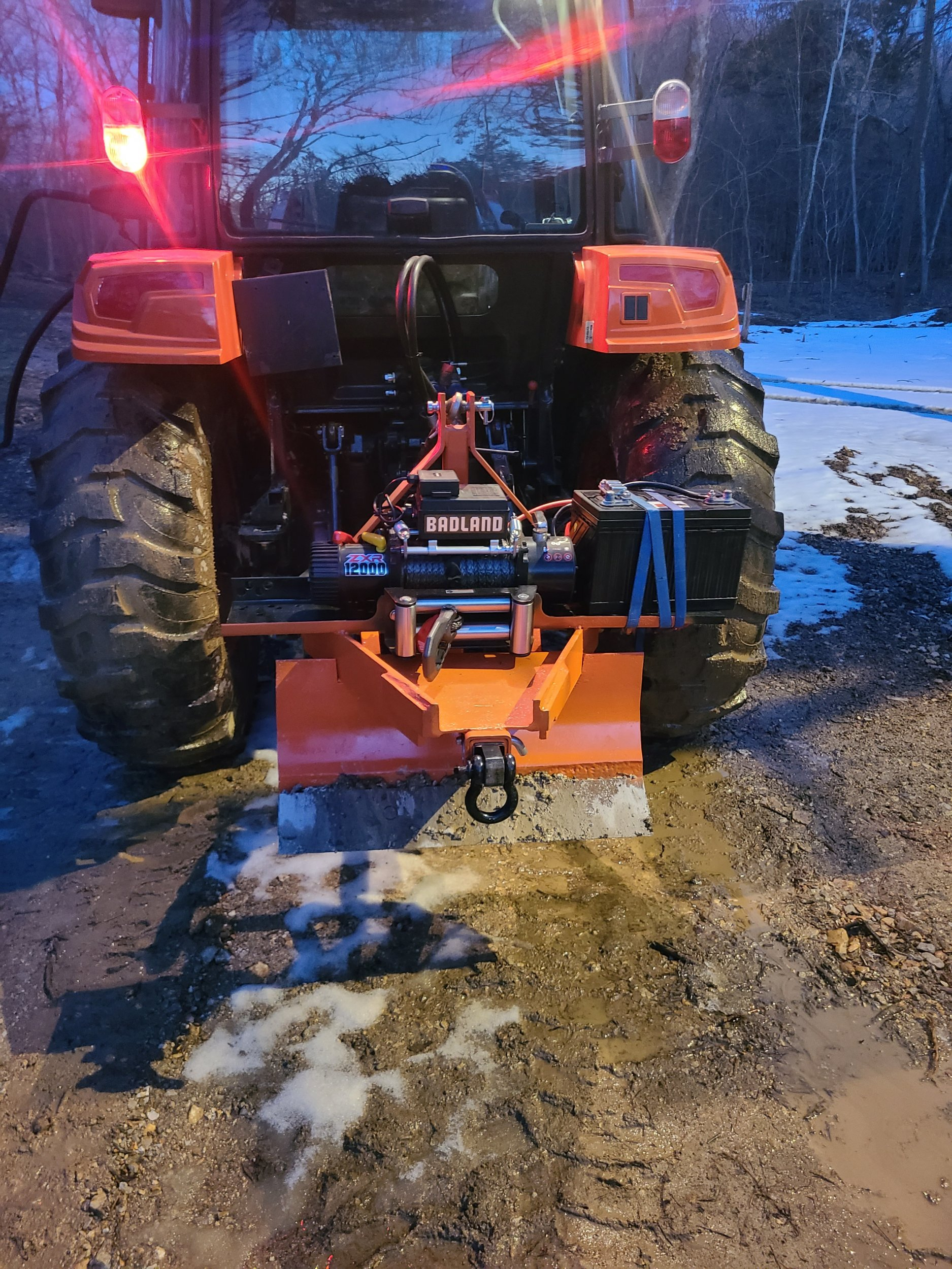

Does it make sense to attach a winch to a tractor to help act as a logger? I see HF has a 12k winch on sale and was thinking...
I don't have many logs to move, dozen or so, but they are on a slope I don't care to drive my tractor down. It is steep.

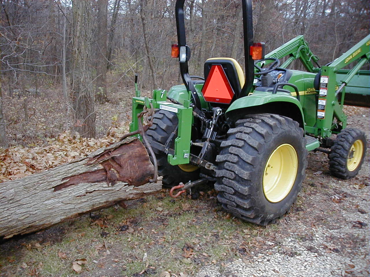

From a YouTube video on winching logs and such I made this up for my 3 pt. Had a large 30 inch log that I couldn't get traction due to soft soil layer and a slope. Took about 5 minutes to drag that oak log 50 feet. Used an old rear blade and cut it down to act as a holder in the ground.

With your tractor at the top of the slope, maybe use long straps/chains to tie onto the log. Then back up as far as you can, stabilize the log, re-set the strap/chain and back up again. Just keep doing that until the log is at the top.
I would pull from the rear. More pulling power, and wheel lugs are set for pulling forward, not backward.
Good to have a quick hitch on the 3 ph to hook to, for better traction as well.
Use a snatch block to help locate the position of the cable for the best pull.

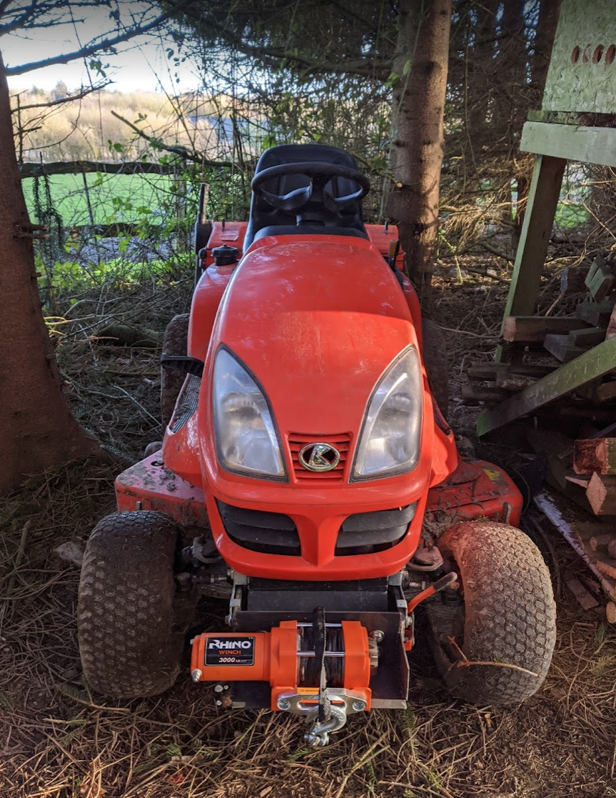

Not for quite the same purpose, but I installed a winch on the front of my Kubota ride on mower/lawn tractor. Despite the 4WD I kept getting stuck in the winter, and didn't have the tractor at time, so came up with this as a cheap way around it.
It doesn't get used for long periods of time so the power draw isn't a concern and it has got me out of a number of sticky situations - both for pulling the mower when it got stuck, and pulling logs and other heavy stuff. The winch was fairly cheap, about £100 (about $140 or so).

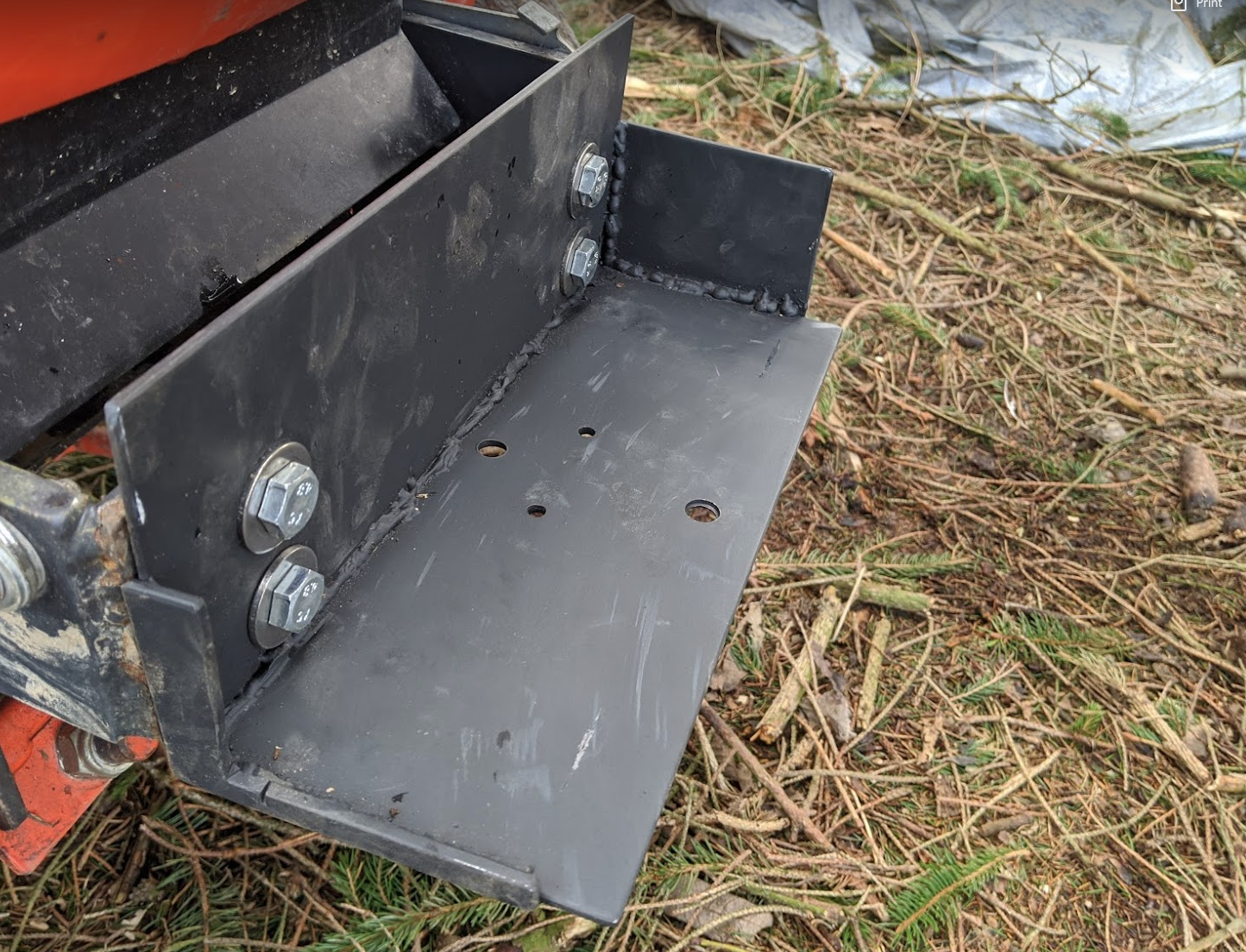

I fabricated the mount out of 3mm plate (excuse my welding!):
