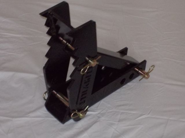

I bought a Linville 18" 'kit' for my Terramite. It has three use positions and can tuck away neatly when not needed. Adjustments and jaw/brace R & R easy removal by pulling three included HD hitch pins.
That said, I move rocks (up to FEL capacity) with a 48" FEL grapple vs using the BH thumb. Sizing jaw length to match/oppose bucket teeth was more 'close' than precise. I'm not going out in the cold, but have a pic from when I bought it. (~$200 or less) No regrets at all. :)

@theoldgrind thanks for that, they make many sizes. Now I just have to determine if it will fit on the stick. How did you mount it?

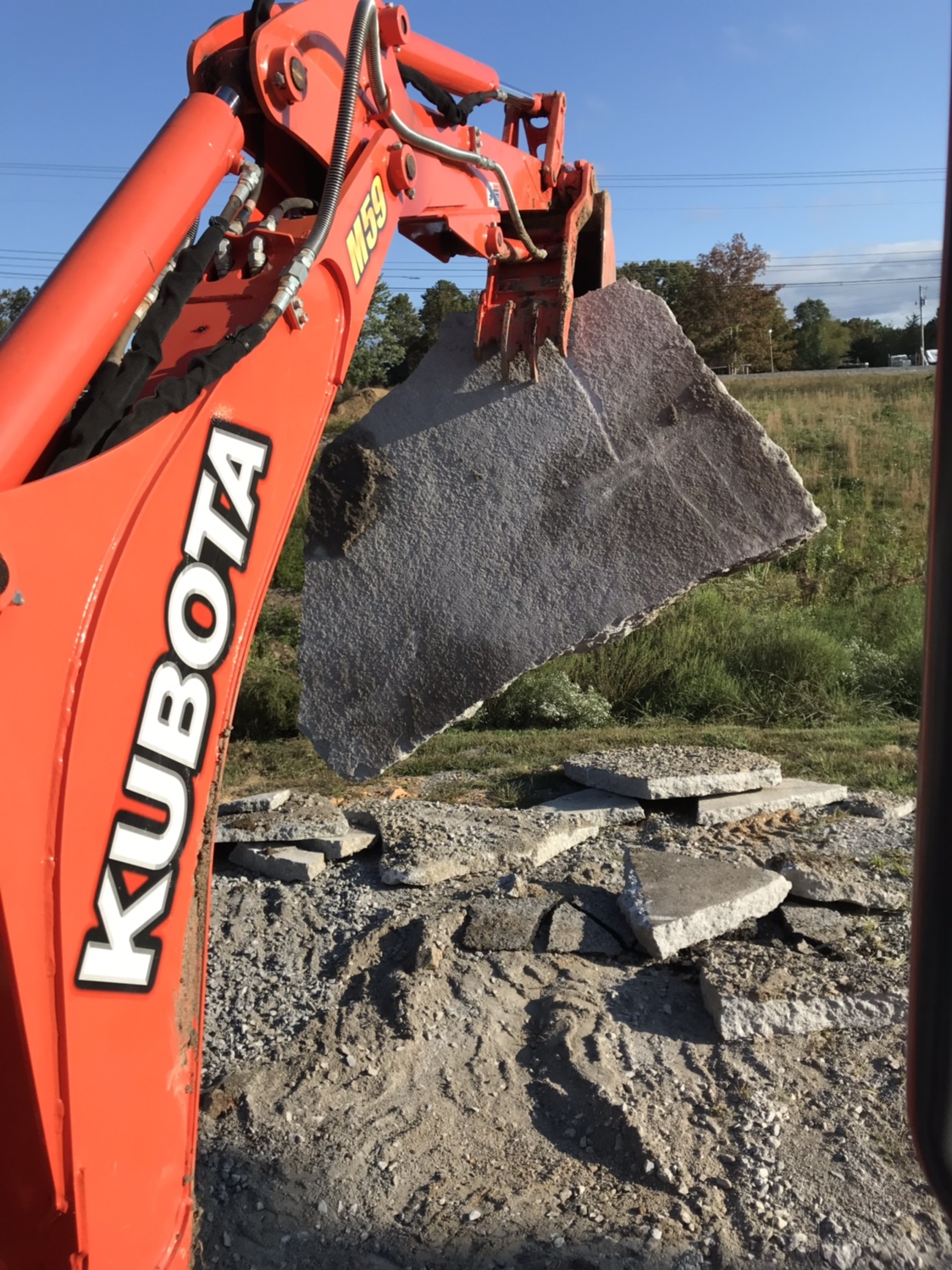

I have a hydraulic thumb on my backhoe and mini excavator. It literally doubles the usefulness. IMG_7646.JPG

Mechanical versus hydraulic thumb kind of depends on what you want to do with the backhoe. If you mostly want the ability to clamp on to something to move it to a new location then the mechanical one will be fine. If you see yourself picking up something - like a rock - so that you can place it carefully into position on top of a rock wall then that is better done with the hydraulic thumb.
I use the hydraulic thumb a lot because I do a lot of picking and placing rocks and logs for rock & log walls, to make neat edges or boundaries, or place rocks to walk on or for kids to climb on. It's kind of hard to explain the advantage of the hydraulic without actually showing it in motion...., but basically by using the hydraulic thumb I can keep pressure on the rock so that it is being held as the bucket uncurls. By holding onto the rock as I uncurl the bucket I gain another several eet of distance. And as the bucket uncurls, the side of the rock that was facing the operator when we transported the rock now becomes the bottom, so it is easy to place the rock exactly into position on top of others.
It's easier to go from a mechanical to a hydraulic thumb than from no thumb at all to a mechanical one, so if you want to break the project into two parts that makes sense.
