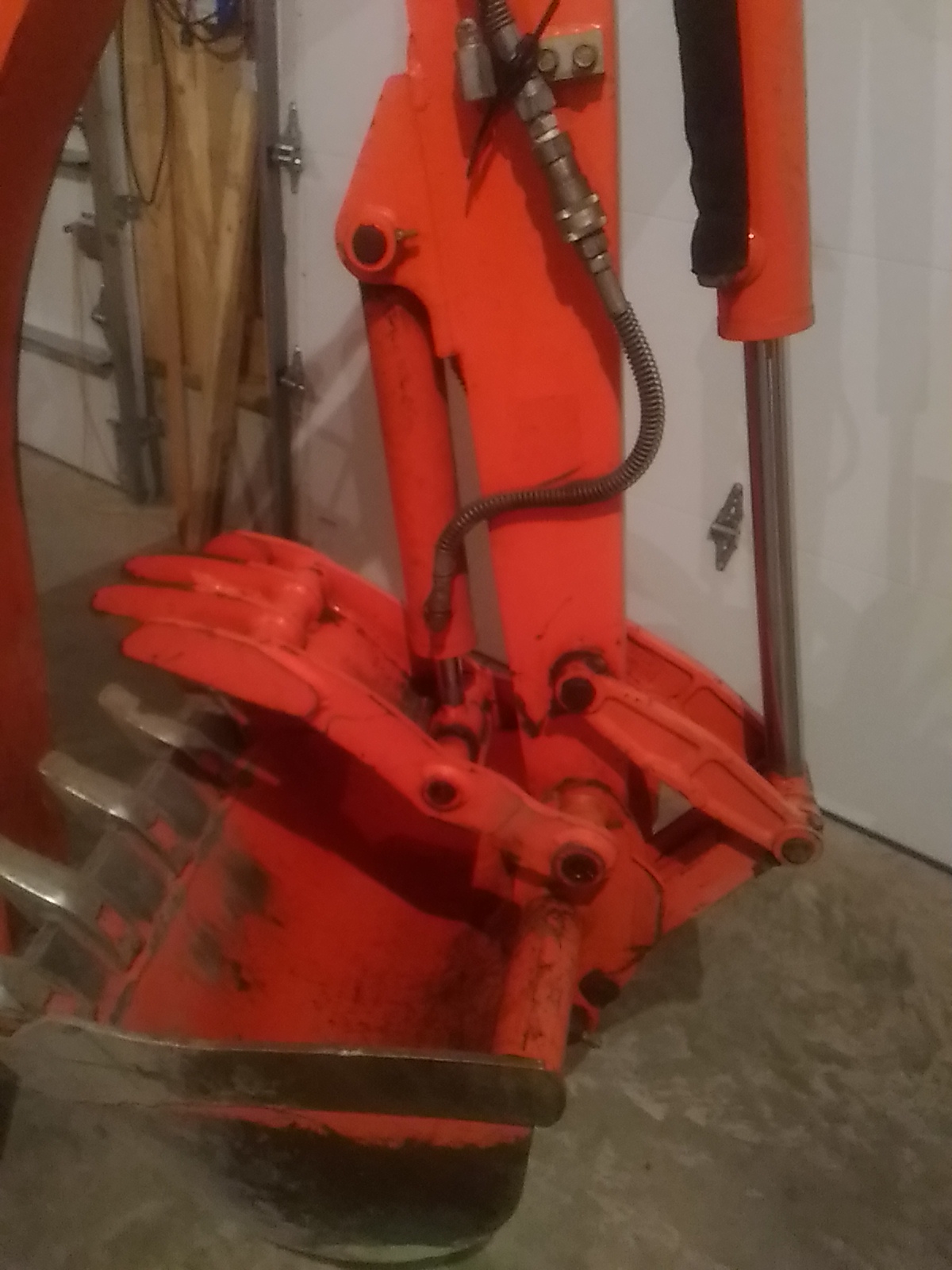

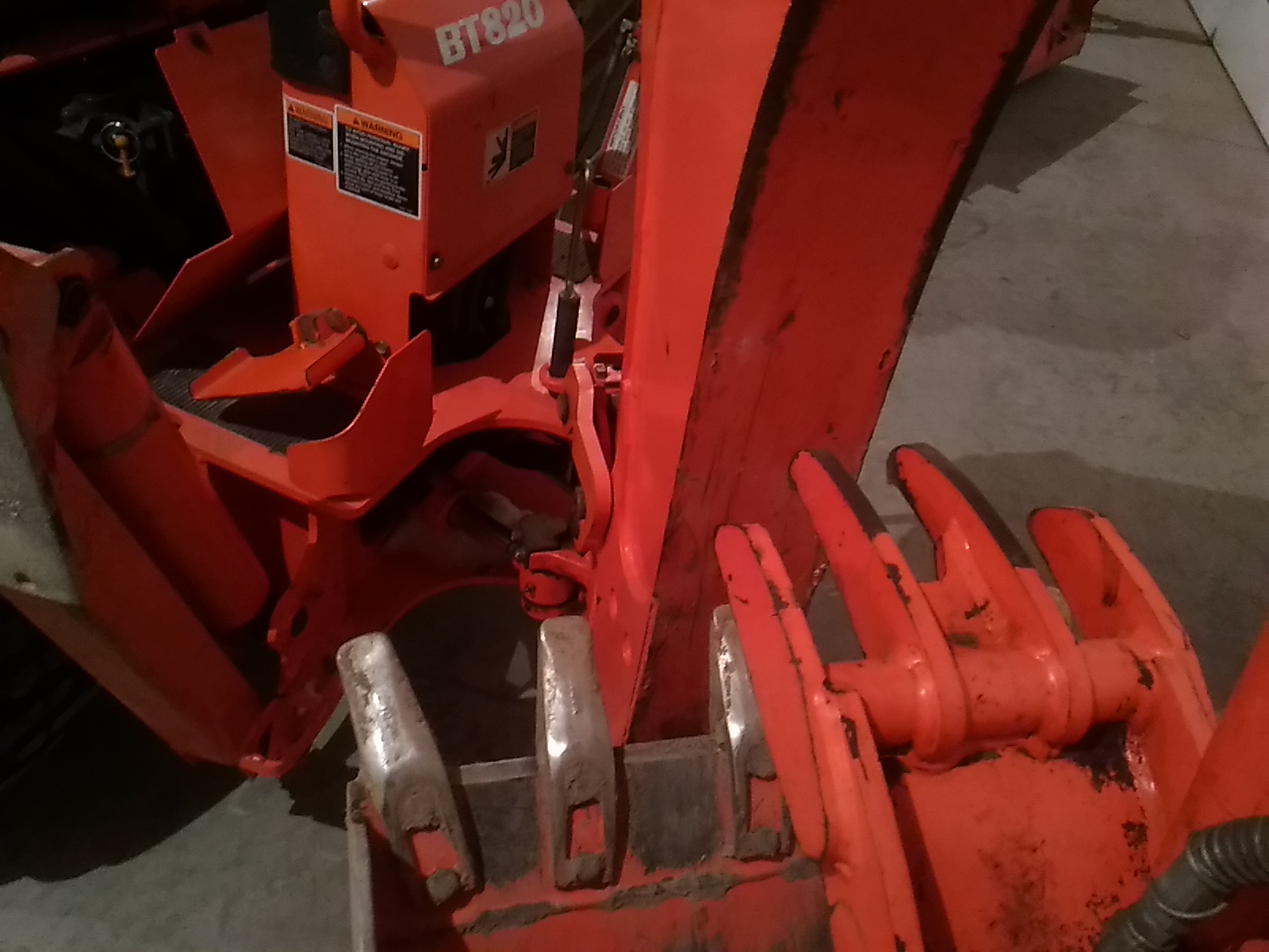

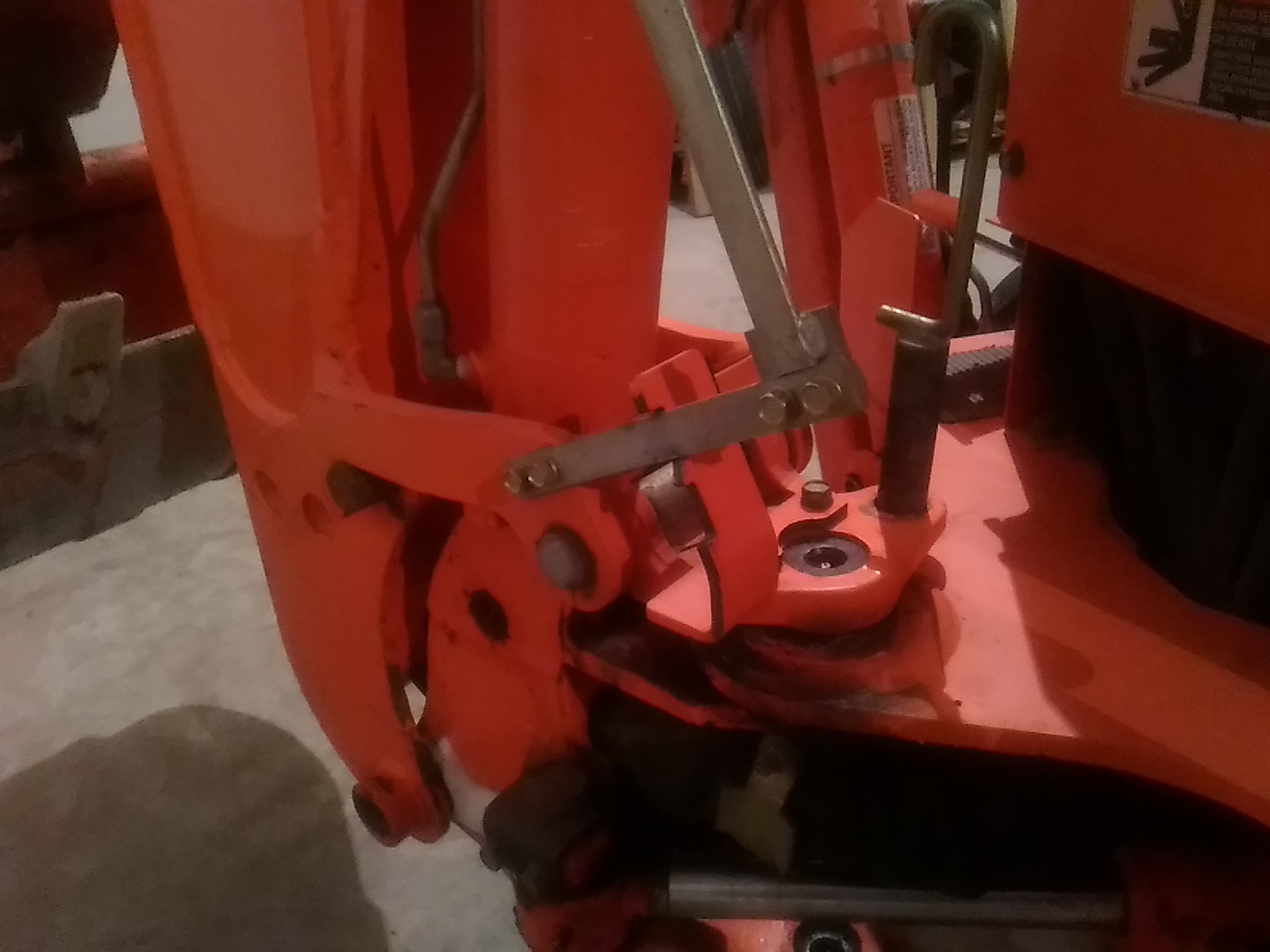

A little late to the discussion. I have a 2007 B26TLB with a hydraulic thumb. I assume from the factory as it was on the tractor when I bought it 3 years ago.
First picture shows the locking pin for rotation and the lever/bar system for the boom.
P_20210127_104931_LL.jpg View attachment 684546
The second and third pictures show the thumb and its hoses and the foot lever that controls the thumb.
Hopefully this is helps for the L47. Jon

The lever bar system is not on the L48.....maybe on the L47 ??
Peter315 can answer that.
The "Attachment 684546" does not work!
