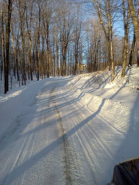

Your old B275 setup sounds like it was designed for dirt moving like a bulldozer blade. My set up lets me put the push beam from the Fisher plow at the same height as it was when mounted on the F250 it came off of.
I plow this hill with it. I use the split brakes to help steer around the corners where it banks the wrong way. Other then that I haven't had any problem with the snow pushing me sideways and I don't have any chains on the front.
