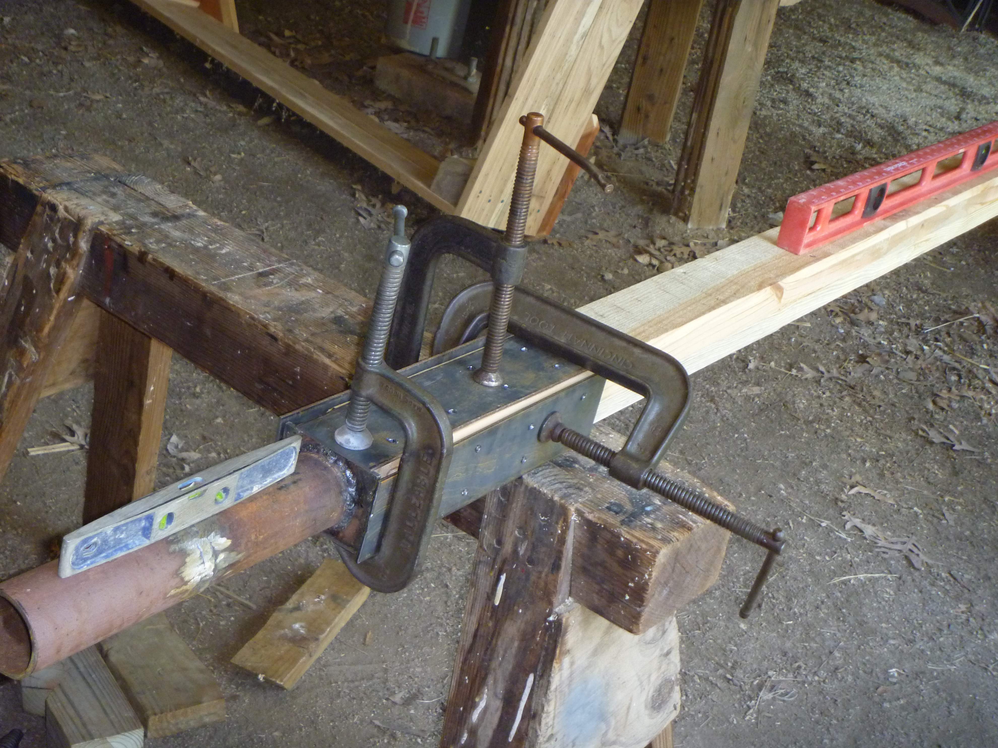

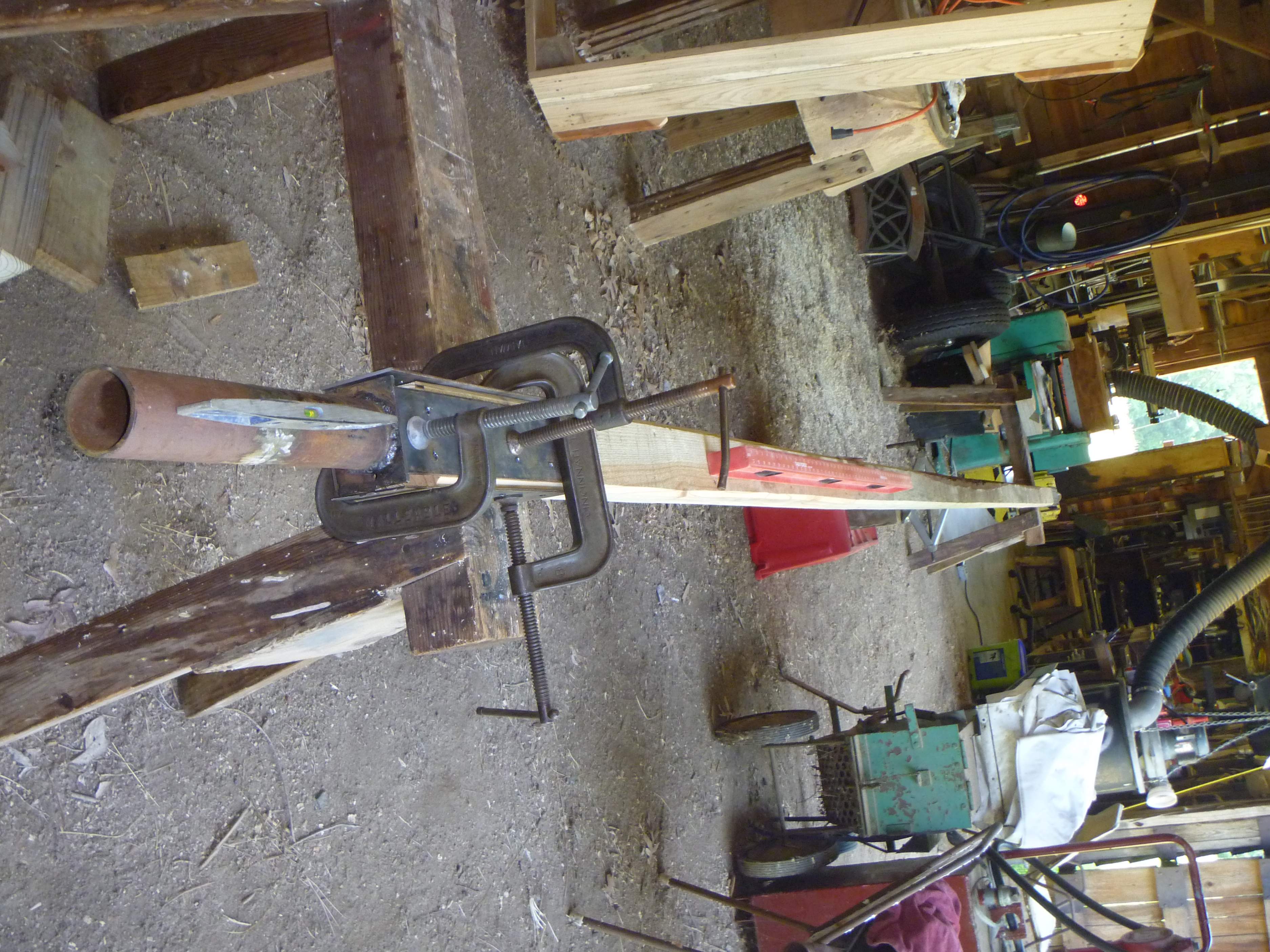

I made the beam to roll up the tarp out of 2 x 4s and mounted pipes at the ends as pivot points. I leveled the beams and the pipes prior to screwing the together.

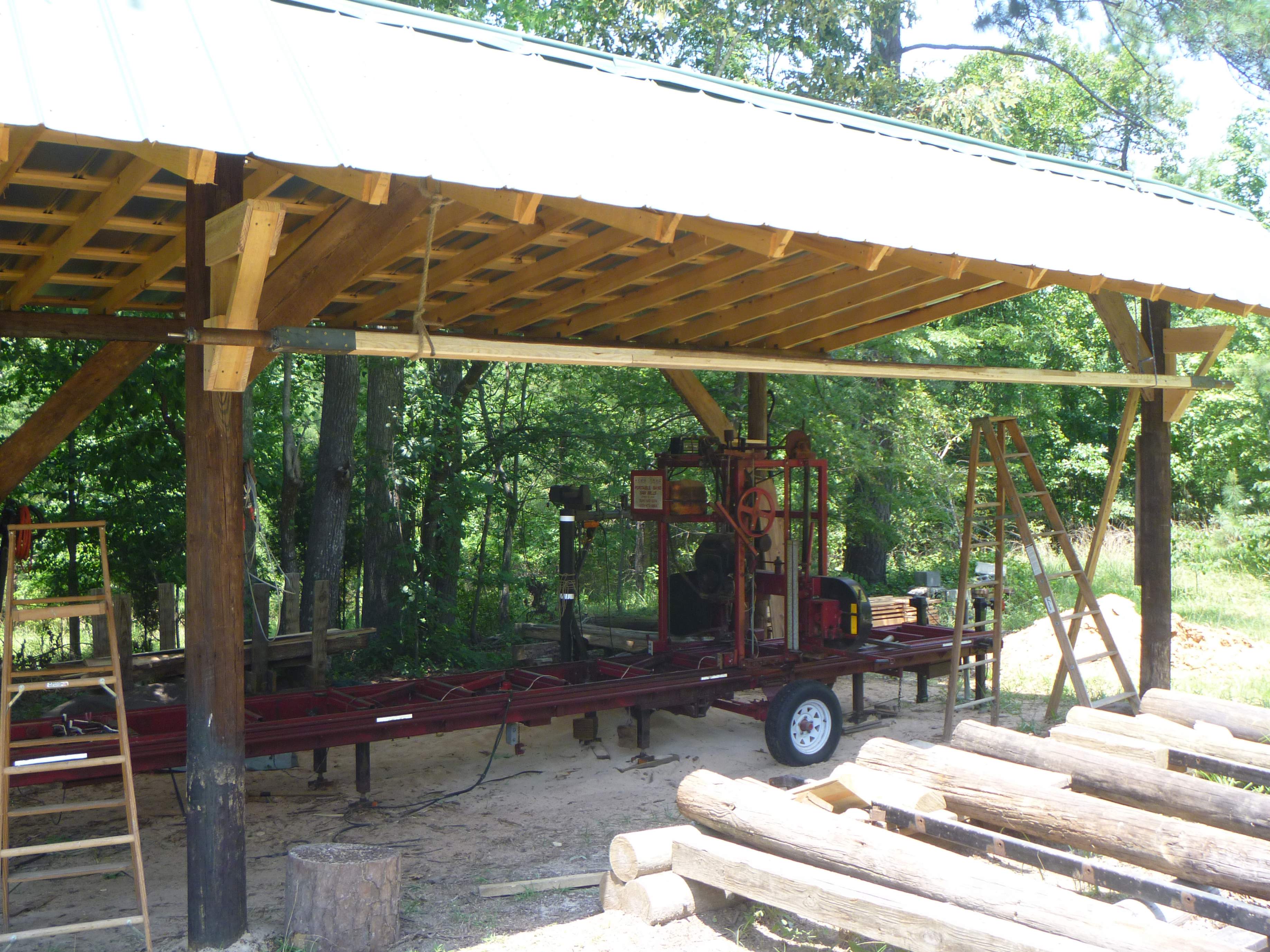

Here is the assembly hanging near to where it will be mounted.

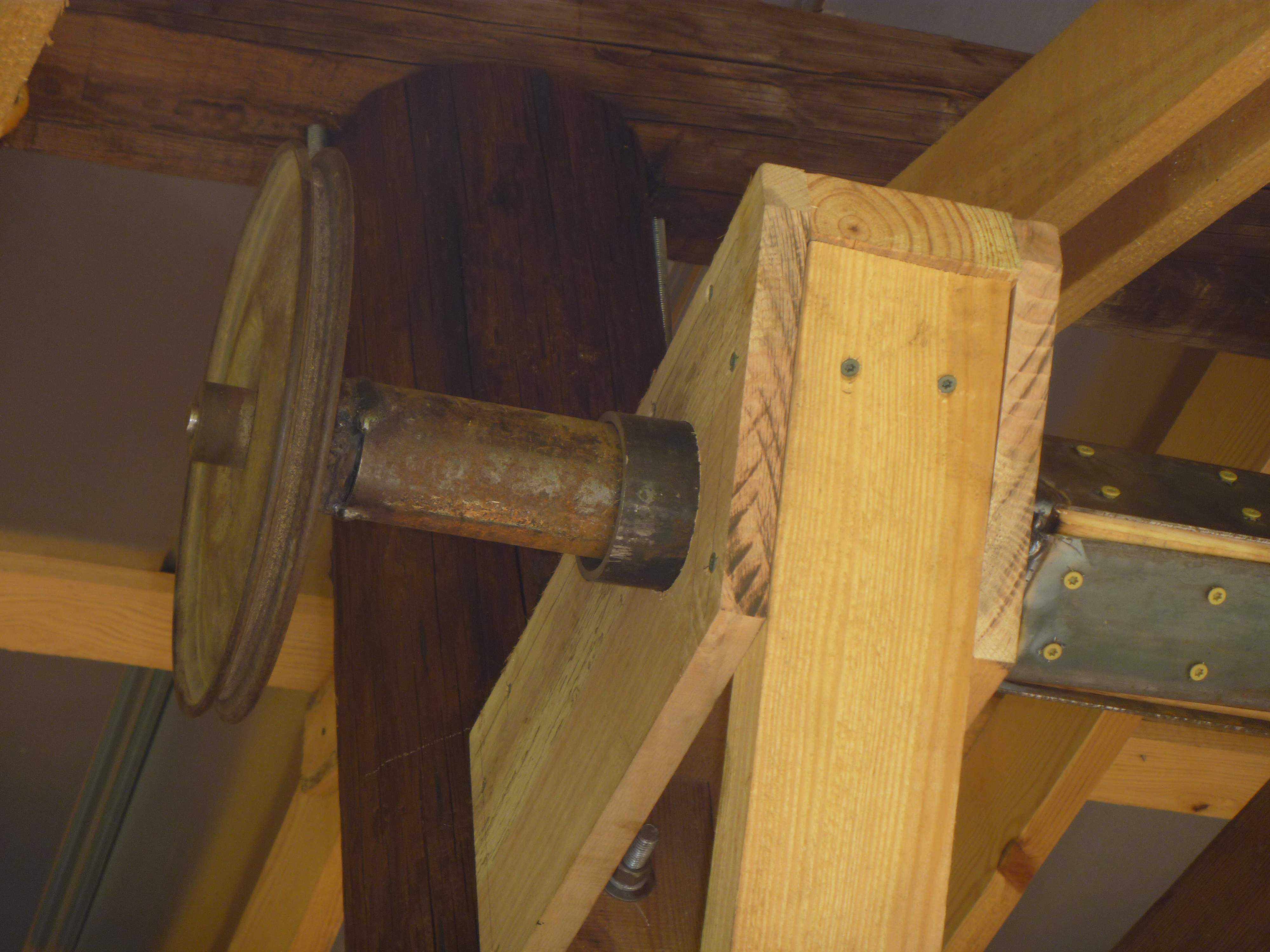

Closeup of the pivot point and wheel for rolling up the tarp

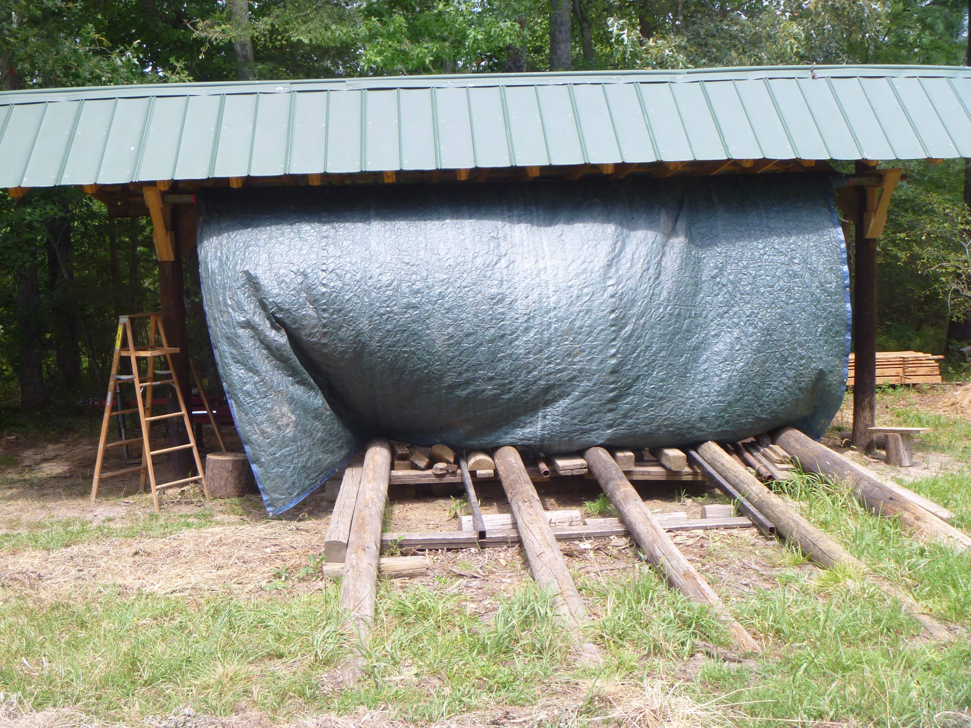

Tarp fully rollled up

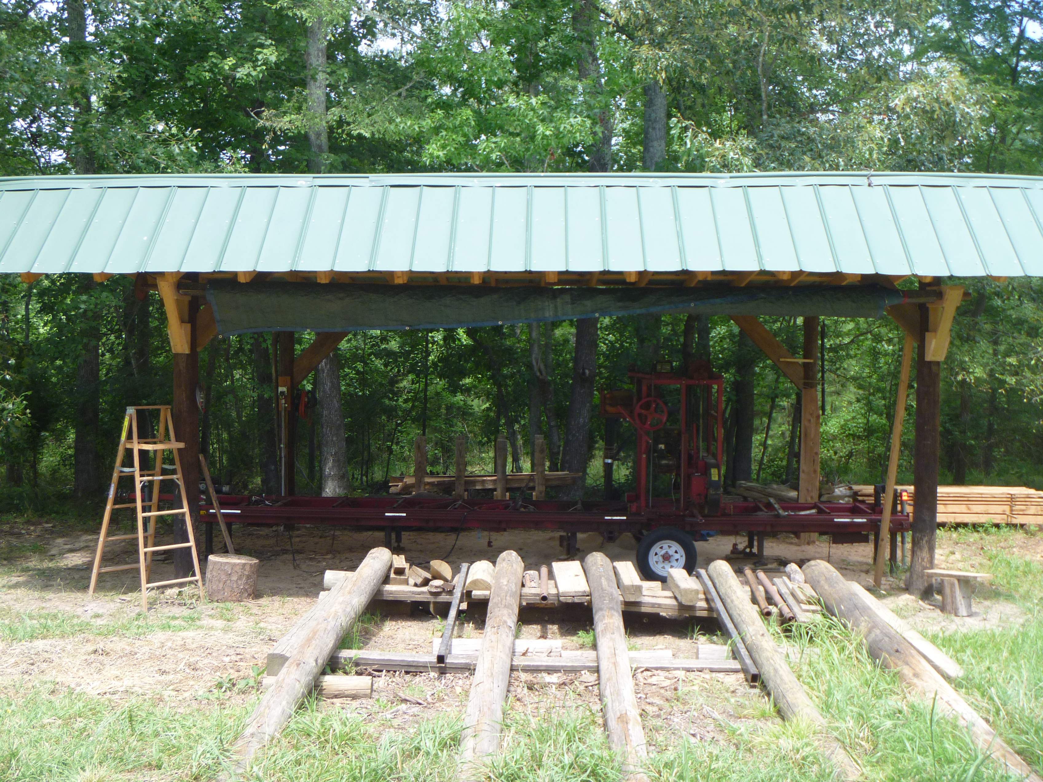

Tarp unrolled for shade. It is 30' long so it can cover the whole rollway.
All in all the project took about 20 hours. The only things that didn't go as planned were the kickback from a 3" hole saw:eek: and having to climb a ladder to turn the wheel/beam. There is a lot of wobble and slop in the rotating beam due to its weight so reeling it in and out is sloppy but I think it can be refined. Tarp does not roll up perfectly evenly but it does the job even if it won't win any awards at the Awning Convention:laughing:. Think of it as a stylish uneven hemline of a woman's dress.:laughing:
