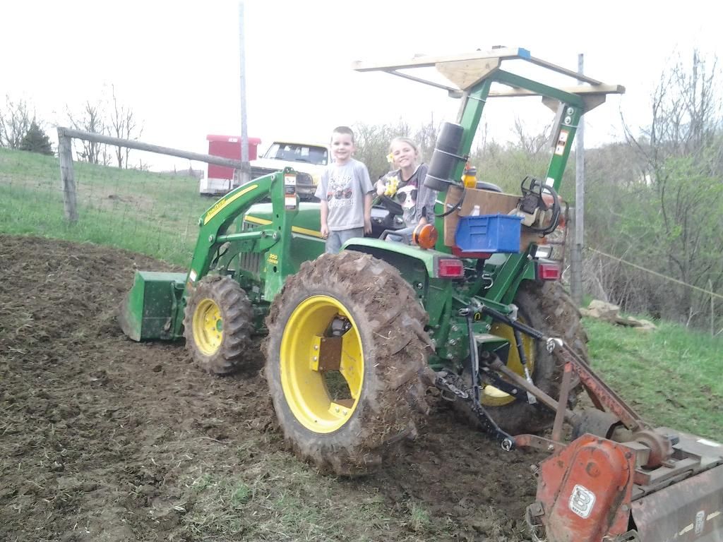

I do not have a cab on my tractor nor do I want one. However... I want a canopy/roll cage and will build one. I trust me engineering and fabrication skills dispite having no formal education in thoes areas, but years of hands on work and a solid dose of common sence goes a long way.
In the reasearch and development stage now... I have some scrap 2x4's and plywood as a canopy to get a feel for size and location in place. My father in law got a good laugh out of it the other day. It looks really cobbled... but is searving it perpous, providing shade for current use, and allowing me to get used to an object above me to crack my head on while mounting/dismounting. It took me an hour and a half to make and cost me $0. Info value? Huge... I know exactly how much steel tube it will take, with very little waste.
Currently it might look like CCWken's ford.... but it's a work in progress, and not indicative if my skills or quality standards... but one might think so based on one single photo of current state.
OP... if you are up to the fab work and fully understand the multiple aspects of adding a/c to a home built cab... go for it! But if time and money are such that a factory cab tractor is an option, factory fit and finish is hard to compete with...
If you do this yourself... document and share with us please!
Edit: added photo. I've added plywood to canopy after photo taken. Nice to have shade.
