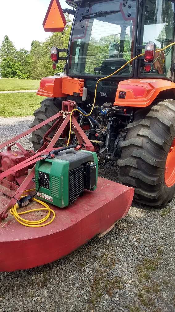

I use this little coleman with my pole saw strapped to pallet forks. I have a wireless remote on/off from amazon to turn it on. If you look closely, you can see the box plugged into the outlet. cost me $11.
It's went up a little in price, but works nonetheless.
https://www.amazon.com/Wireless-Fosmon-Electrical-Weatherproof-Included/dp/B072F9DGRL/ref=sr_1_3?crid=1MYOYLJX5X7FL&keywords=remote+receptacle&qid=1566235156&s=gateway&sprefix=remote+rece%2Caps%2C209&sr=8-3

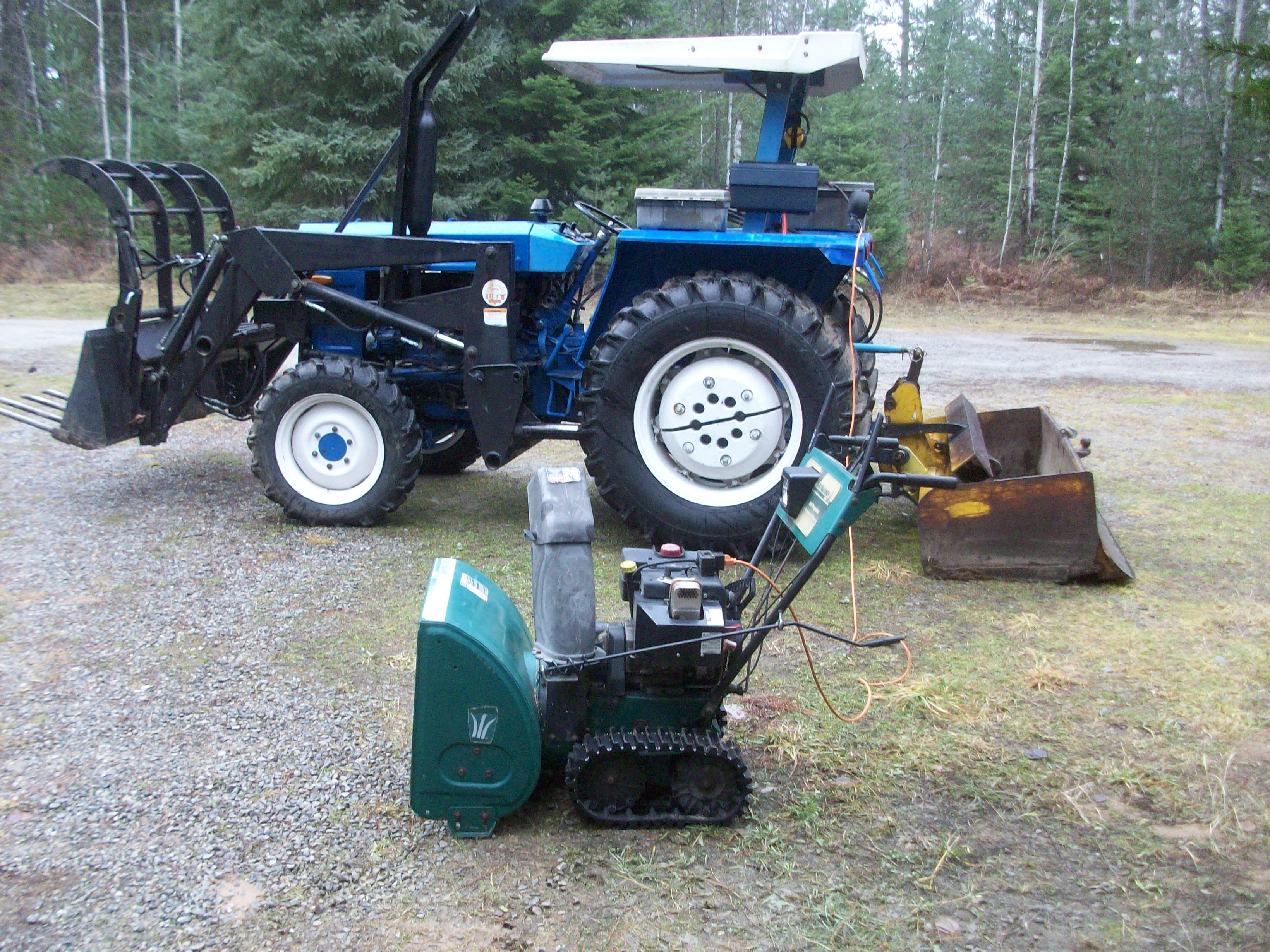

so does an Inverter- been using HF 2000 watt 4000 surge with their tree saw for years with no problems.
Also tested it to start a 10 hp snow blower for another members project.
