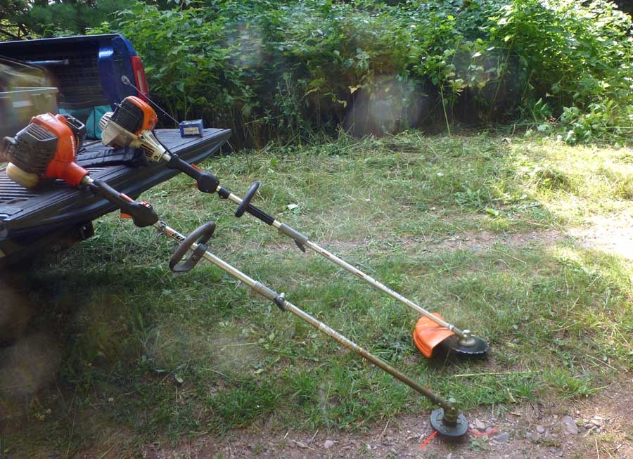

No matter what you think of its 2-4 stroke power plant, they have lots of other features we like over the Echo and Honda's we used and owned over the years.

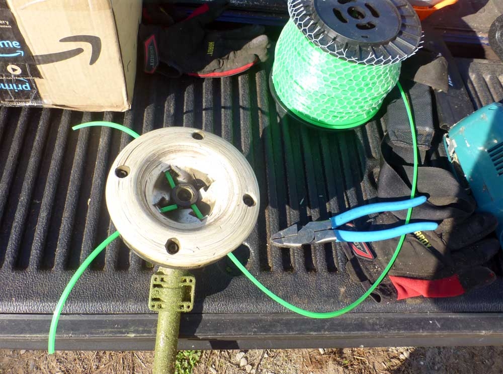

I never seemed to be able to restring the bump head without the stuff getting bound up inside so I changed to one of these heads. Using .155 line (same as the Cub big wheel trimmer uses) it lasts for a LOOONG time and really works great on the heavier vegetation that I use the gas trimmer for. While it is not a bump and go head it only take a moment to replace the line.

155 string is great to use but tough any trees, bushes or a house you like.

No matter what you think of its 2-4 stroke power plant, they have lots of other features we like over the Echo and Honda's we used and owned over the years. View attachment 3582206
Like what? Haven't really used the Kombi setup.

I have a thread about the Stihl and its kombi setup which we like better than the Echo. I can't find it at this time so please allow me some time..

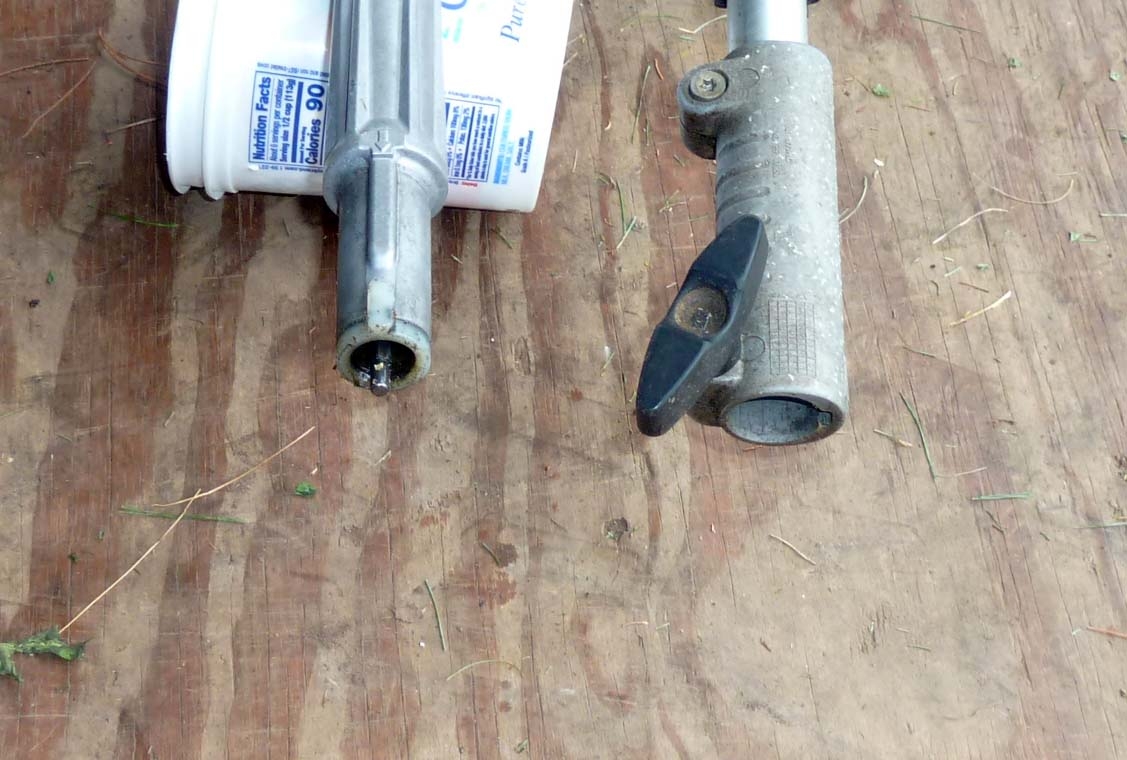

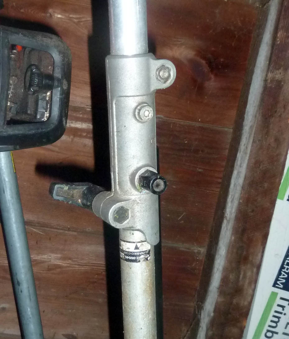

In response to the better connection system that Stihl uses, compared to the Echo. Below is Echo's that using a pin. The camp will not compress the connector onto the tools shaft. It stays slightly lose and its lock pin is harder to get tools on/off. Have broke them.

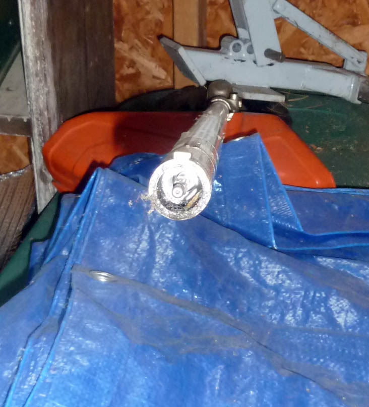

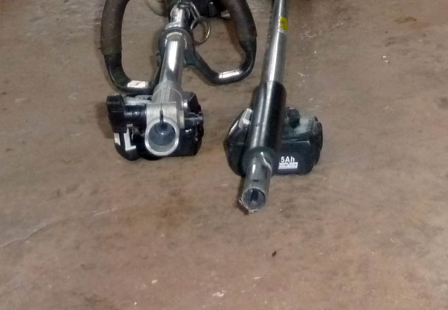

Below is Stihl's Kombi system. They use key and keyway system to keep it from spinning, then the camp does compress onto the tools shaft. These are much easier to get on/off and the drive shafts ends are designed differently and goes together better.
