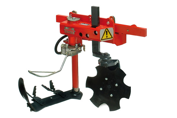

JJ - Thanks for the answers. The unit I'm looking at is the following.... Clemens GmbH & Co. KG | Weinbautechnik - Kellereitechnik - Tankbau . It is a mechanical weeder that uses a hydraulic valve with a trip arm to retract and divert flow to a no-pressure return to sump. It seems that your second suggestion would work with a Tee inline of one SCV and uses needle valve to adjust flow to the new line and thus the mechanical weeder. Is the mechanism by which the flow is regulated significantly different between the needle valve you suggest and the flow controller suggested by vendor? If not I can see where a Tee and needle valve would be easier to site on the tractor.......Thank you, Gary

I looked at the weeder and can't tell what they are using the hydraulic flow for. Is it a motor?
Answers to your questions:
1- I would mount it on the weeder. I think Clemens should have it built in to the weeder.
2- No! use hydraulic fittings only!
3- You will not be cutting the line, and you can't use a tee.
Oil flow takes the path of least resistance.
4- Has been answered.
Your flow will come from plugging the hoses from the weeder into one of the 3 SCVs on the tractor.
Does one of the valves have a detent so it will stay on? If not you will have to rig a mechanical latch to hold it open.
I recommend you contact a local hydraulic shop to get it connected right.

Seems to me you must first find out what type of hydraulic system the weeder is set up for: open or closed (there are other names, but these are perhaps the most common). Put differently, is the weeder valve set up to allow flow through it back to the sump all the time except when it is activated by the sensor to swing the plow around the vine (an "open" system) or is the weeder valve set up to block flow from the source (on the tractor) returning to the sump until the sensor touches the vine, at which time the valve opens to allow flow through the swing mechanism and then back to the sump?
Then, assuming the weeder hydraulic system is the same type (open or closed) as the hydraulic system on your tractor (or can be made the same type by changing the configuration of the valve), you can better determine what type of flow control (if any) will work best.
Look forward to hearing from you.

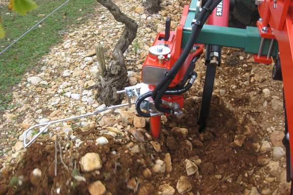

This is the weeder.
I wonder if it uses a rotary actuator?

It appears to be served by two hoses, so it could be set up as either a closed center valve or the last valve in an open center system.

Thanks for the replies. Have been away for a couple of days. I think I was over-thinking the solution by trying to cut into the SCV line delivering the lower flow while still retaining use of the SCV. However, after thinking about the solution a bit and XFaxman's suggestion of mounting to the weeding unit that solution makes very good sense. The unit then becomes easily to use on other tractors(mine and others). Since I'm leaning towards a 3 pt hitch tool bar mount the Prince flow control valve mentioned earlier would be easy to mount on the tool bar with the weeder. Agree with other posts that suggest the flow control unit be placed with the unit. Eventhough I mentioned the Clemens there is another unit(Braun LUV Perfekt) that competes favorable with it and maybe lower cost. Someone had questioned the valve function( hydraulic flow path when weed knife is extended vs retracted). I think this is where the Clemens and Braun are opposites in that one has flow through to sump while the other has flow pressure on valve when knife is extended and then reversed when retracted. The following are video links.
