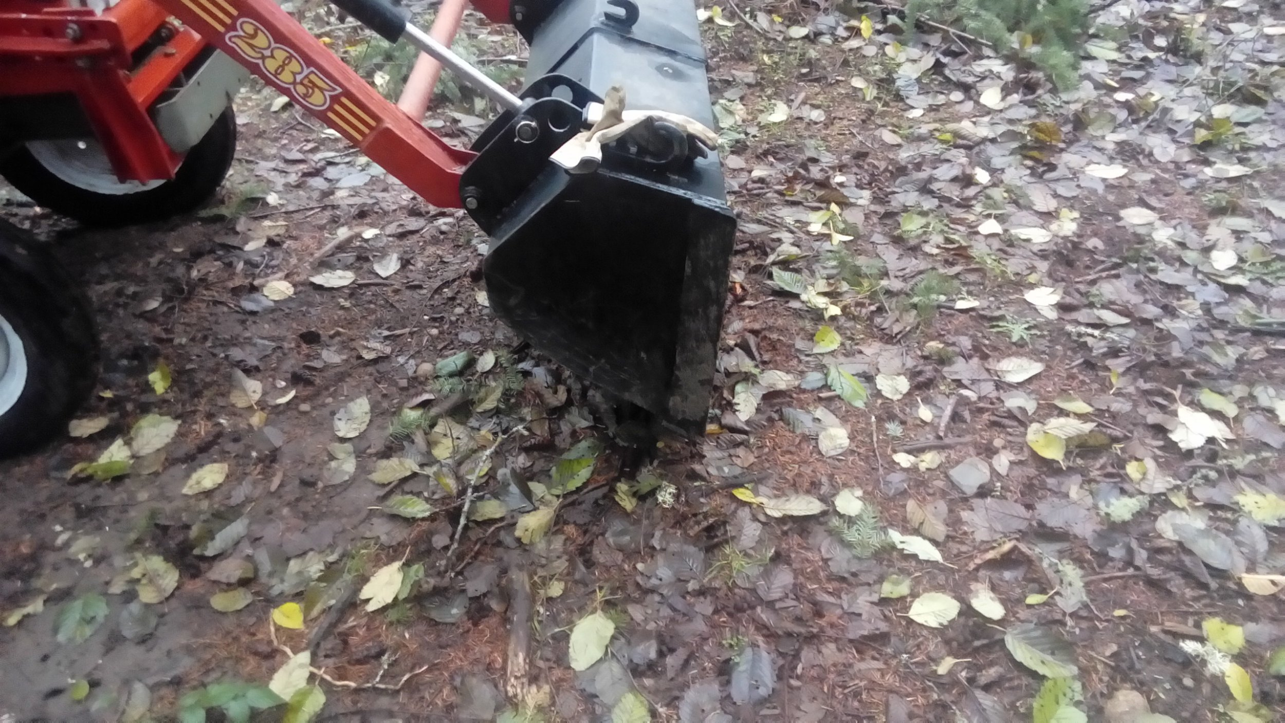

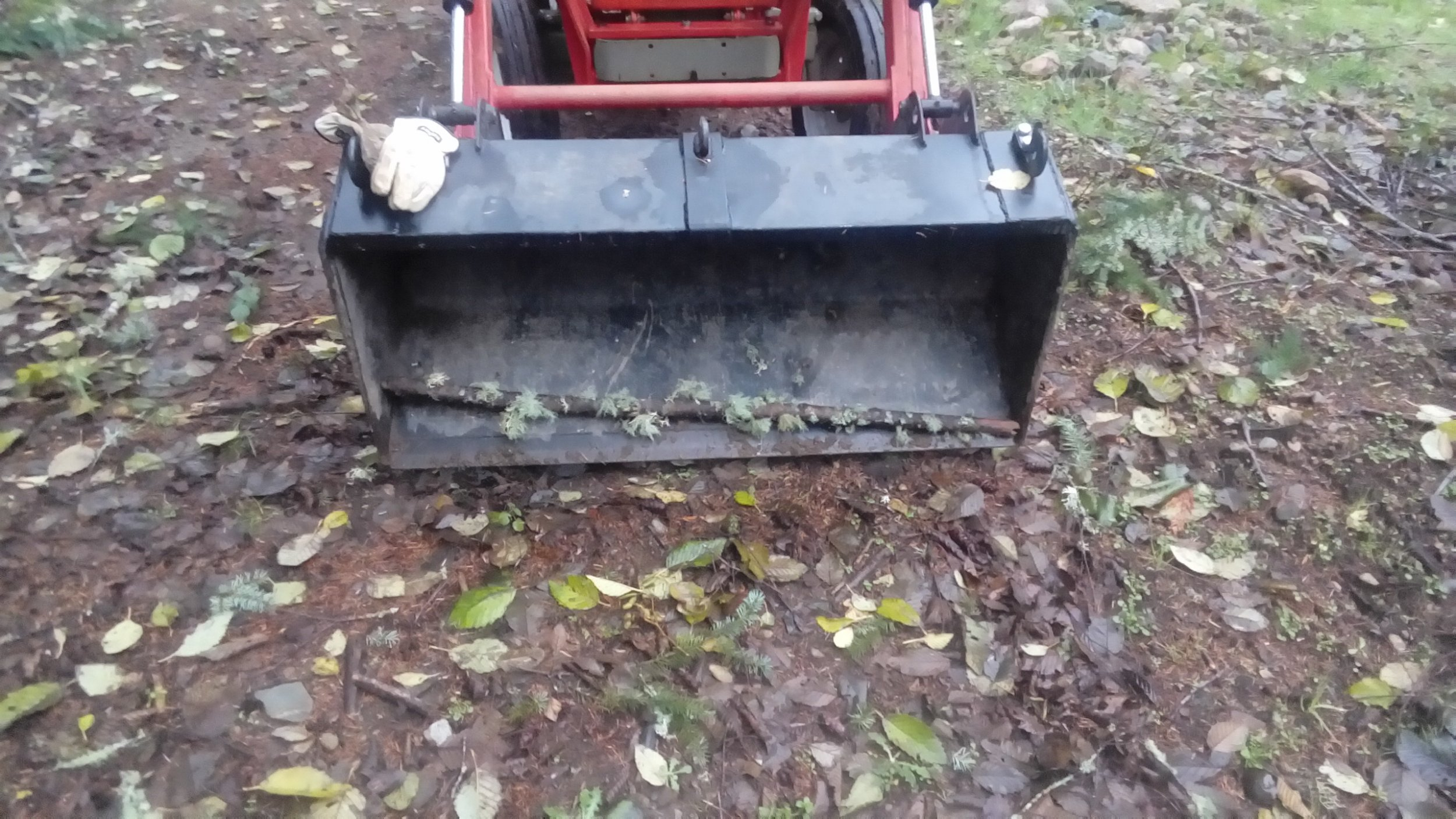

I didn't want to start my tractor today just to raise the bucket. But I think these two pictures will show the small size and shape of the bucket. And just to reiterate, this extension is just to add capacity for bulky but relatively lightweight vegetative material. I have a lot of it every winter.
I am a 65 year old guy with 20 year old crushed wrists injuries. Bone on bone joints in both wrists. I get by but tractors help. I was using my Case 580CK backhoe for this type of work, loading stuff into the front bucket, along with my wife, she is no slacker, but the Case is big and long. My new to me 40 year old YM2310 is a great machine. But the FEL bucket is so small. Loaded with sand or rocks it is the correct size, loaded with pine branches from the latest blow it is woefully undersized. So I want a bigger front bucket that I can dump.
I appreciate the suggestions about forks et al. But I don't want to use forks. I have them. Stuff falls through them. I am not picking this stuff up with the tractor because of what needs to be picked up. I am loading by hand. All sorts of sizes in all sorts of places. Lots of the branches are too long for the bucket and get sawn shorter. Much of the stuff is already short enough to fit. When clearing salmon berry and blackberry bushes they often need to be compressed into whatever we are using to transport them to the burn pile. A big bucket, like the one on my Case, is good for this. But I'm not gonna use the Case because I have the much smaller and more maneuverable Yanmar YM2310. Hence the bucket extension question.

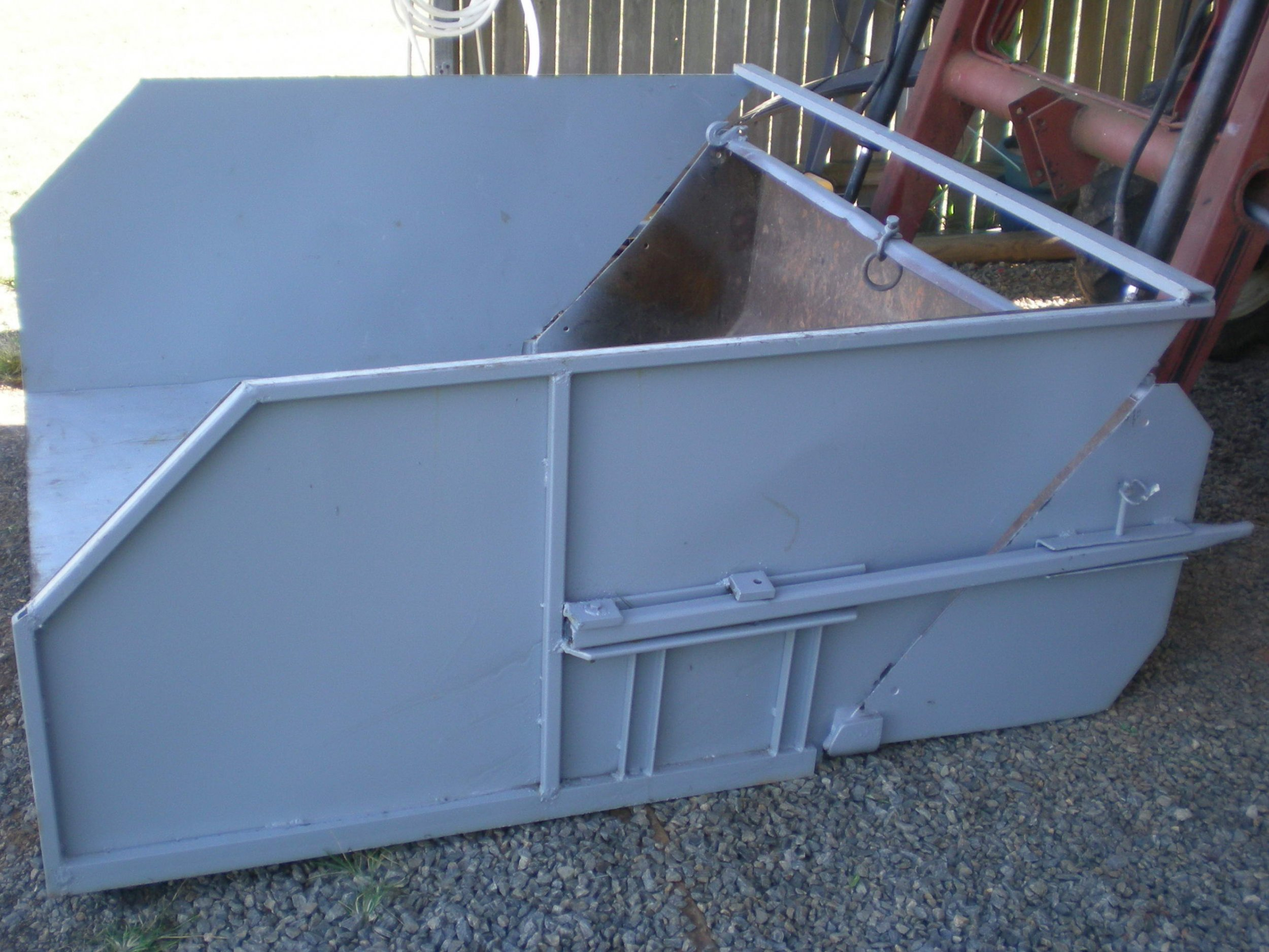

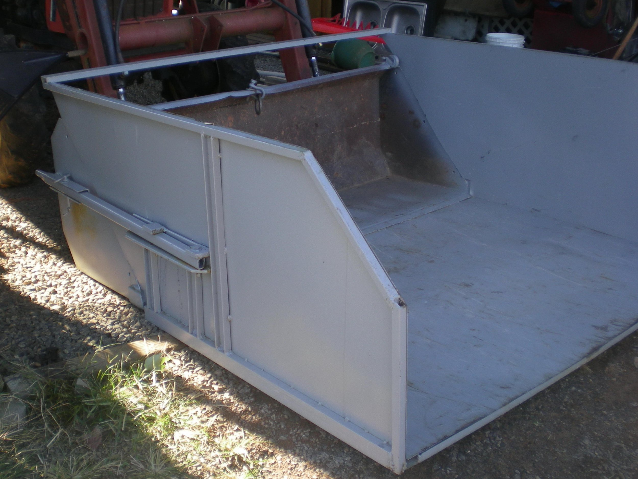

From HollyRidge campground that we go to... used for leaves and sticks. Only thing attached to the bucket at the angle iron on the sides.

That's bigger than I want but I like the design. I'm gonna copy it. Sort of. The open top would really let me pile up the bushy stuff. And it can be easily dumped.

So I think the main side bars, swing out from the one bolt that holds it on. Look at the bottom lip of the bucket, the outside edge catches on the inside and may (?) supports some weight from tilting forward.

I will post pictures. The front lip will for sure need to fit into a slot to help support the weight. I want my extension sides to butt against the existing bucket. Then I think I will run a bar on each side of the extension to the hooks I have on the top of the bucket at the sides for clamping to the bucket. The bars would run from the front of the extension to the hooks. No, I have a better idea, instead of bars I'll use chain binders. I'm not sure yet how to pull the bottom of the extension tight against the front lip of the bucket, maybe use a chain that wraps around the bottom of the bucket and connects to the center hook welded to the top of the bucket.
