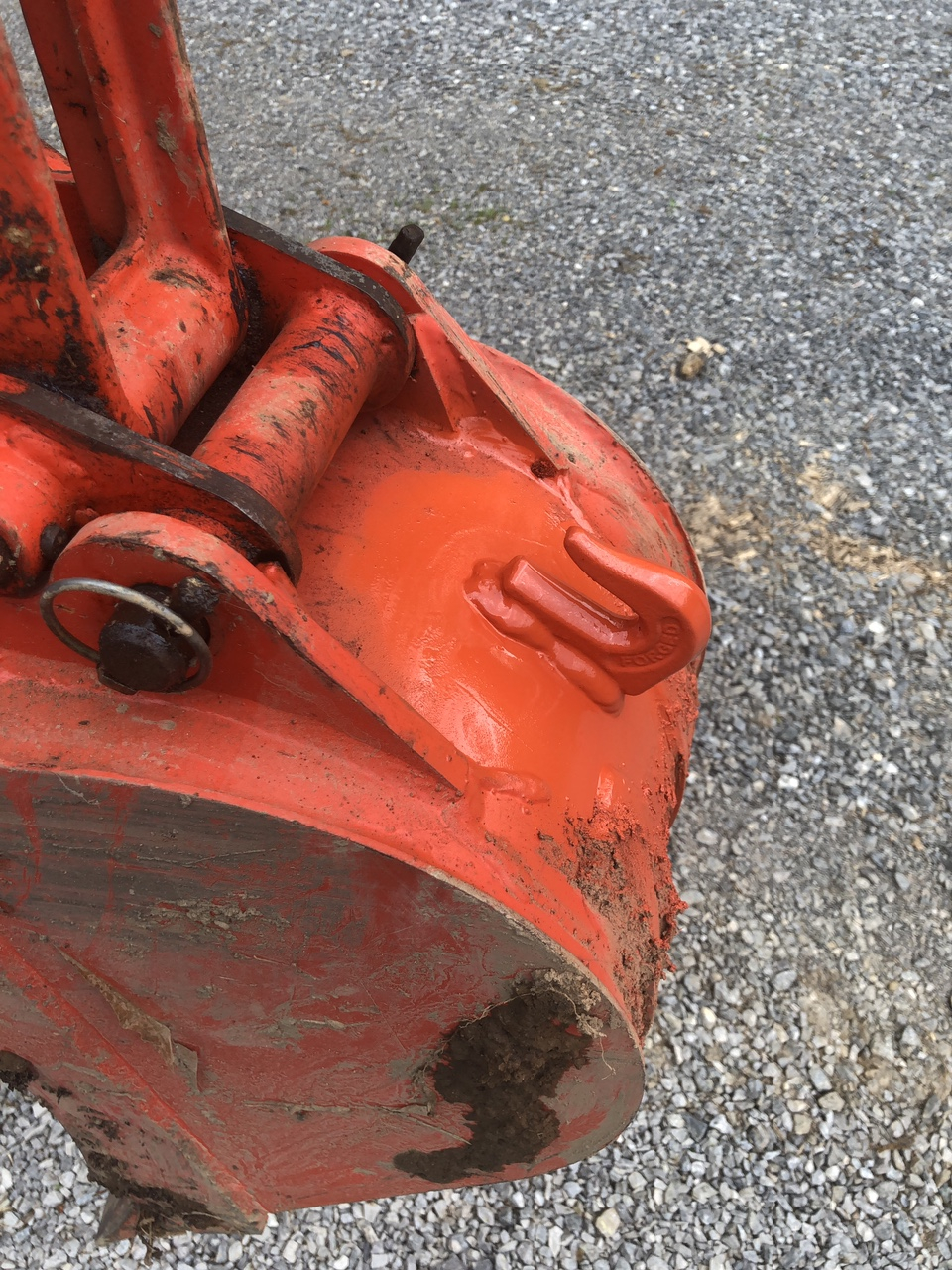

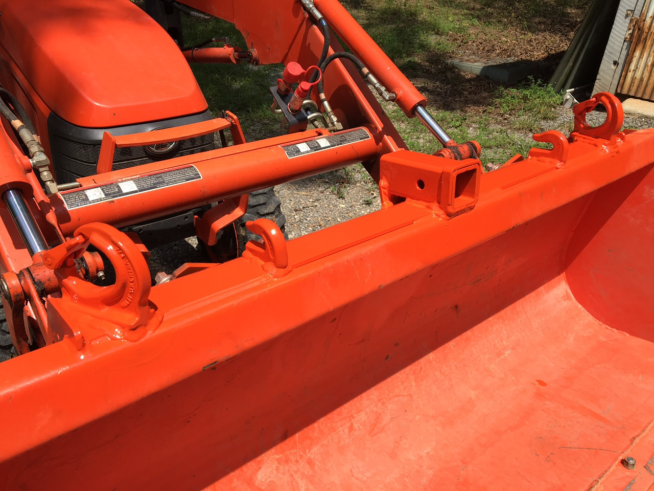

I did three on mine, as well. Two on ends are used with a 10' loop of 5/16" choker chain for lifting whole logs, or when my approach to something that needs to come from one side or the other. The one in the middle is used for pretty much everything else.
You could run a slack chain between the two side hooks, if you were lacking a middle hook, but it multiplies the side force on the side hooks, by the angle of your dangle.

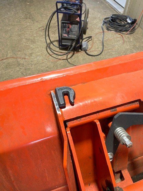

Don't laugh at my welds, these were done blind with flux core, before I had my MIG set up with proper gas.
When I first started welding I told my uncle that I couldn't draw a very good bead and he said, "That's what they make angle grinder for." I'm a lot better now but still need the angle grinder on some of them.

Pros or cons to adding the bolt on hooks?

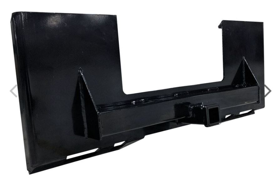

I added bolt on hooks at the outside edges of the top and welded up a 2 inch receiver that bolts to the tractor frame for spotting a trailer or heavy pulls. The pull is more in line with the axles. Too easy to bend the top of the bucket with a center hook.
   / Adding grab hooks on front bucket, 2 or 3 hooks? #52
I bought some bolt on hooks from Amazon. They come with reinforcing plates and bolts. I am currently deciding where to locate them on the tractor bucket.

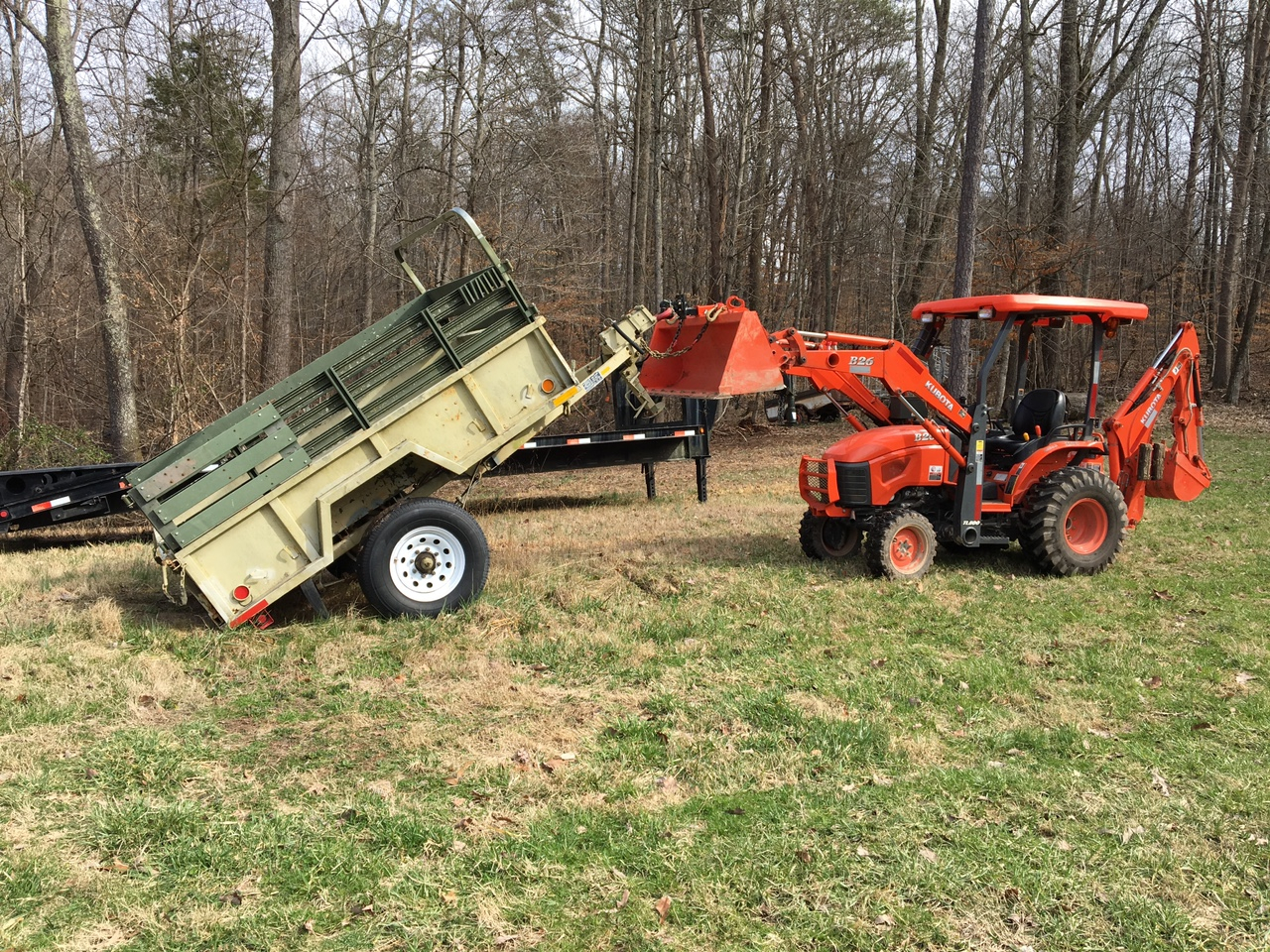

I had my Terex 640 14 yrs using the hooks the same way, even lifting the rear off the ground many times against a chained load. Very heavy 14k pound tractor - no hook problems.
