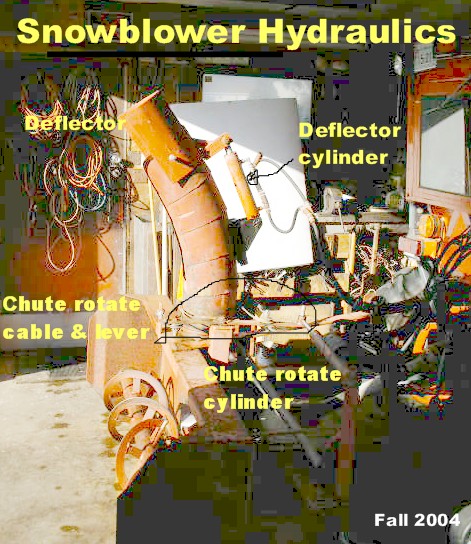

The attached shows how my hydraulic operated deflector works. A very simple setup.

I would highly recommend the hydraulic deflector. I have one on my Meteor blower and use it all the time.

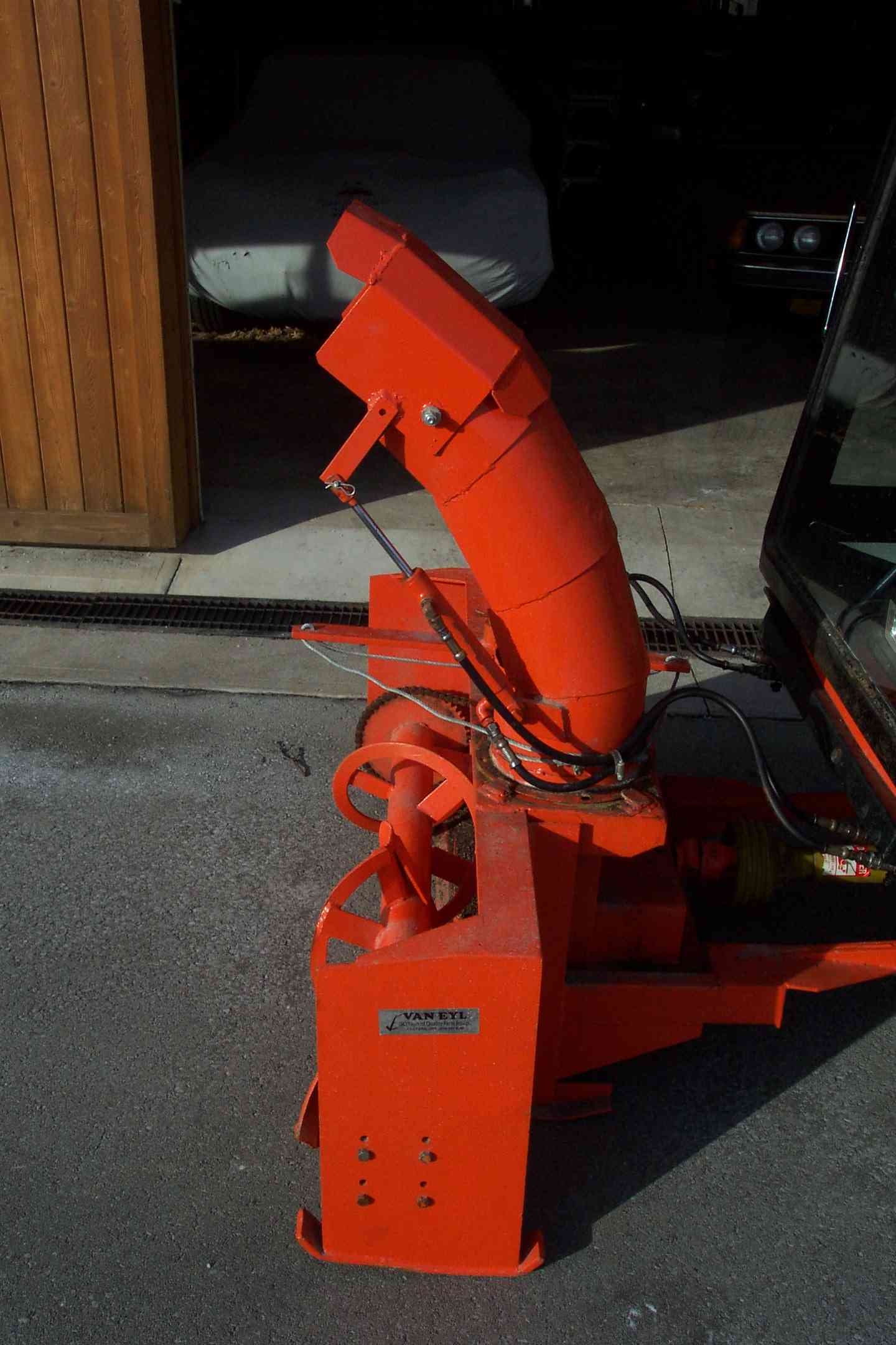

You will appreciate the hydraulic deflector, especially in tight quarters. I built mine from scratch.

This is my set-up. I install swivels on chute elevation to avoid twisting the hydraulic hoses.
