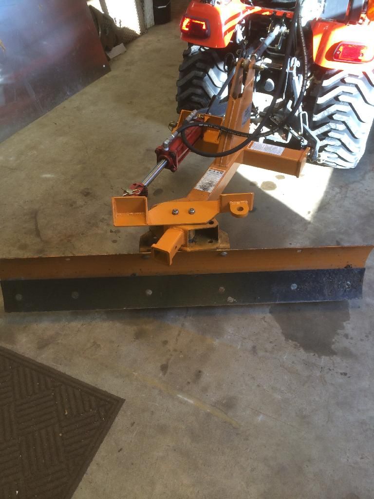

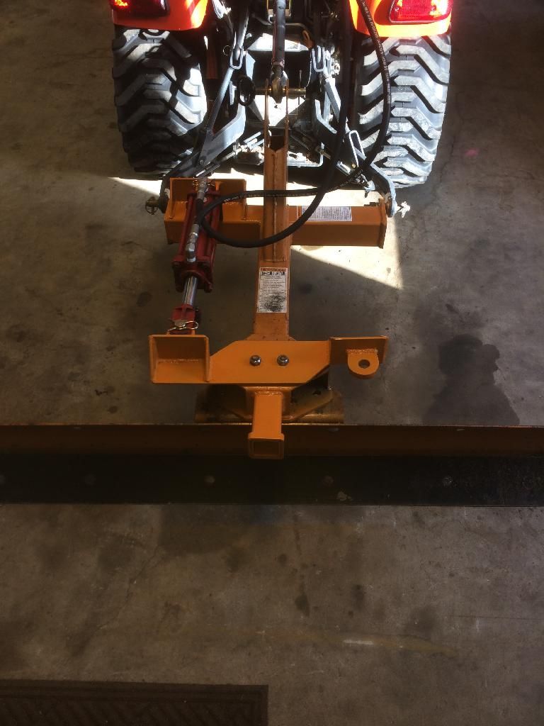

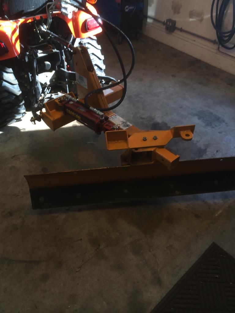

I added this 8" stroke ram i had laying in the barn to my small woods snowplow for my bx. Got tired of getting off the tractor to unpin and change angles. Running the aux hydraulics from kubota...works great. I also added a rear receiver hitch so that i can move the wood splitter and firewood trailer with the plow on. The batwing i made will allow to blade to be pulled or pushed:
   / adding hydraulics to snowplow for bx2360 #2
Good job. Did you already have an open spool or did you have to add one?
the kubota kit gave me two sets of remotes. Really easy install.
