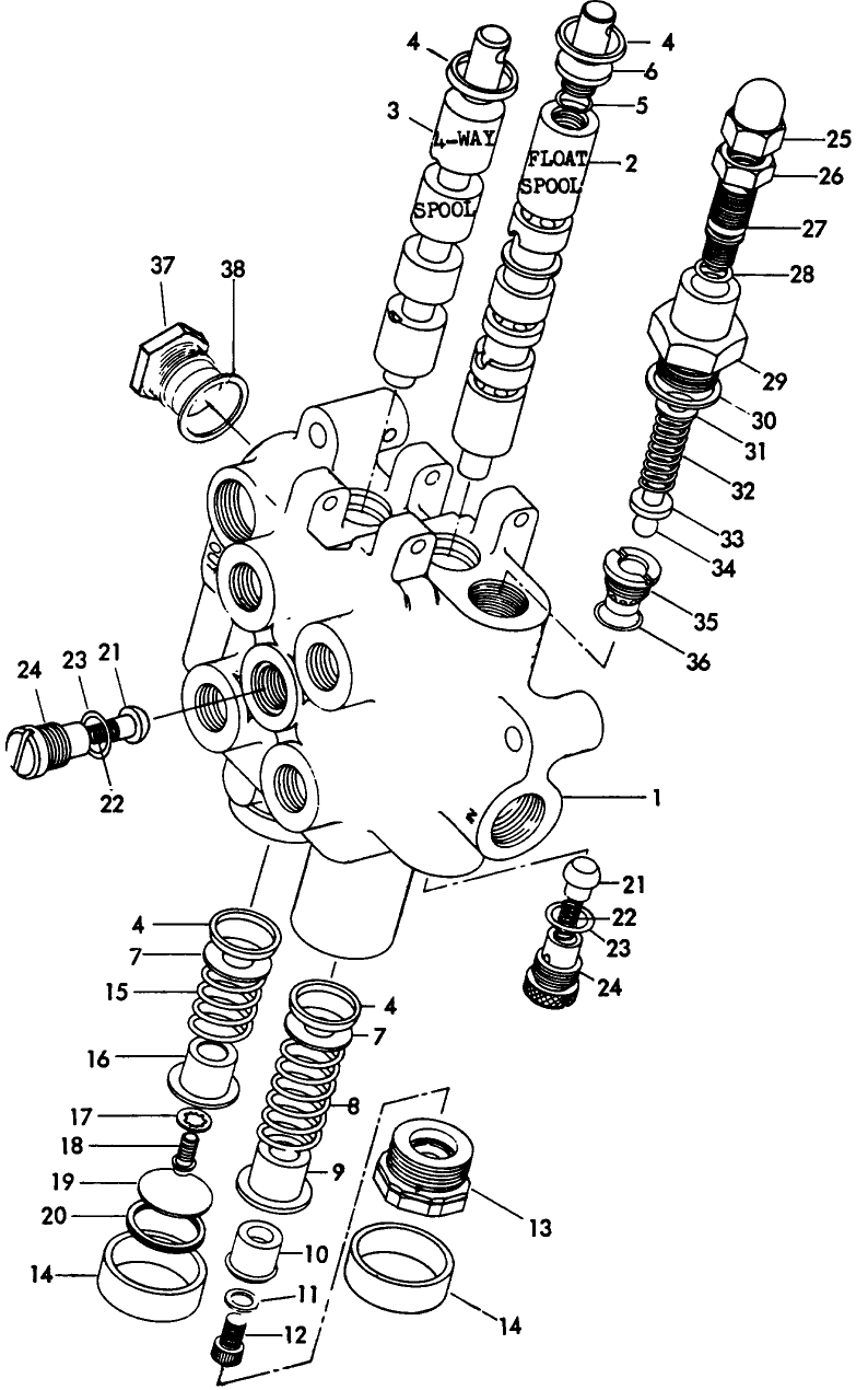

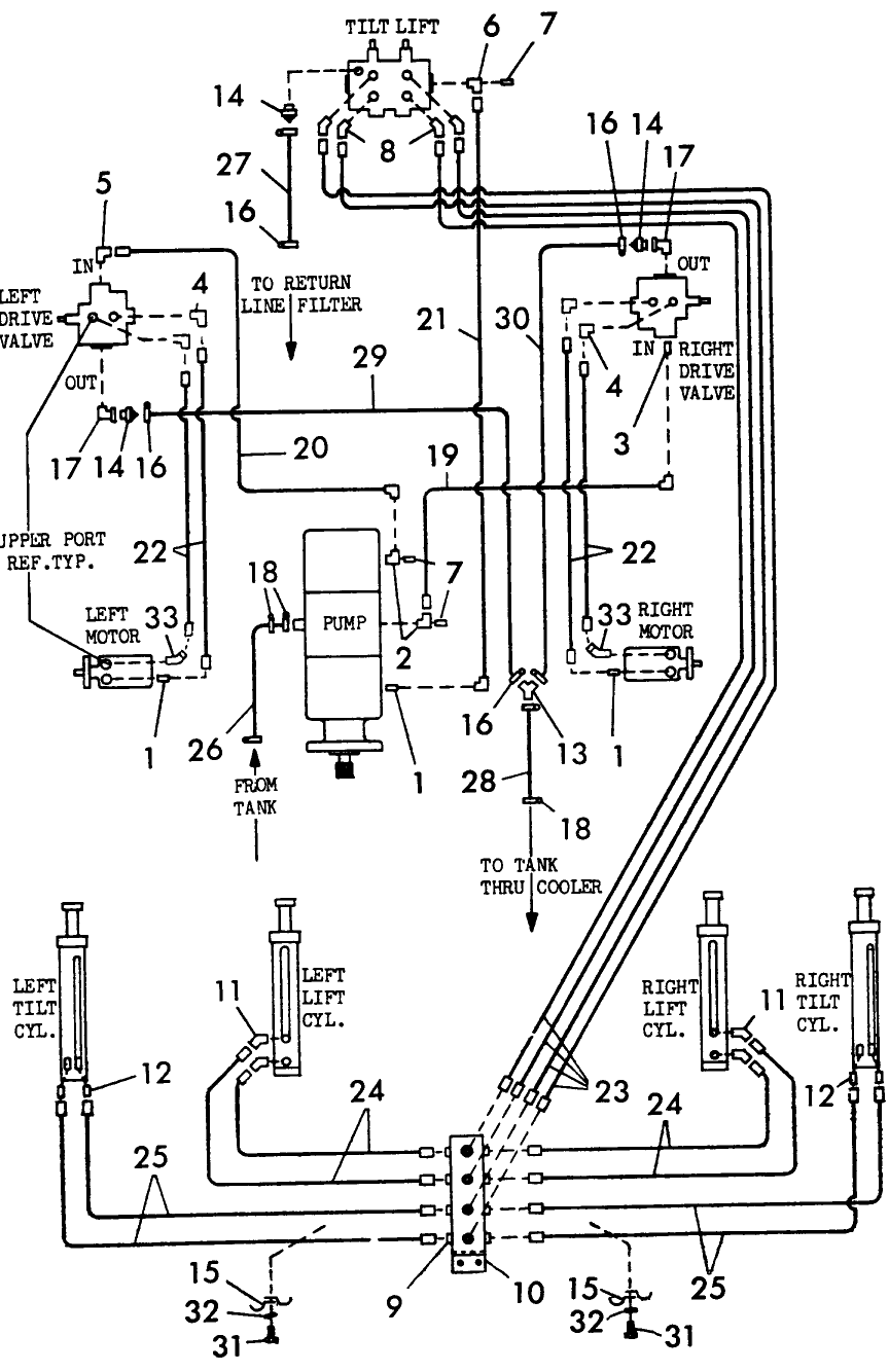

Viewing the attached hydraulic diagram of my machine, and the diagram for the "auxiliary" hydraulic kit (which I don't have), where would you tie in a supply and return for a new valve?
I want to set up a valve with some quick connections on my loader arm for a grapple and auger. (both factory options, but long since unavailable as direct bolt in)

It doesn't look like you have a PB port, so you would have to add a valve with PB before the FEL valve. The new valve would be the aux circuit. You could probably use something like this that has PB.
https://www.surpluscenter.com/item.asp?item=9-7401&catname=hydraulic
Attached is a schematic of the actual loader valve. So this doesn't have a PB port,and the return port cannot be used as such?
I'm curious what #37 is. It is right next to the 'out'.

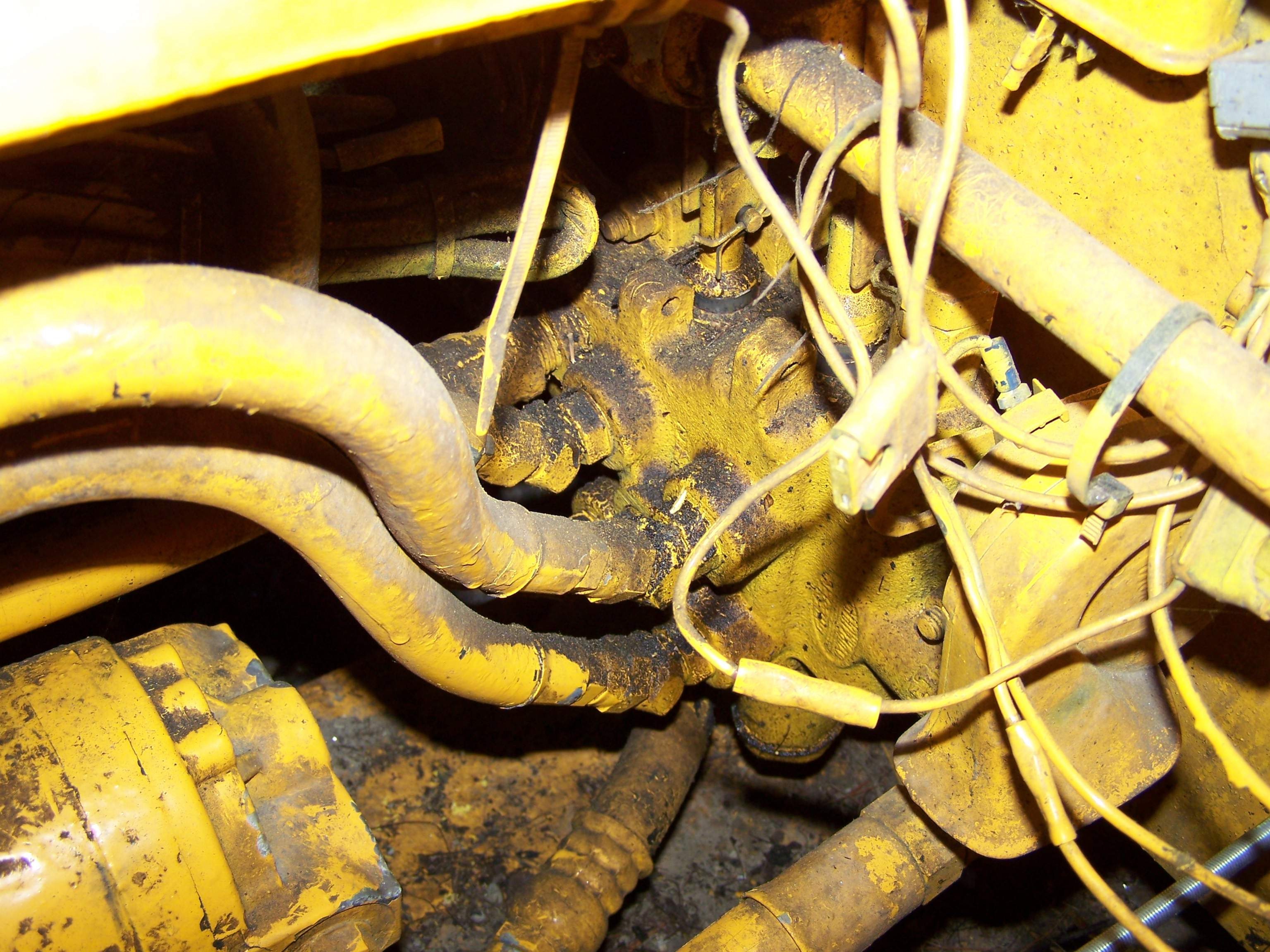

What does your parts manual say about that plug. It could just be another tank outlet . Are there any marking by that plug or port.
A lot of valves have two IN/pressure ports and OUT/tank ports.
Who makes the valve and what is the model number?
Can you show a picture of the side port?

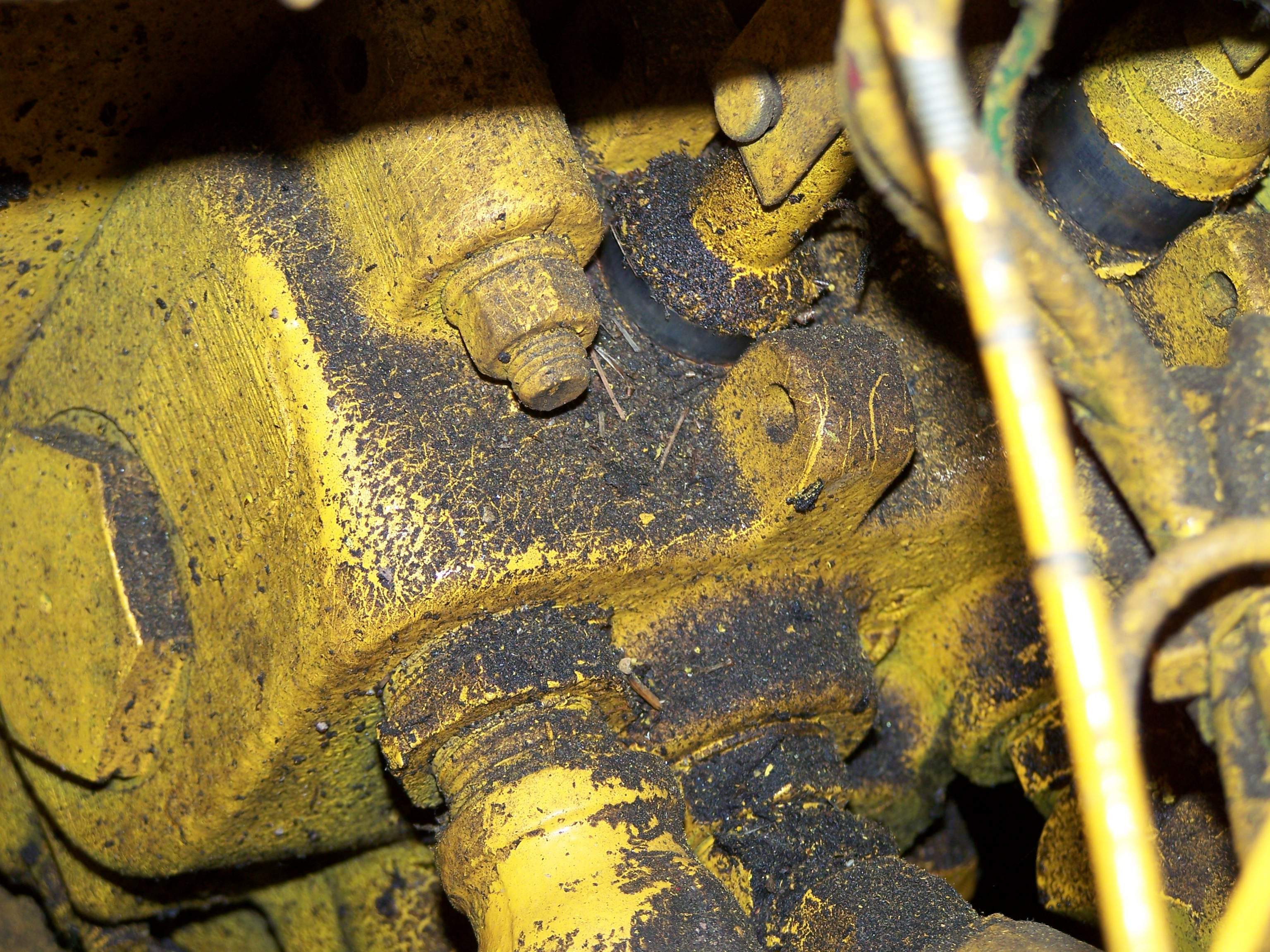

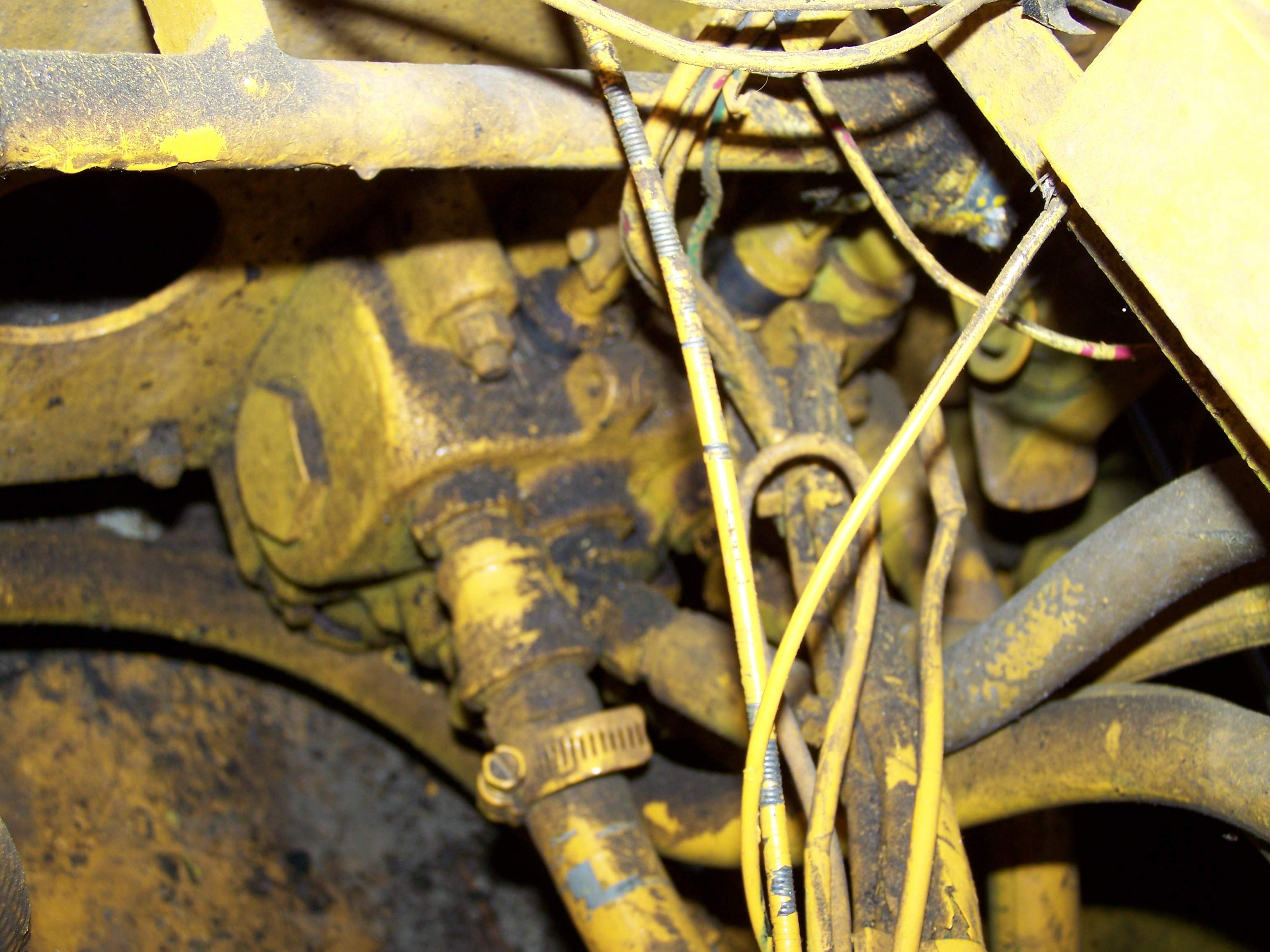

Looks like it says "Grasser hydraulics" on the body, and the only number I see stamped is "J6"
Pictures attached.

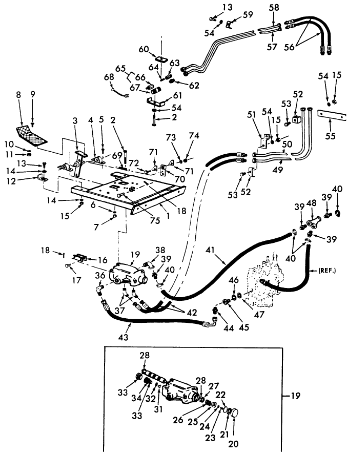

Item #45 in the second (right) drawing with an auxiliary valve added looks like it may be power beyond sleeve, plus there is a second tank valve added to the main valve. Look into that item descripriton, see if it is available. I think JJ has best idea. Your going to have to get an auxiliary valve anyway so get one with Power Beyond in it and hook up ahead of the main valve.

It could be a PB outlet, but the only way to tell is to take the plug out and see if the OUT port is open to the side port. If it is, a PB insert would block off the gallery between the OUT and the PB port. Maybe if you cleaned it up a bit you might see some more marking.
Does the parts manual offer a PB option. or suggest what the plug is for.
I just looked in the book for my loader, and my loader valve is a Cessna, and it looks very similar to yours. The plug on the end of my valve is a PB outlet.

I think the second drawing is for "optional kit" that is not on the loader. In photos of the valve you can see the retrun hose is secured with hose clamp, so no pressure, but just below it on the left side is a large Hex head plug. This would be where the PB sleeve would go in for supply to the aux valve.

Check out that side plug, that may save you a lot of work, as you just add the new valve in series. You have to consider priority when using hyd valves, as the first valve up stream might take all the fluid.

If that port is the PB, you order a PB insert and screw it in and connect that outlet to the IN port of the new valve. The only problem is knowing the manufacture, and if parts are available.

What you have is a Gresen/Parker SP monoblock valve bank with a conversion plug (hex plug you show in pics)
There is a power beyond sleeve available for this valve, check this out.....You may need to copy the entire file on your computer for great reading....it shows cut aways to explain the dilema of understanding how these are manufactured
Check out page 30......4-20.....that's the PB plug you need to run an additional valve downstream of your setup .......look at pages above it and below and it should answer questions you have.....

Leave the current tank retun line where it is, this is need to dump oil when the relief valve opens. From the Power beyond plug to inlet of new valve then tank return from that valve can tee back into the tank on the original 2 spool valve. Just the way it is drawn in that parts drawing you posted.
