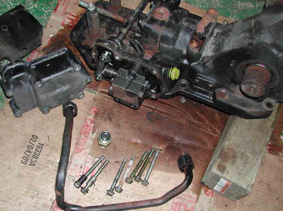

If you have the inline filter, JEFF, it looks like just a fitting (see photo).
The inline filter that comes with the factory power beyond kit looks more
substantial. It seems unnecessary to me as other tractors don't use them,
usually. JD has only one cartridge hyd filter and one suction filter for their
whole hyd system, even on HST-equipped units.

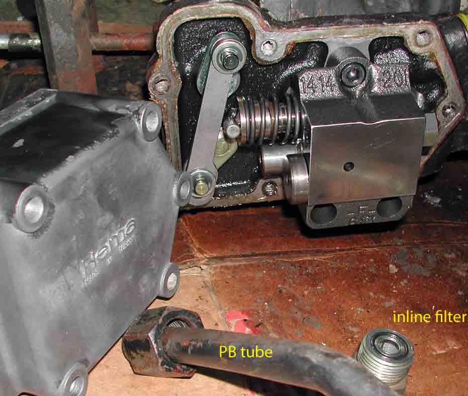

The filter fitting screws into the back of the rockshaft valve shown in the
above photo. It's the yellow plug in this photo.
In my filter, the steel mesh screen was pushed aside. I do not plan to
replace or repair it. My rockshaft valve seems to be OK.

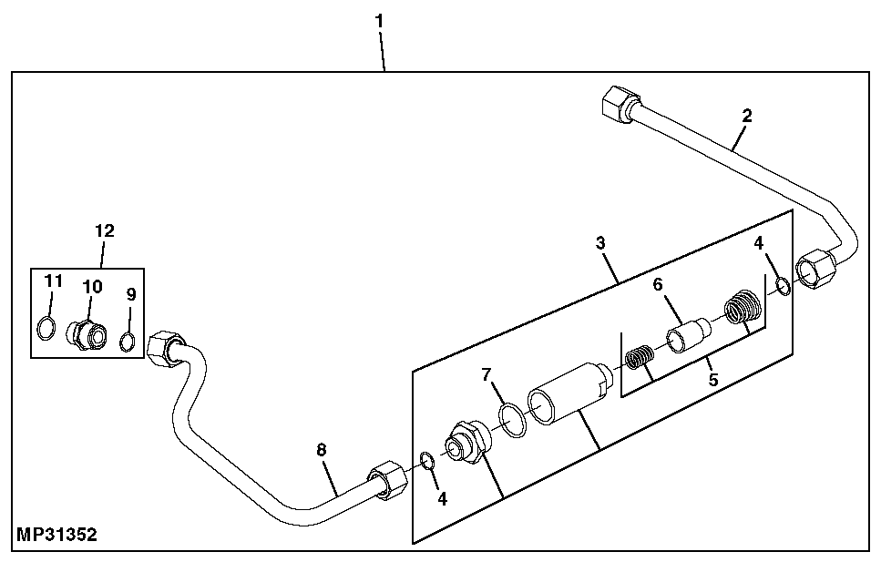

D...you have the old style-not the updated "inline" filter the OP is referring to. It replaces the tube shown in your picture.
/ Adding infilter screen to 4300 #6
Yes, that is also the filter you get with the power beyond kit, or at least
similar to it. Since Jeff's tractor is older than mine, I assume it has the
older filter like mine does.

I would have thought the 98 would have had a filter from the factory. The filter was added about then to all of JD's CUTs to solve a issue with the rockshaft drop-recover due to a leaking valve. JD did a PIP (read:recall) to add them to those 4200+ that didn't have them. I suspect the PIP has expired, but the kit may still be available. I was told that the inline has much finer screen than the older built in one. It has been moved depending on model. On the current 4x20 the filter is under the chassis.

-But- the new inline filter can be seen plain as day from the rear. Dead center of the machine about 8 inches or so above the PTO shaft on the steel tube than runs from one side to the other...
