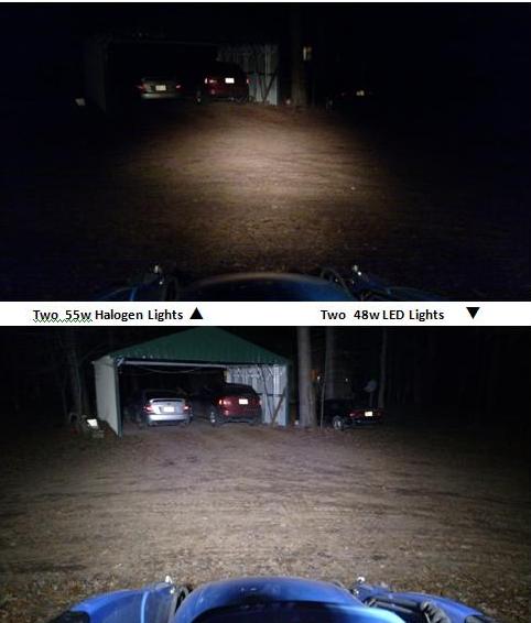

Do you have any existing lights on the roof of your cab? If yes, use that circuit. If no, there may be a spare power plug under the seat for a work light. I used 2 48W LEDs from Amazon that cost less than $25 for the pair!

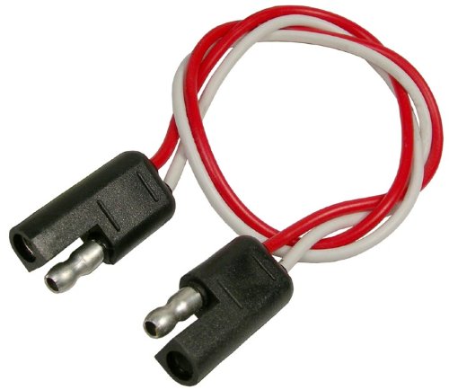

My plug looks like this. I used that for the power to a switch I mounted on the ROPS and from there to the lights. I put an inline fuse in between the plug and the switch.

airbiscuit has it right. If you don't have a factory set of 'work lights' installed, there should be a set of capped, unused 12V wires, at the back of your tractor, that are already wired to your existing light(s) switch. The plug should be as he's shown in post #6 or similar.

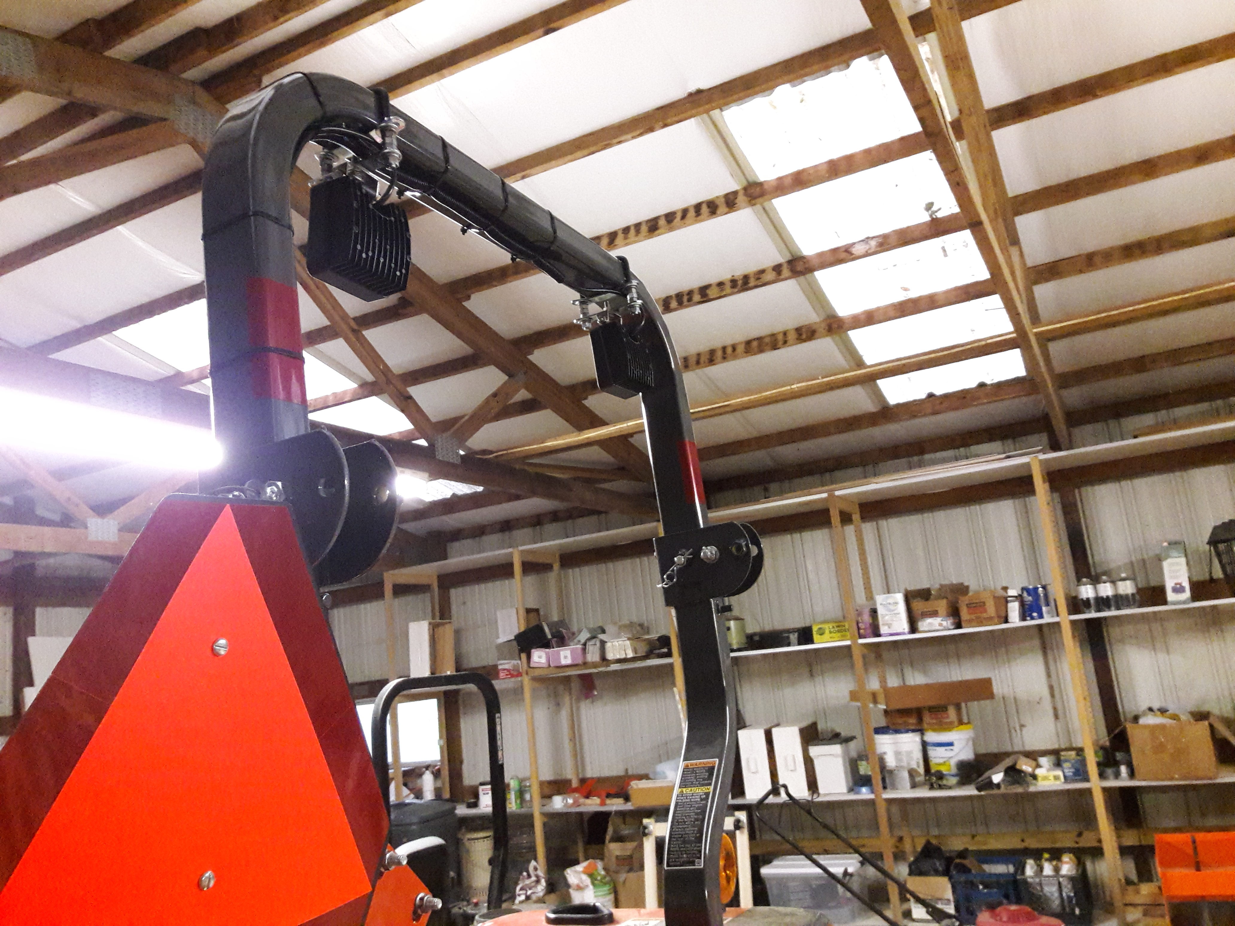

Ditto for me. Those LEDs worked great. Mounted them on the ROPS of my Kubota L3901. Put two facing forward (see photo); put another facing backward when I discovered that I couldn't see anything at night when backing up. The lights are of very solid construction and provide ample light.

You can buy one of those 2 prong pigtails at an auto parts store (kind of like 1/2 of a 4 prong flat trailer plug). Hook that up to a 12 V bulb and you will be able to tell if it is constant power, or switched to your key or light switch. After that, it's easy. Wire an inline fuse to the positive wire on your pigtail, then to a toggle switch, then to your lights.

If there's a pre-existing 'quick connect' at the back of the tractor (as there is in this case) it is most likely already hard-wired to the tractor's 4-position light switch. An inline fuse + toggle switch won't be required.
