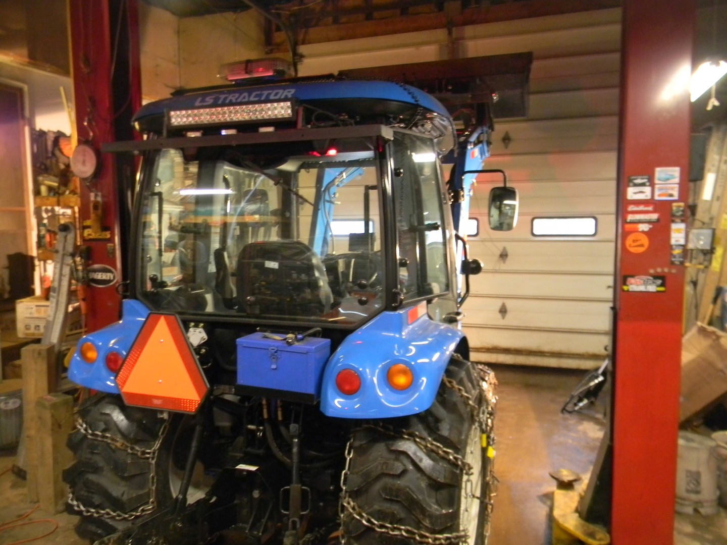

I did mount 2 light bars on my tractor, 1 front and 1 rear on my own homemade brackets.

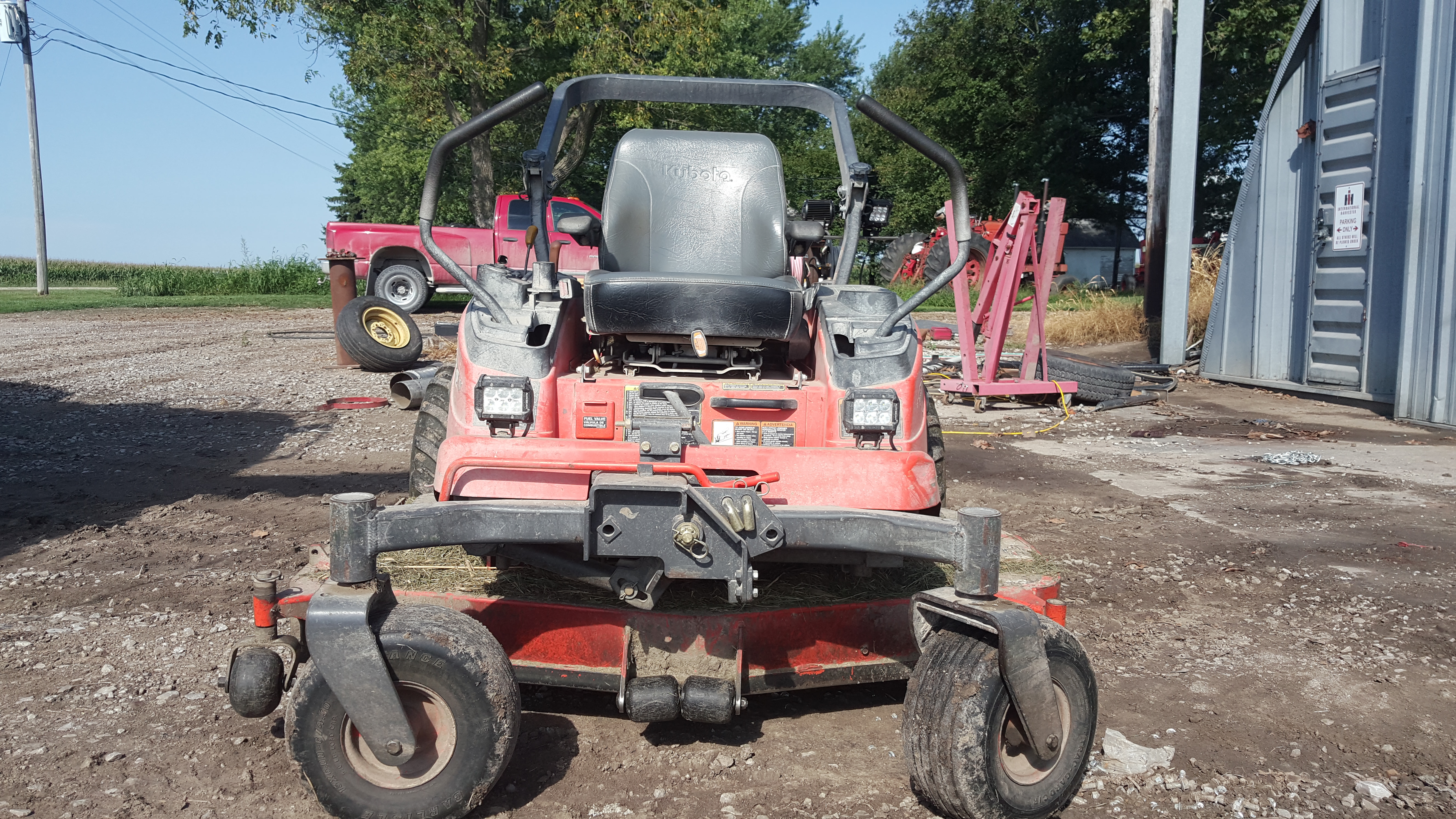

I don't have them wired yet but I put two 18 watt LED'S on the front of our ZD326, that's only a 3 amp load and your mower should easily handle that. I had to drill holes to mount them but that was easy.20160817_095750.jpg

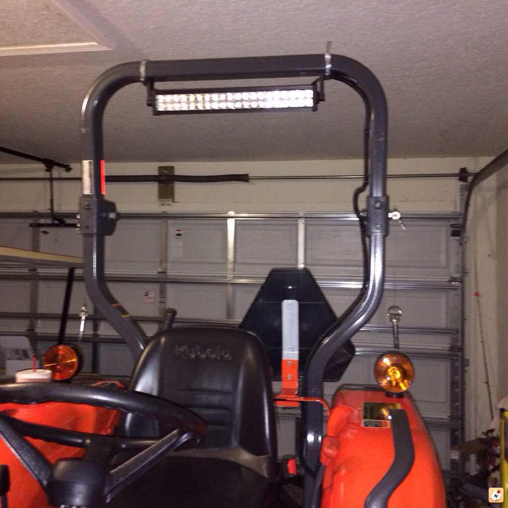

Cool, I like that! Let us know how they work once you get those bad boys all wired up! I Was thinking using George's idea of using u-bolts and clamping some to the side of my ROP View attachment 477833.... if not underneath it View attachment 477834
Here's how I mounted one on the tractor, sort of similar. Those squared off U bolts are in the trailer section.

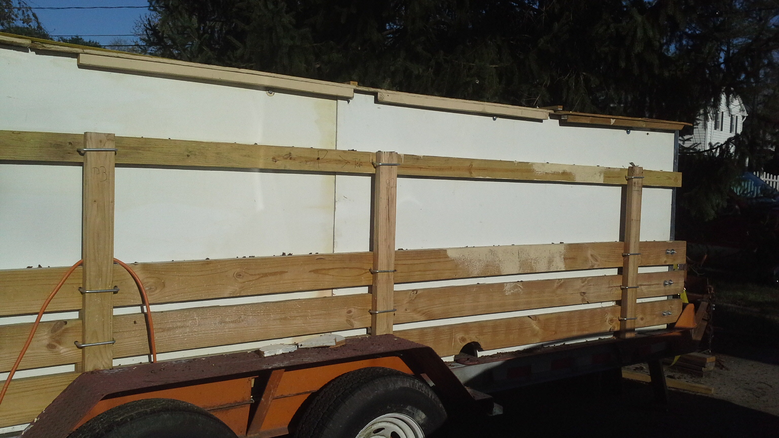

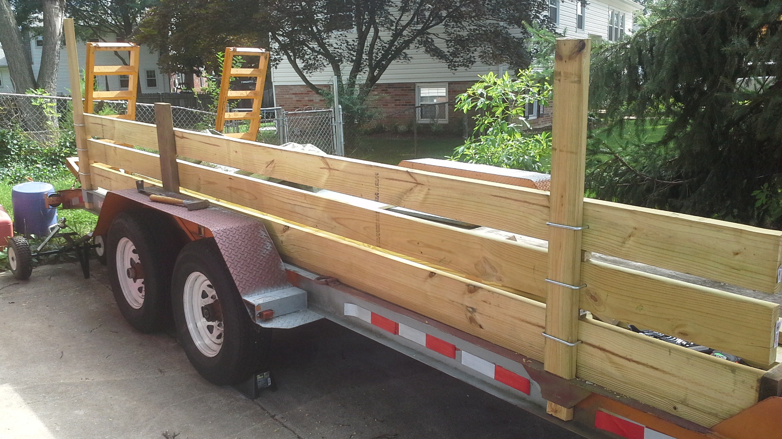

You can buy the squared off ubolts from Home depot.
They are the primary fastener I used on the box I built for my trailer.
So I can have no sides
Stake sides
Or a fully enclosed box
With that and several other projects I've about 100 to 150 square ubolts.
However for small led light sets you might want to explore using magnets.
Several threads here on it.
