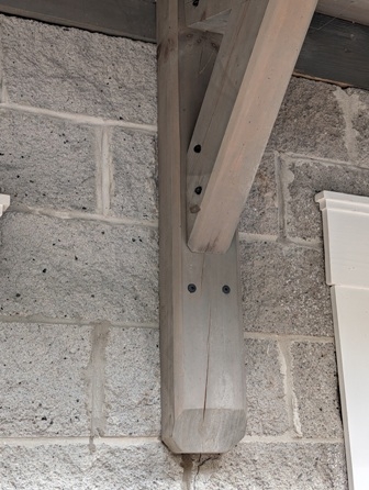

Several years ago, brother in law came. He added an awning above the garage door. Wife wants to duplicate it on the other side of the house.
Question is.... we can't see how he attached things. He didn't have a nervous breakdown.... but he's crawled into a hole and won't 'talk to the world' so I can't simply ask him.
As I recall, (and we have more) those are 12" long "log screws". Threaded 2-3 inches on the tip, rest is shaft. I can't believe he screwed those into the block itself.... is there any special anchor that you might use? Need any thoughts of epoxy or just tighten them down?
We've got the parts (that you see in the picture) already cut/stained, ready to mount. Already have the crossboards.... so this is essentially ready to go but for not knowing what he used and how he might have done it.
I'm always nervous drilling into blocks. Frankly, I would have rather NOT done it just so I can be 100% sure nothing is going to crack on me. Also, it's split face block. Wife seems to forget we won't be able to get a flat surface unless we take a grinder to it (like was done before). Again, I'm not keen on that but, it's been done and what do you say!!!
This "brow" is only two, maybe two & a half feet deep. It's just to help keep some water from landing closer to the house & splashing up on things. Thankfully, nobody will be walking on it!
The fixing at the top is under tension ( pulling away)and fixed into wood; the bottom is under compression (pushing into the wall), so the fixing requirement is minimal.

It's hard to know for sure with the angle of the photo but.... The top is most likely mounted into the wood, the lower would appear to be mounted in to the solid ends of the block. In those cases a "ledger lock" would be used on top and for the lower a solid type "tapcon" anchor would be fine. I'm more curious to know if he used any joinery (or back screwed and the black bolts are for looks) on the support angles or if the screws there are at an angle. Not clear to me in the photo. Assuming you want to match the look, they do sell black ledger locks and black tapcons that would do it. More important would be when drilling into the block to use the proper tools to not eat the bit or blow the block apart. A bunch of different brands of fasteners out there that'll work. I wouldn't use an expansion bolt on most block, JMO ...
