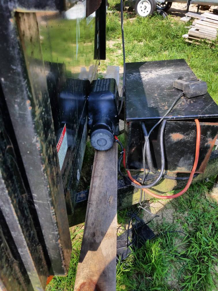

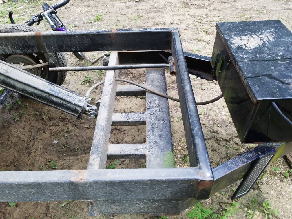

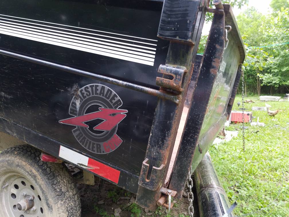

I've seen the trailers some have with an inverted arch on the back that pivots, enabling log loading with a winch. I'd like to do something similar but the only trailer I have is a dump trailer. I don't see a problem with beefing up the back a bit to hold the weight of the base plates for the arch. What I don't know is where or how to attach the winch.
Any ideas? Here's some pics of what I want to do and what my trailer looks like.

I’d move the battery/accessory box, add a third/center member to the tongue and put the winch basically where the box is now. Your idea about outriggers to the ground would be good to prevent frame twisting.

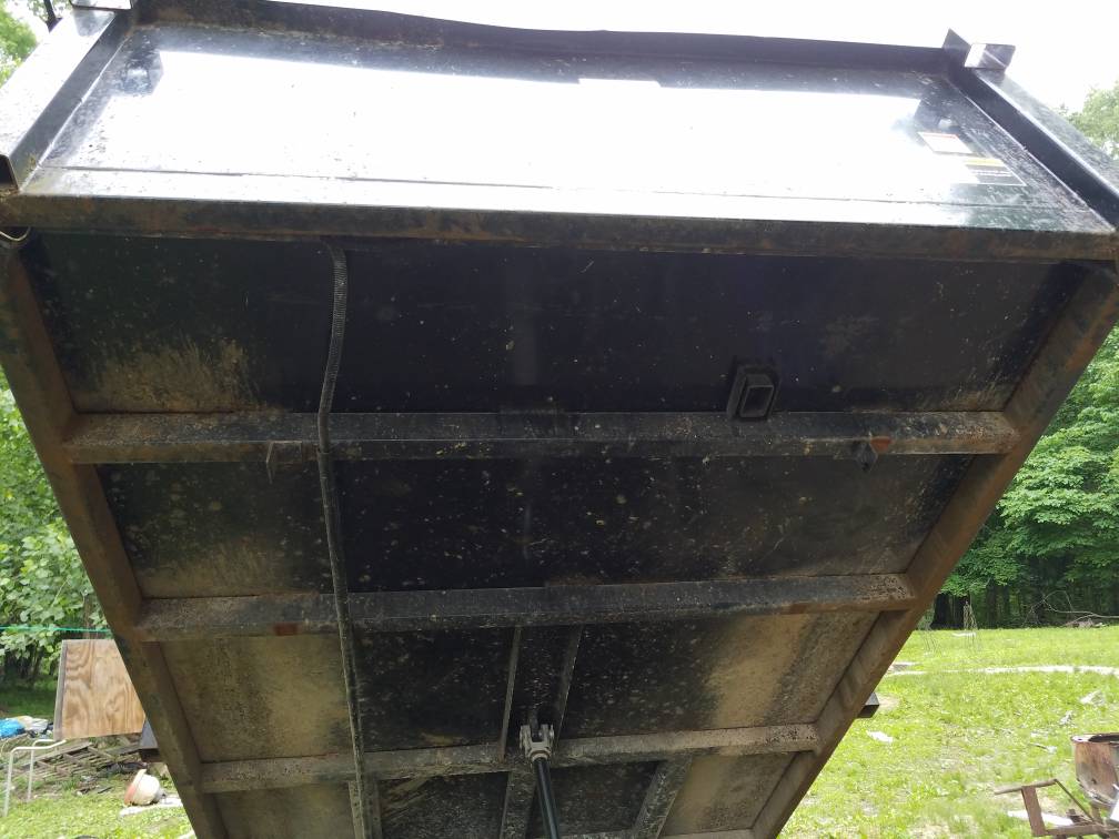

I recently saw a dump trailer that had a 4” piece of angle welded across the bottom front of the bed. Angle tucked under the bottom and around the outside front.
The gentleman welded a receiver hitch to that facing and through to inside the bed. Then used a receiver winch mount inside the bed with a locking pin hole on the outside front end. One of those receiver cap things kept junk out of it when not being used.

The box holds the battery, pump/tank and controller. I'm not sure where to move it to.

I would mount the winch on the front of the dump body, maybe re enforce it a bit if needed.

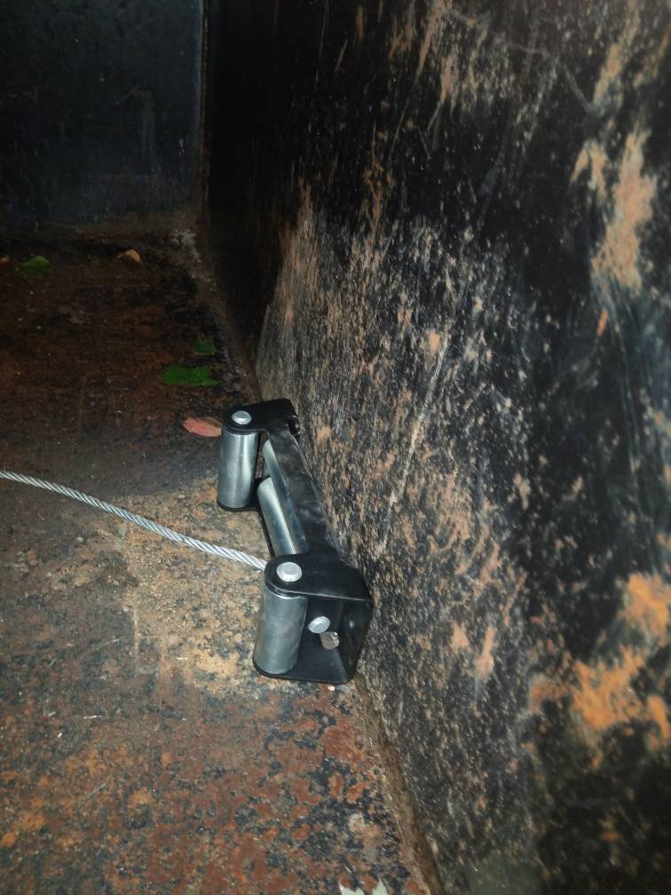

I did actually! I forgot to post anymore here.
