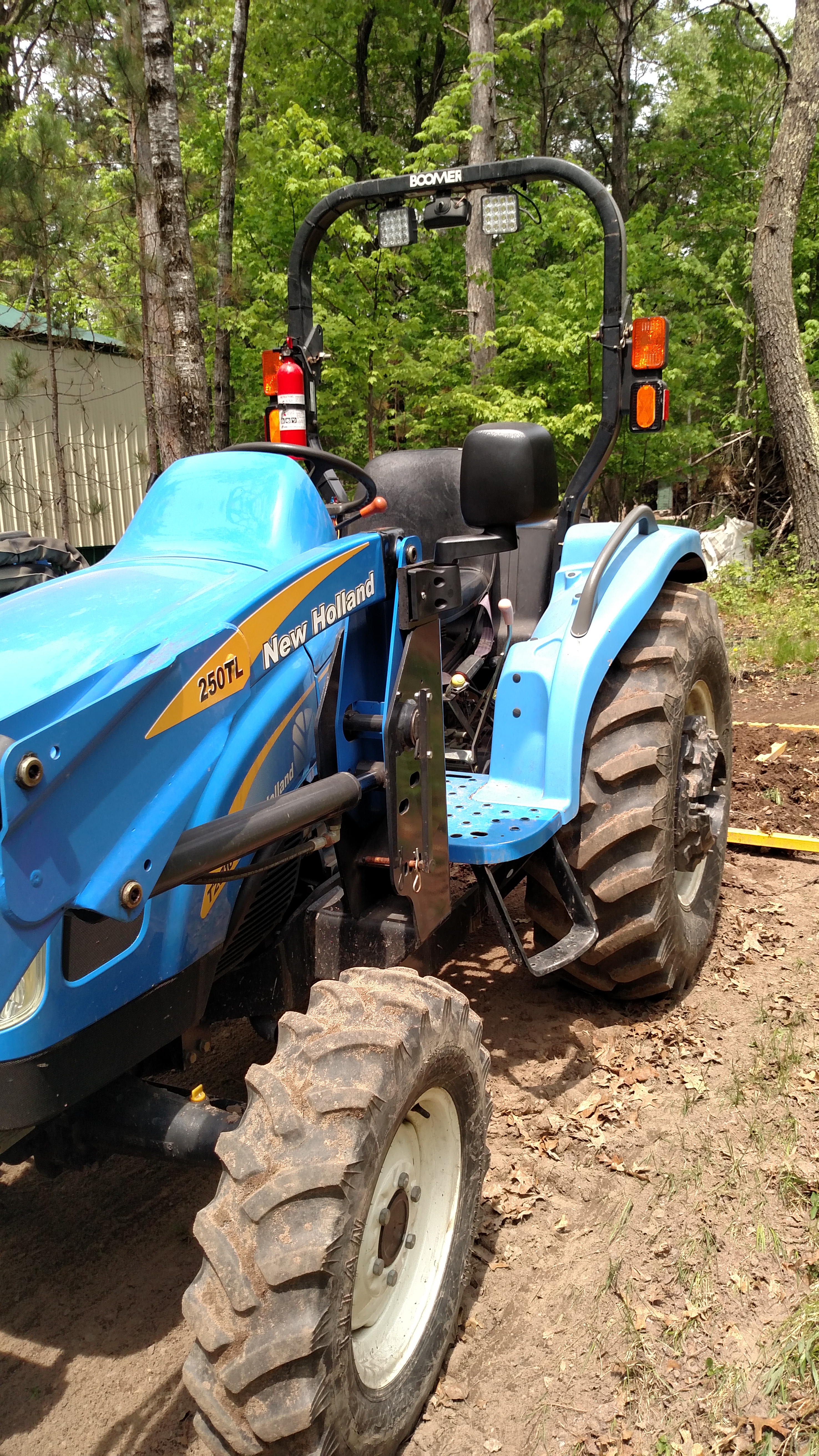

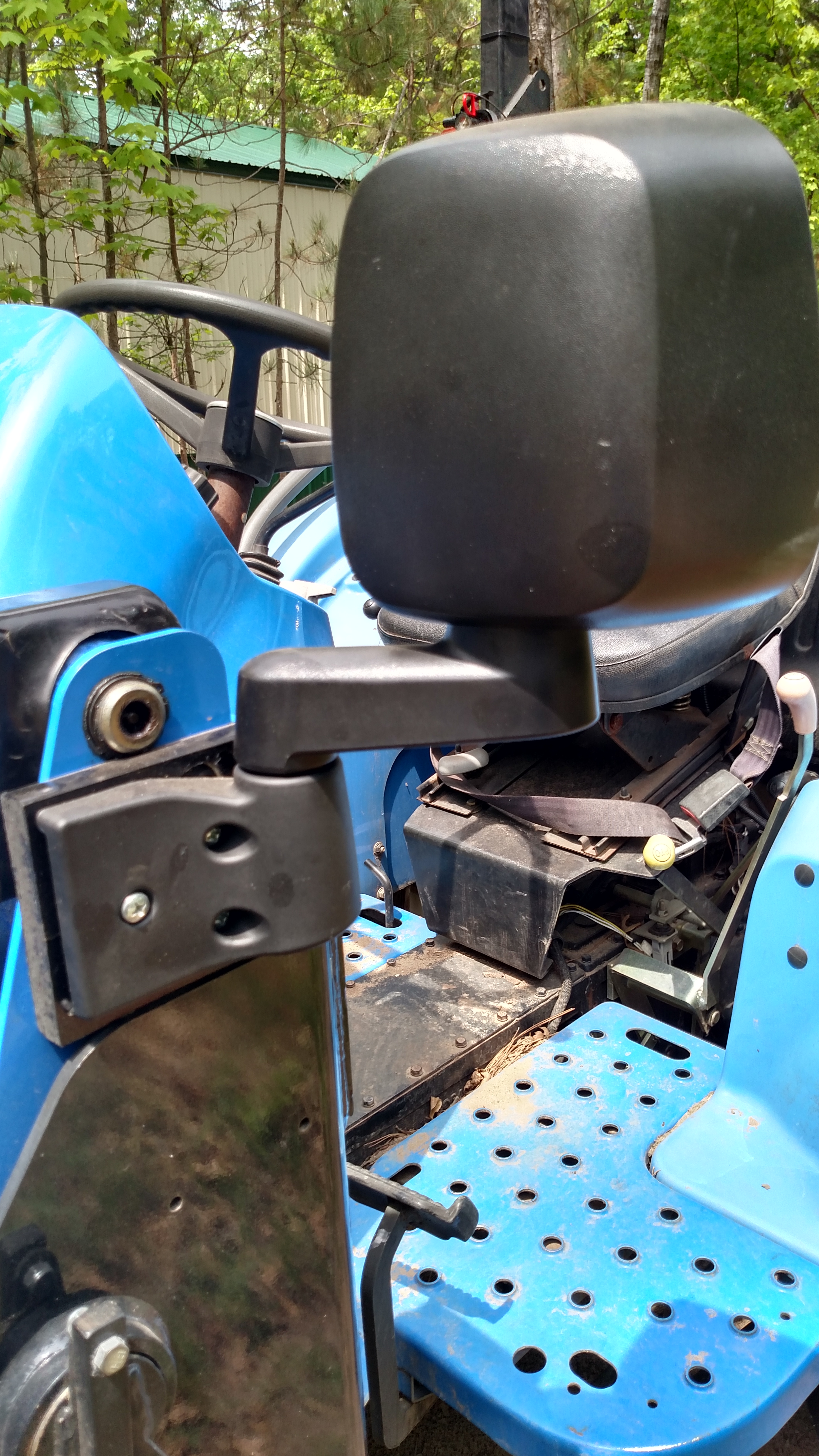

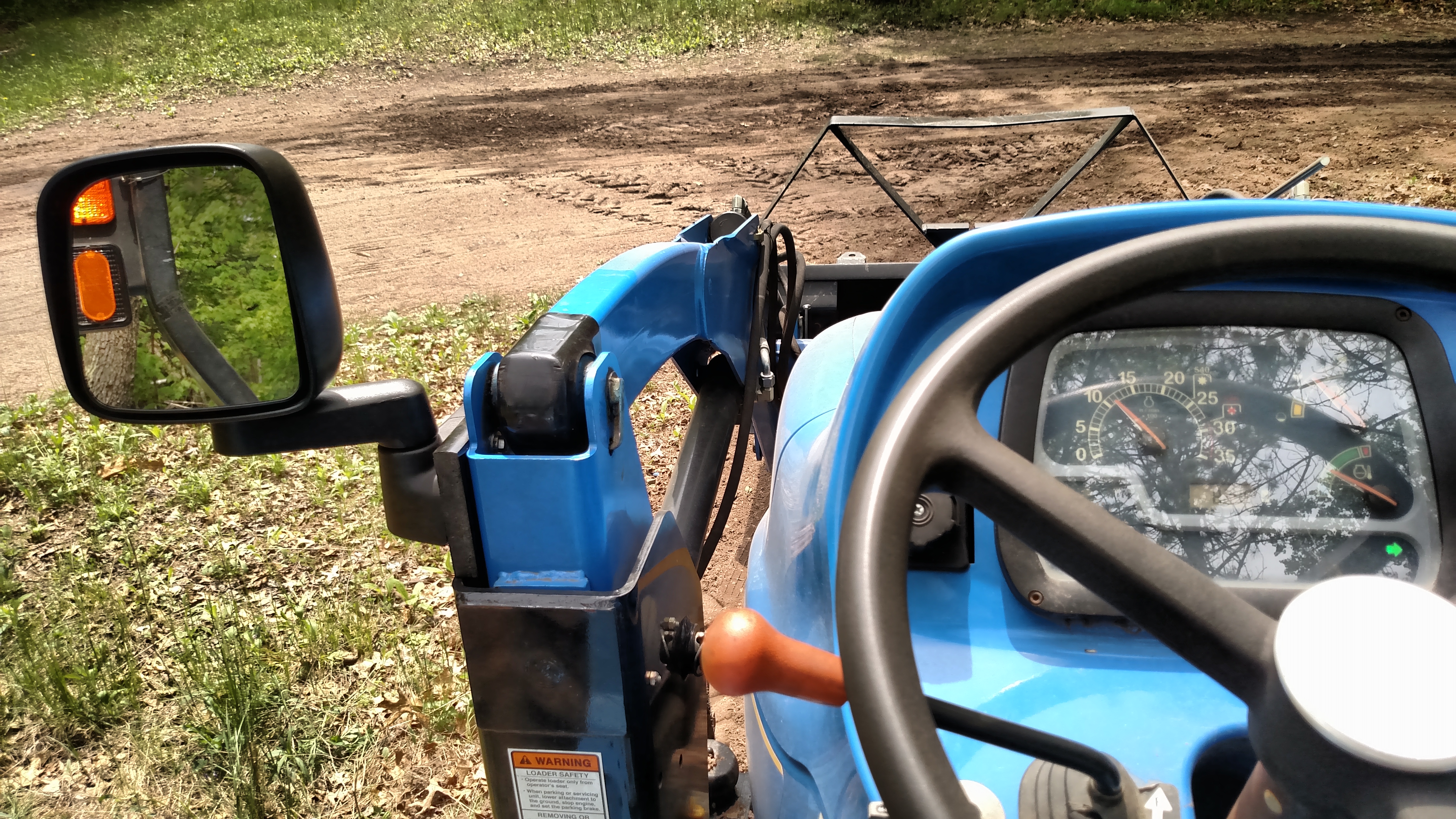

I maintain a 1/2 mile private drive and occasionally travel down local roads. I like to see what's behind me. I saw on TBN that someone used a Jeep Wrangler Mirror and attached it to their loader frame.
I thought I'd try it. The Jeep Wrangler mirror is perfect. Flat attachment point, nice size, and $17 on ebay. There was an existing hole on my loader frame. I took a piece of wood and used threaded inserts for the mounting bolts, and done!

I like the way that will just fold in if you come to close to a tree or something. Mine is on a solid mount so I had to mount it further in. so it would not be to exposed. You get a little better view with it out like that. A rear view mirror is definitely a big plus when doing road work or traveling on a public roadway.

It vibrates surprisingly little. I didn't want to drill any holes in the loader frame, so that single existing hole came in handy. The threaded inserts (T-nuts) were really the answer.
/ Adding Mirror to Loader Frame #5
How do you get the T-nuts to bite into the steel loader frame?
[Just kidding- I saw your notes on using the board to mount to the frame.]
Have you ever used Nutserts?
I've used them in a few areas where I need to be able to tighten up an assembly blindly, and for the application they can be pretty handy.
