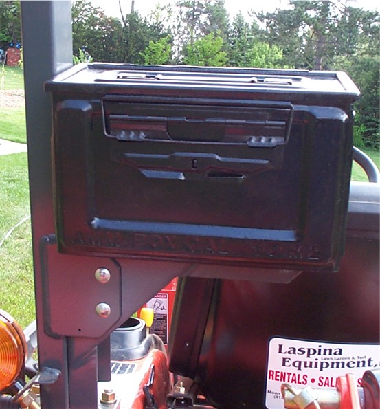

Don't know what tractor you own but here is a picture of an ammo box that I mounted on my BX2200.
John

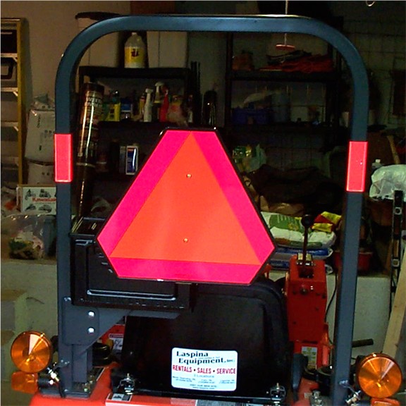

   / Adding on a tool box #12
That first picture was a little dark. Attached is a better one. I used existing holes on the ROP to mount the bracket.
John
   / Adding on a tool box #13
John your having such a bad time with that picture I took the liberty of lightening it up and posting it for you. /forums/images/graemlins/grin.gif

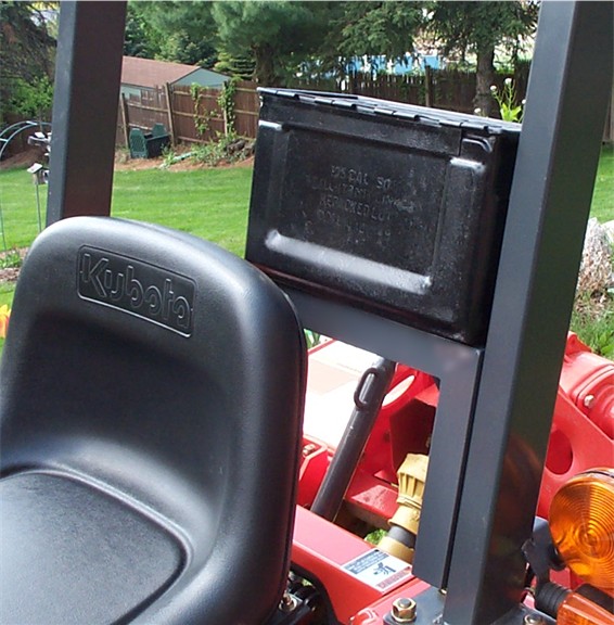

John,
Yours is the other one I was interested in for my BX. Question I have for you since you have had that for about a year if I remember correctly.
Do you find yourself hitting it while turning around or in any other situations? Does it hinder your view when doing something with a rear attachment or backing up?
Your installation is definitely a clean nice looking job.
   / Adding on a tool box #15
Pineridge... thanks for fixing my picture.
Surfran... No problem with blocking your view (at least it hasn't caused me a problem). However, there is not much space between the seat back and the toolbox. If I ever take it off for some reason, I will move it back a half inch or so. Other than that it works great. You would be surprised how much that box holds. Holds everything that I need. I attached a front view. I also have a picture of the bracket if you need to see it.
John

   / Adding on a tool box #20
Cliff is making a good point about secure mounting. My bracket to hold my box is 1/8" steel, the screws holding my box to the bracket are all stainless steel, and the top of the box is always locked when I am not in it.
I don't want to see anything bounce out while I am moving, and I don't want to see the whole box come free if I happen to tip the tractor. . . if that box came lose in a spill, it would make a nasty mark on my otherwise beautiful face and the wife would be really upset with me.
No matter what type of box you decide to use, make sure it stays stuck on your tractor and make sure it stays closed.
