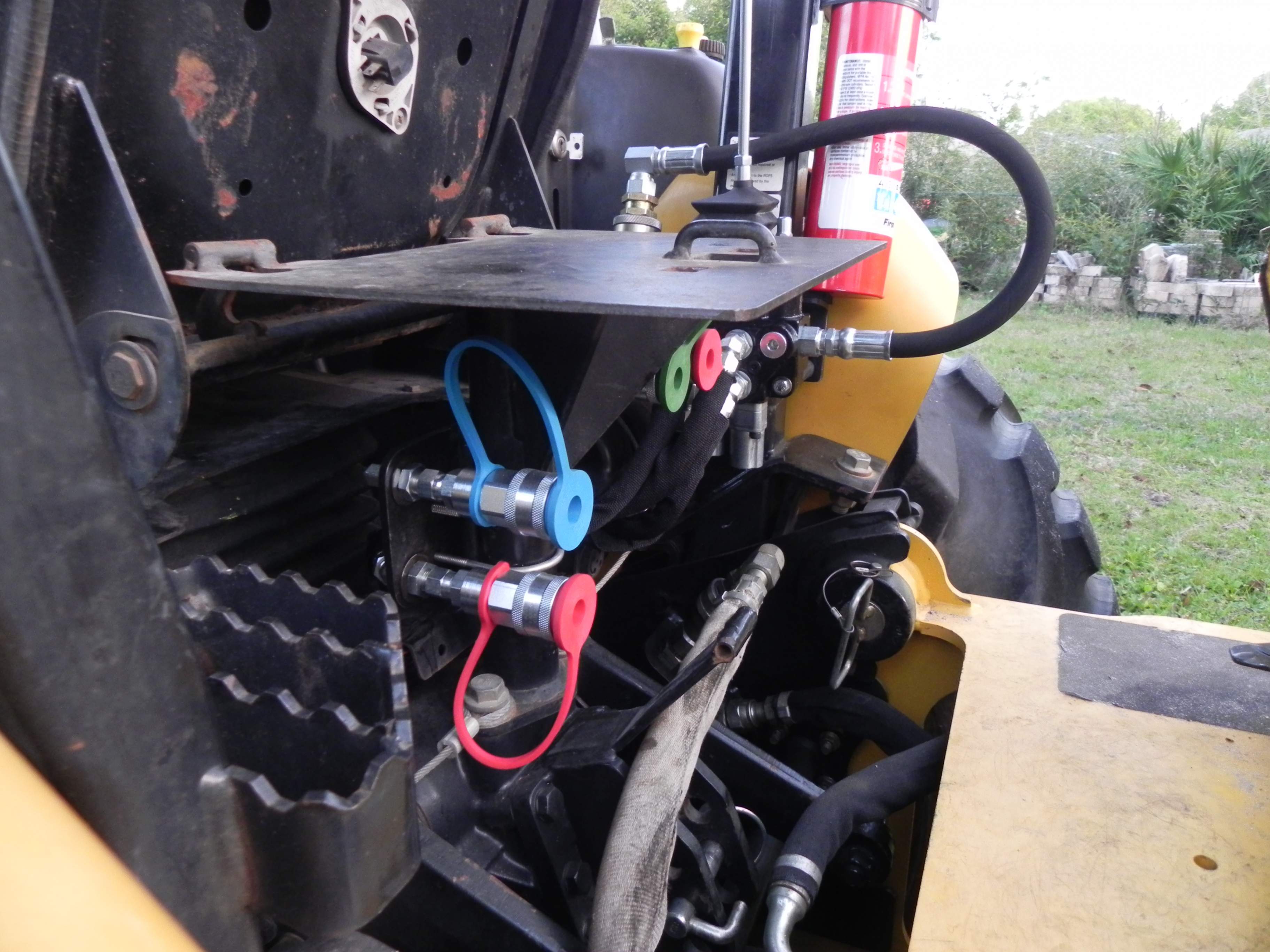

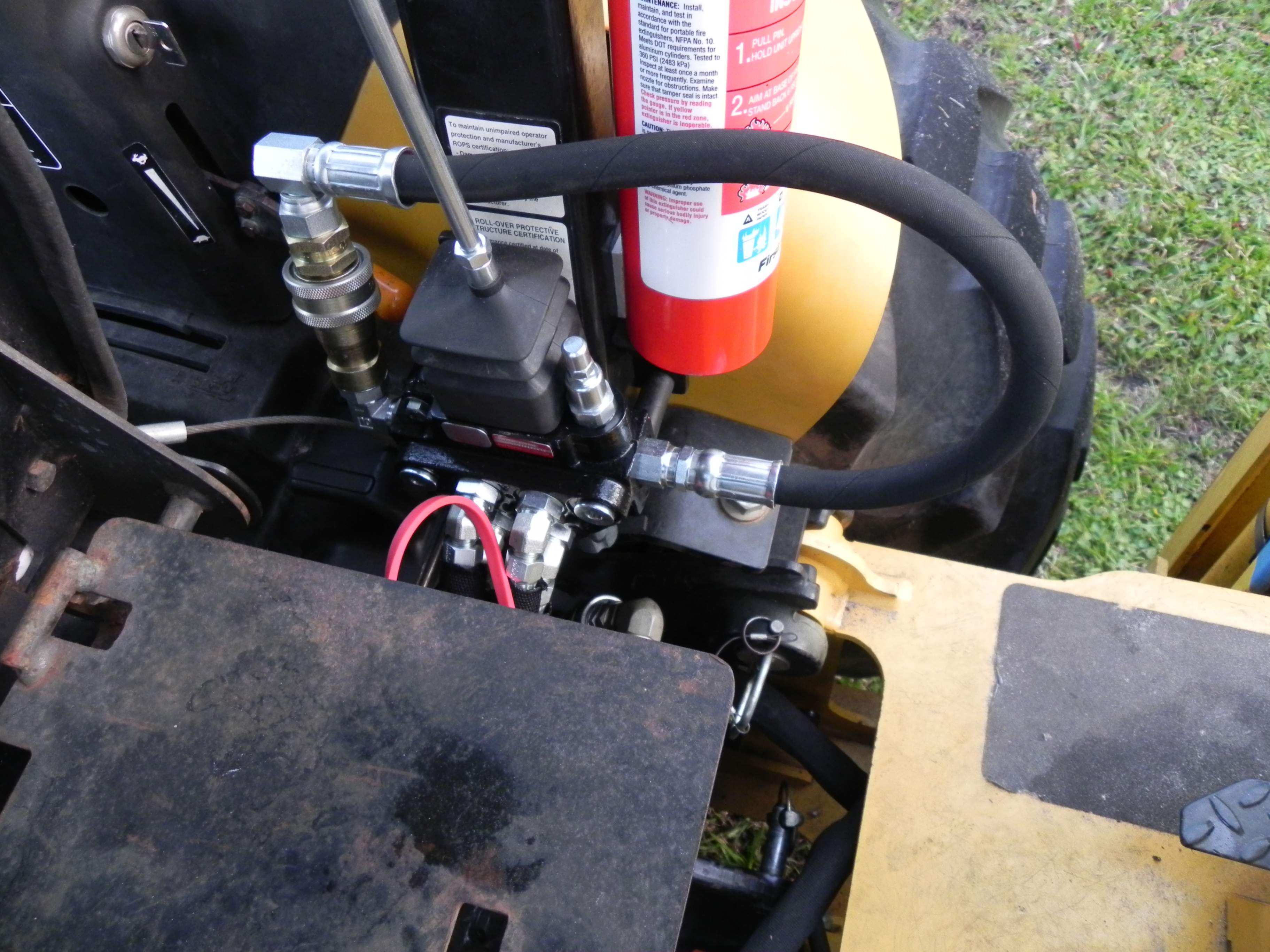

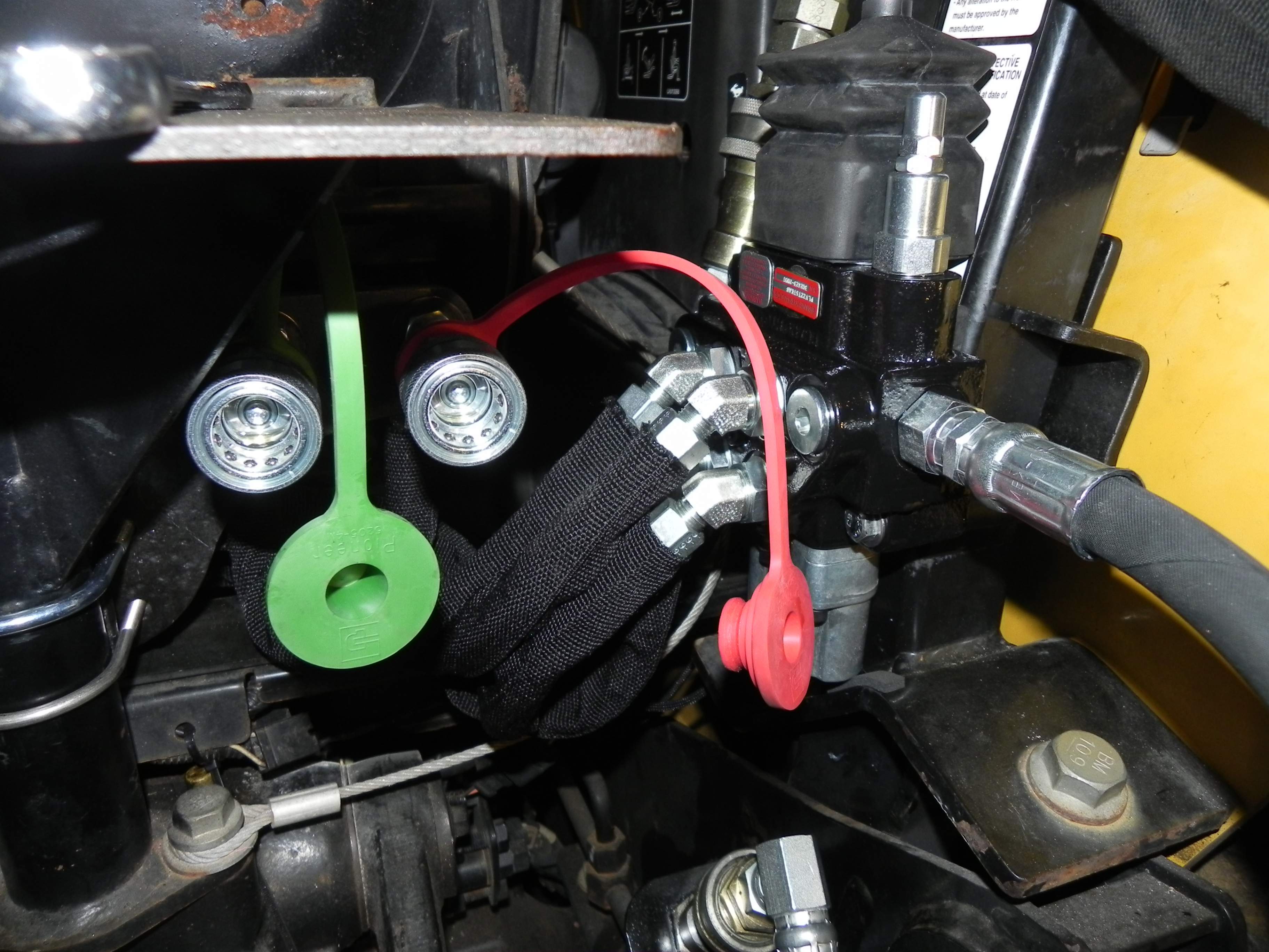

Sorry the pics are not very good, but they will show that I am mostly done with adding a pair of rear remotes and controller (with float) to a 110 TLB. DSCN1310.jpgDSCN1312.jpg

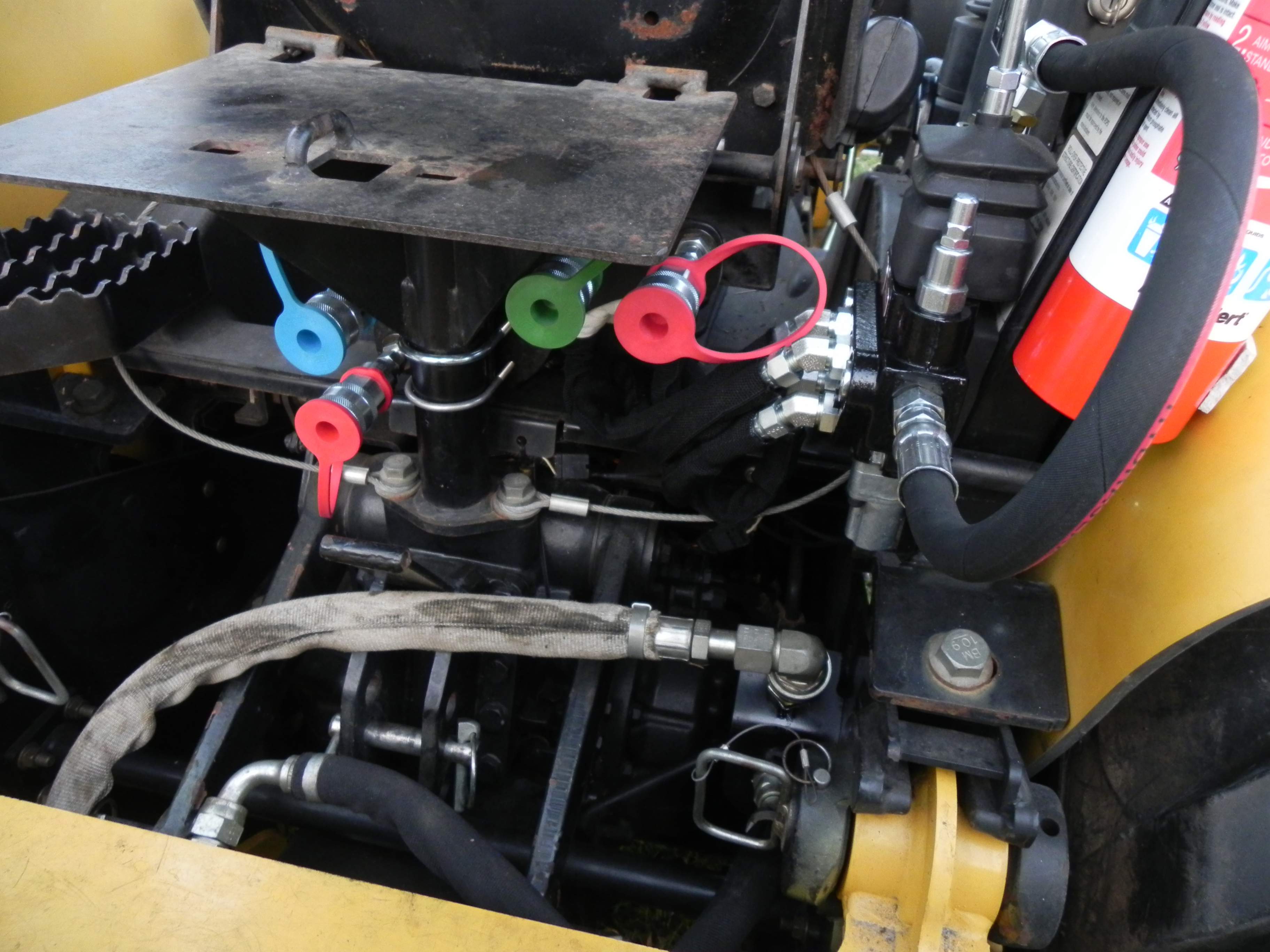

   / adding rear hydrauics for TNT on a 110 tlb
here are some pics with the backhoe attached.

That might depend upon what you consider expense.... If you (or anyone else) would be interested, I might consider putting together a kit. I will have to look at what it cost me in parts, and the time to make the brackets/mounts/etc.
Looks to be a pretty good job making everything fit, congratulations on making it so.
thank you!
So will you have the aux circuit on the fel and the tnt now?
Yes I will still have front aux, as this does not touch the fel aux circuit at all. When it is connected (backhoe off) it basically replaces/simulates the backhoe valve block (but with only two circuits instead of 6/7). When the 'hoe is installed, the hose loops back onto itself to keep everything clean (just like the 'hoe hose when you remove the backhoe)

That's a great looking setup Disney! So the valve is not active when the hoe is mounted?
Correct. It gets it hydraulic power from the supply hose to the backhoe. It is not a tee feed, so either the backhoe hydraulics are connected, Or the rear valves, but impossible to have both the way I did it.
   / adding rear hydrauics for TNT on a 110 tlb #10
Are your couplers big enough to flow the 110's GPM hydraulic flow? Is the valve big enough?
