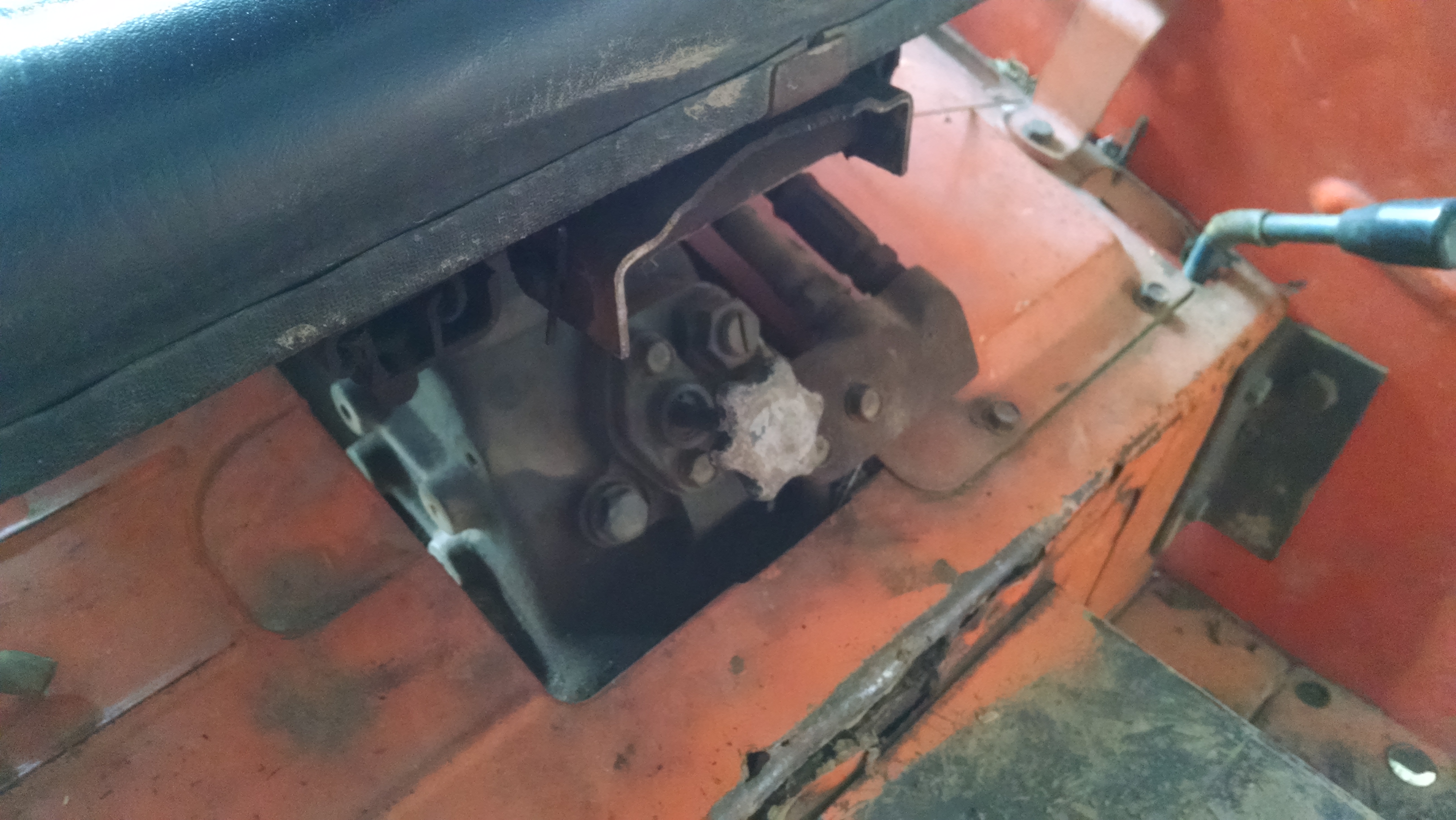

I emailed Nate today and also looked at the add on info in the Kubota parts manual. It sure seems like it would be way more economical to add aftermarket parts. I understand the keeping it all kubota argument, but my machine is close to 30 years old. I just want it functional.
Yes it sure would be a lot less money going aftermarket, but did you see where you can tap into the rockshaft?

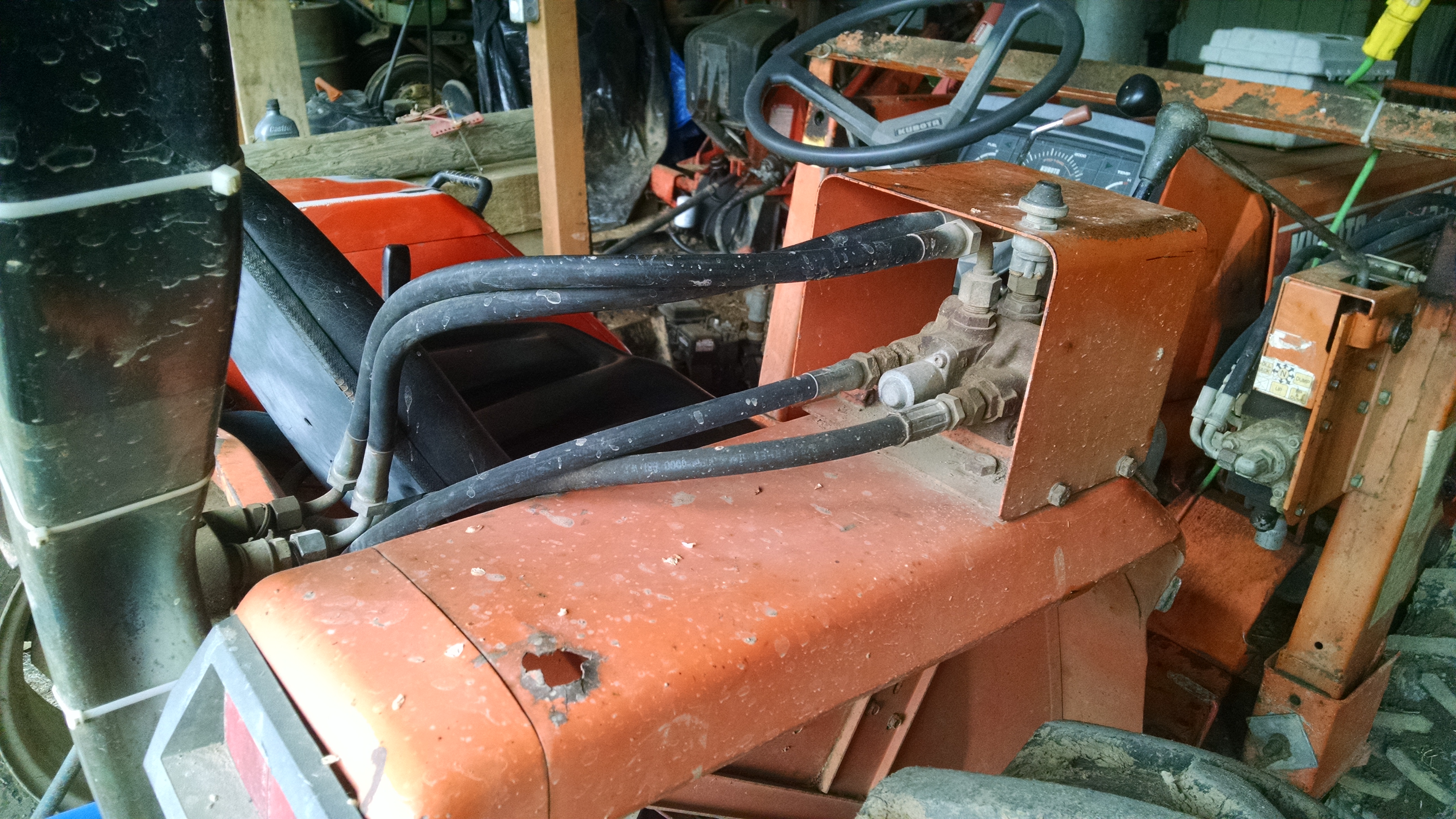

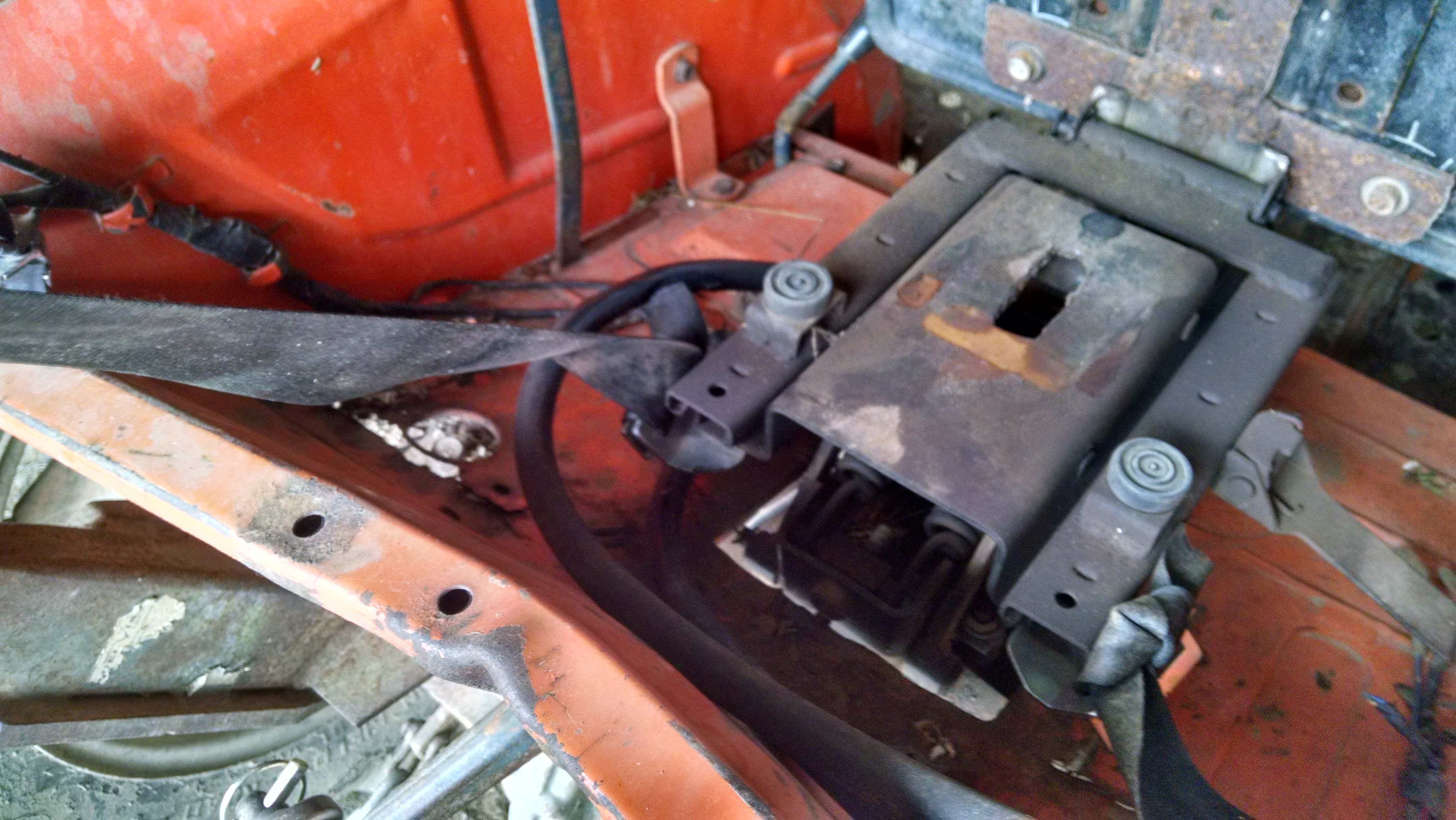

On my L2550 I have a factory rear and it is connected to the valving below the seat and the control is on the right fender. It was never used by the previous owner I assume as the hoses were connected backward to the tractor side when I got it. I will pull the schematic (if it is there) from the shop manual and send it to you by E-mail. Just PM me your address.

I just ordered my service manual yesterday. The pdf parts manual I have consists of very small pictures. I couldn't really tell where it was tapping into the system.

On my L2550 I have a factory rear and it is connected to the valving below the seat and the control is on the right fender.../QUOTE]Do you have photos of your set up???

Here's what Gregg sent me. Nate from Messicks is looking to see what is still available. If I can get the piece under the seat to tap into the Hydraulics the rest shouldn't be too difficult.
