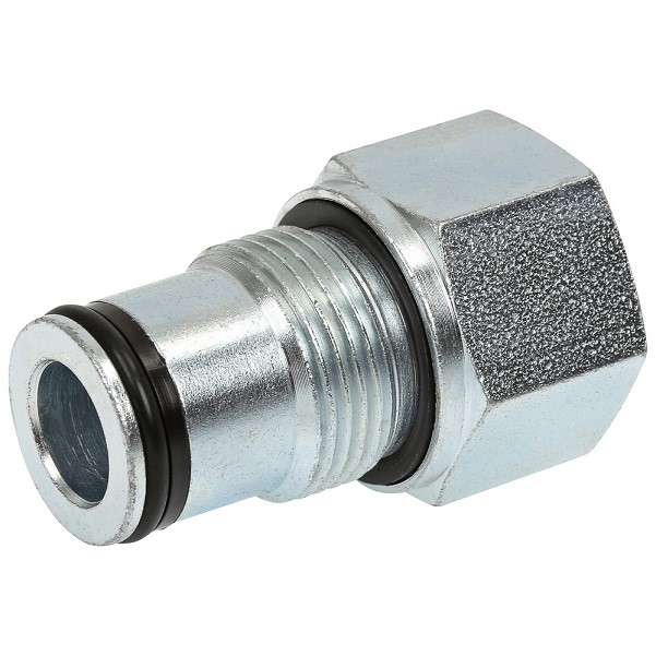

You'll want to connect the system this way: Loader valve > third function > remote valve > 3 pt hitch.
The PB line from the loader valve, goes to the P or In port of the 3rd function valve. The T line of the third function valve will go to the P port of the new remote valve. The PB port with the proper PB sleeve for the new remote valve will feed the 3 pt hitch. The T port of the remote valve must be connected to the tank/transmission housing or with Tee fitting to the Tank line of the loader valve, whatever it's easier to do.
To mount the PB sleeve in, you must take the plug on the N port first.
Hooking the system this way, will make every function work as desired.
The power beyond sleeve looks like this one in this picture (ignore the name of the picture, it's for a bigger valve):

I have the SAE 10 o-ring fittings inserted into the "N" and "T" ports with 1/2" JIC lines connected. Will these serve the same purpose as a "Power Beyond" plug?

No, it needs a power beyond fitting installed in the "N" port then one of the "T" ports needs to return to the tank (reservoir).
The purpose of the power beyond plug is to isolate the returns to tank from the high pressure fluid path.

No, because the way the PB sleeve/plug interfaces on the valve, it's how it gets the flow to downstream valves. The way you have it right now, it's bypassing internally to the tank port.

Gotcha, that's definitely my problem then...
Thanks guys, I'll get a power beyond plug installed and route it as described and report back.
