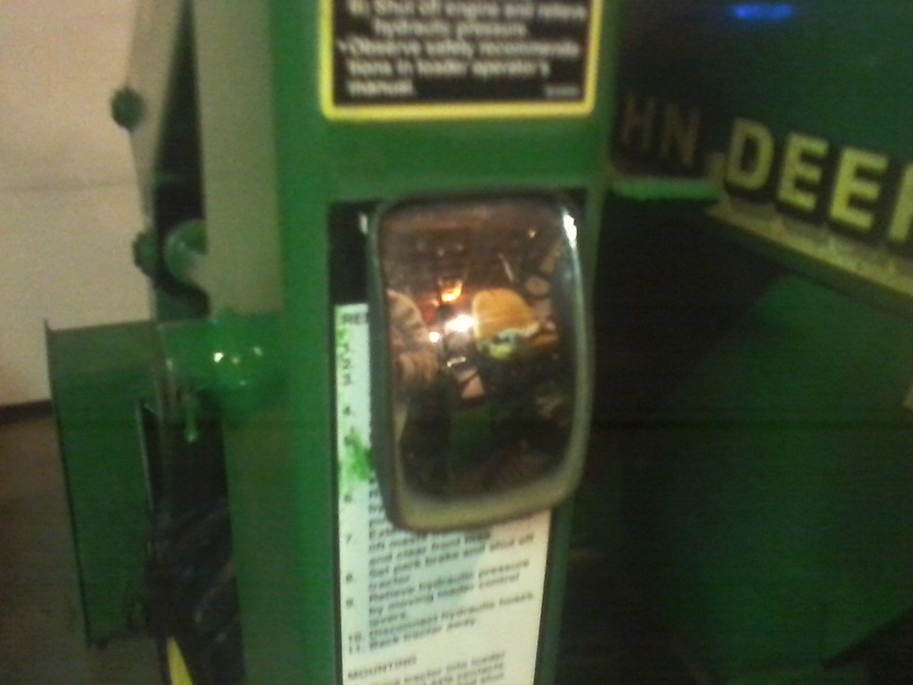

I have two lightweight rearview mirrors I purchased at an auto parts store and mounted on both sides of my tractor's loader mast frame with the sticky foam adhesive tape (its been so long really to tell you what brand tape but most likely was 3M)
This has been easily 10 years or more and my tractor has been out and uncovered in all kinds of weather. I originally posted about these years ago on this forum in some long past rearview mirror thread.
I just took a new photo and immediately realized they were also applied right over the all the OEM safety stickers too... they never came loose either! :laughing:
