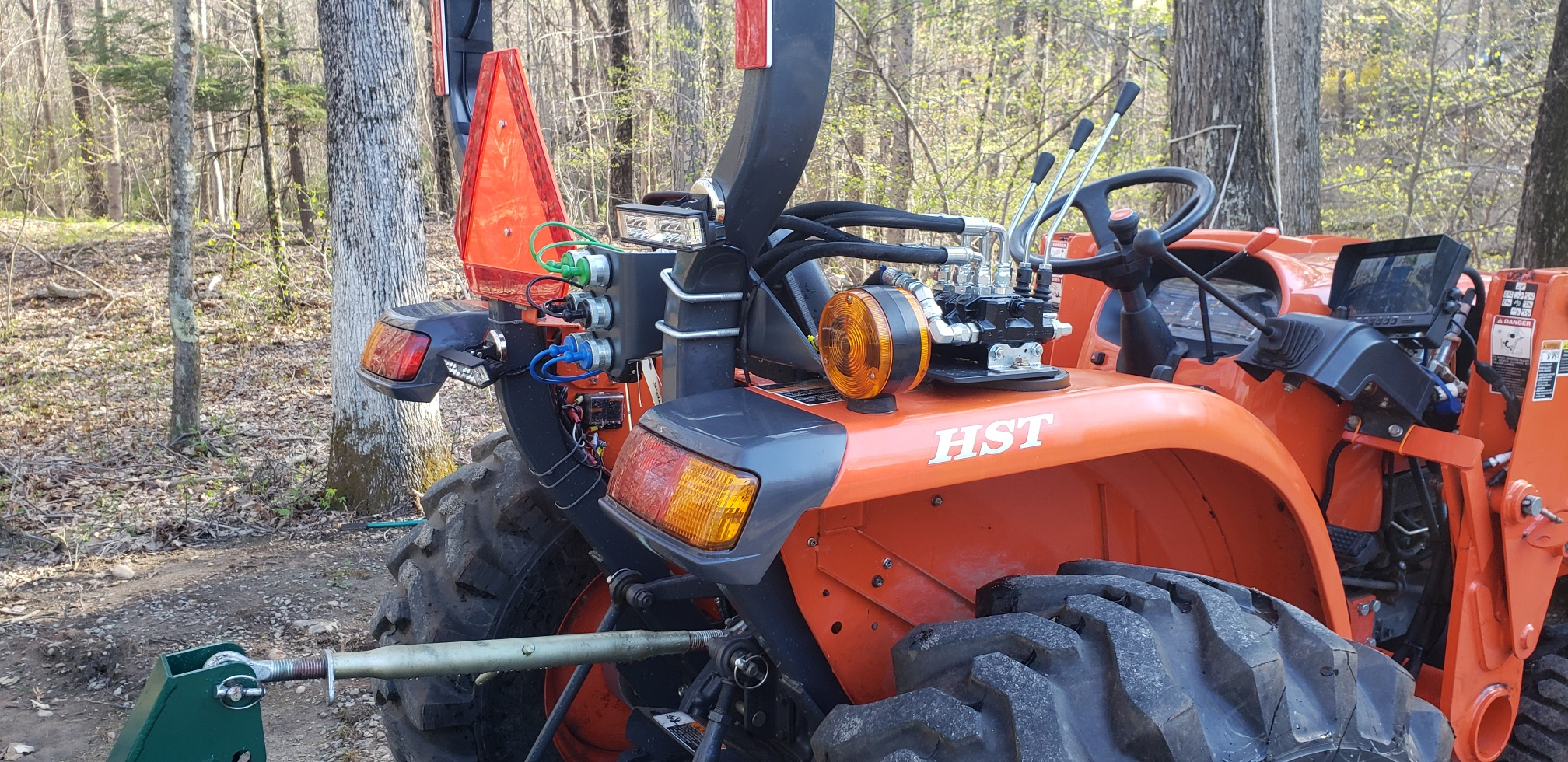

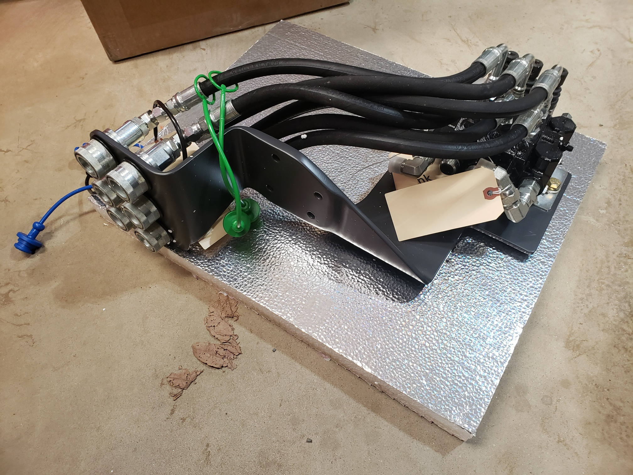

fwiw I bought a 3 valve rear remote kit from Brian at FitRite Hydraulics.
It was a complete kit including hoses. I was a total novice with hydraulics. Brian walked me through everything. It was a fantastic learning experience. Ask yourself - are those people doing that any smarter than me? If I could do it. . .
I've since moved the actuator handles horizontal.
The L3400 I used to have did use hydraulics for the Normand blower I had then. For this tractor I picked up a manual crank Blizzard that I converted to electric actuation - very easy.
btw - I'm old (76 anyway) and my name is Gerald

Thanks for the info and pictures. That looks like an awesome set-up and would be perfect for me. I'll look for the contact info and if the price is right, I'll inquire whether they ship to Canada.
BTW. I liked your side comment. I'm not as old, but sometimes feel that way. As well, my name is actually Steve and I named the tractor Gerald after my late father-in-law. It was his dream to own one, but alas, he never got the chance.
