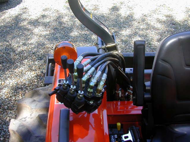

I want to add remotes to my L3130 and have a couple questions.By the way, I'm almost over the sticker shock of the parts kits from Kubota, /forums/images/graemlins/shocked.gif "WOW" Any how, what is the difference in the L8303 single spool spring to center valve and the L8304 single spool float detent valve. Does anyone have any suggestions or information that may help me. Thanks, Oh yea, I've decided if I ever buy another tractor, 30 to 45 hp will have at least one set remotes, 45 to 60 hp two sets and over that as many as my $$ will allow. They should be a standard item on new machines.

I have never found an oppourtunity to need float on any of my three valves. I'm sure someone could. Here's my valve layout. The TnT cylinders are Gannon, all 3 remotes have quick couplers (six total) It's on a L3830. Total cost was about $1300. I like my valve control setup, its very solid. Rat
