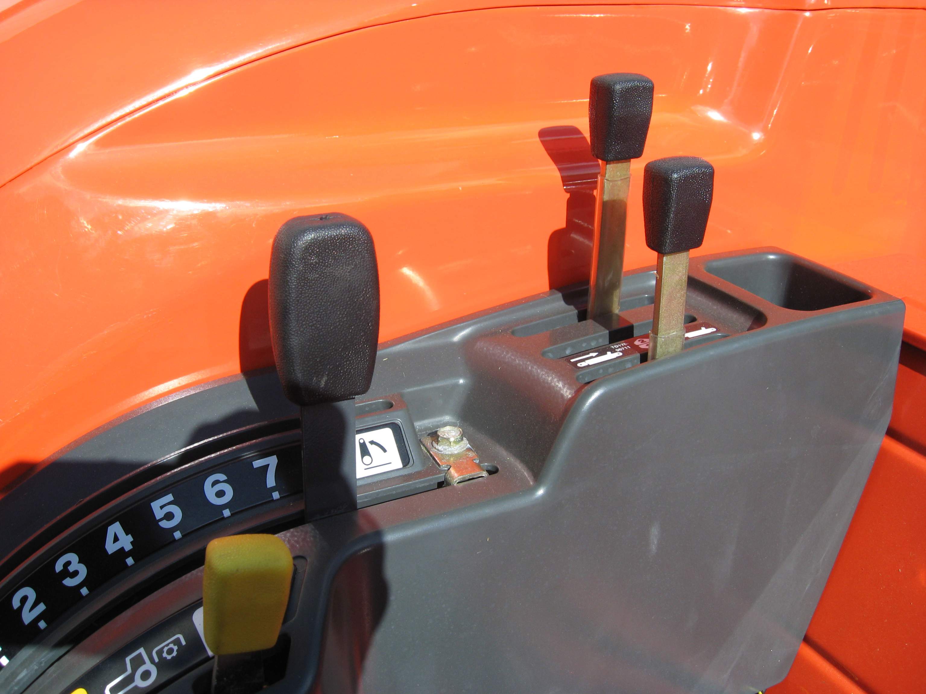

I'm preparing for a new winter project: adding remotes on my L3940HST. Working all summer with the box blade, I saw how much extra work I was doing just to adjust the box blade: tilt the box up, tilt the box down, keep it horizontal, etc. so I decided to added 2 remotes just to TnT my box blade.
The dealer quoted $1350CAD just for parts. This will include 2 floating valves with levers and couplers. Is this price okay?
Thx.
   / Adding remotes on L3940HST #2

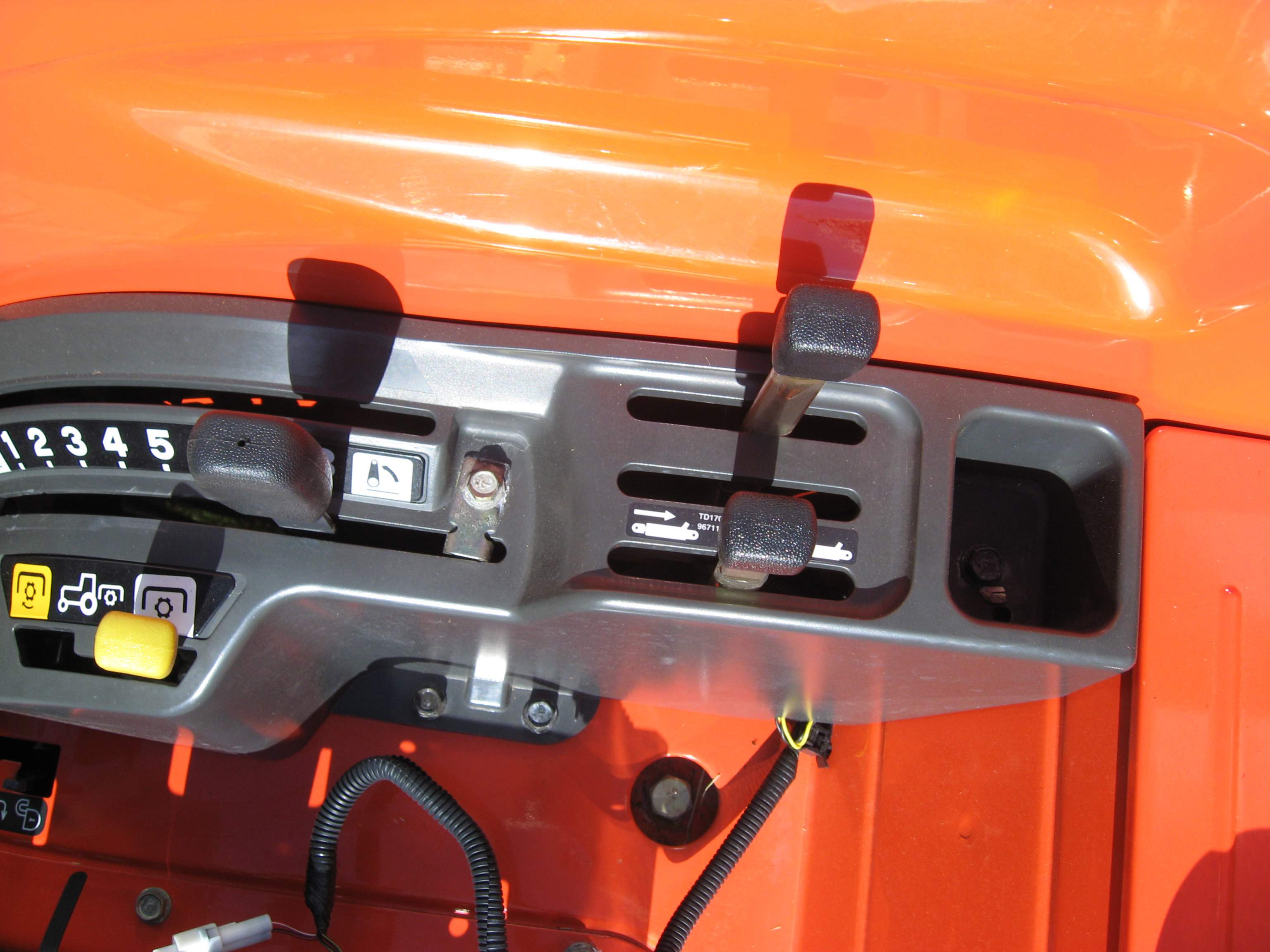

I paid $718usd for the 1st valve when I took delivery of tractor, and had the 2nd added for $426usd a few months later. Parts and labor by local Kubota dealer. I had them space the levers out so they were easier to manipulate. Philip.
Can you please confirm the valves which you have are floating style? I remember somebody here said the floating valve are little more expensive.
   / Adding remotes on L3940HST #4
1st set, L8335-20 and L8309-2. 2nd set L8336 and L8308. None of them float. Philip.
