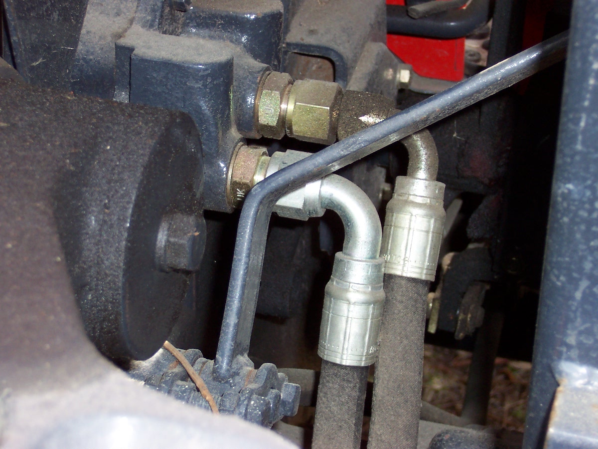

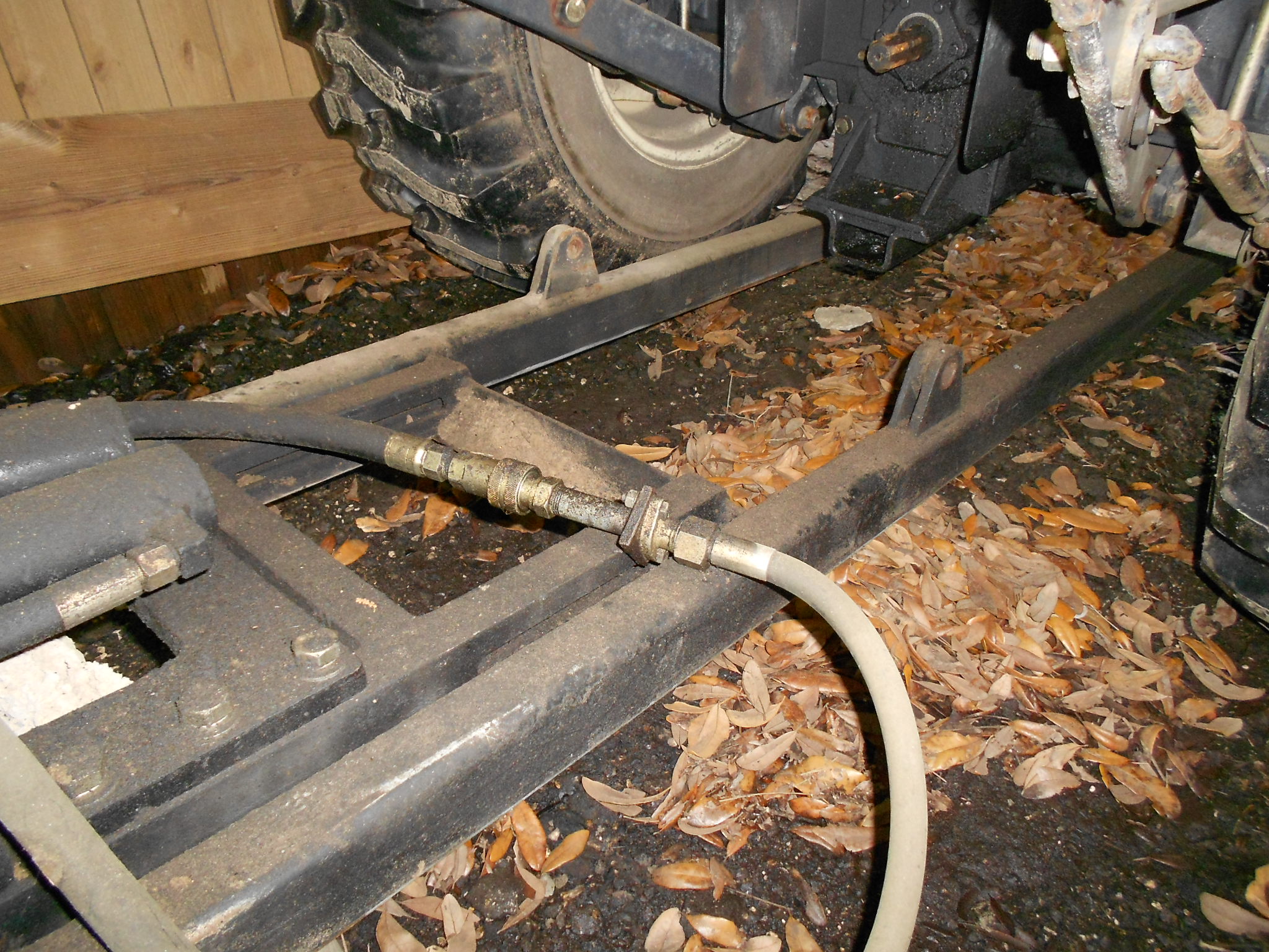

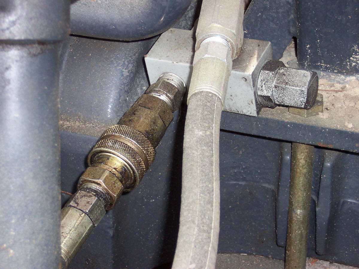

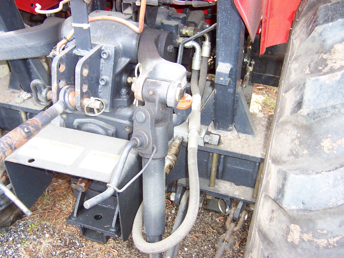

Here are pics of my 3510 remote connections.
I have a Jinma Hoe that I adapted to fit my tractor.
I put a relief valve in the circuit (the silver thingie, from Surplus Center, adjustable) to make sure I did not dead head my pump.
When not connected to the Hoe I keep the hoses plugged into each other.
